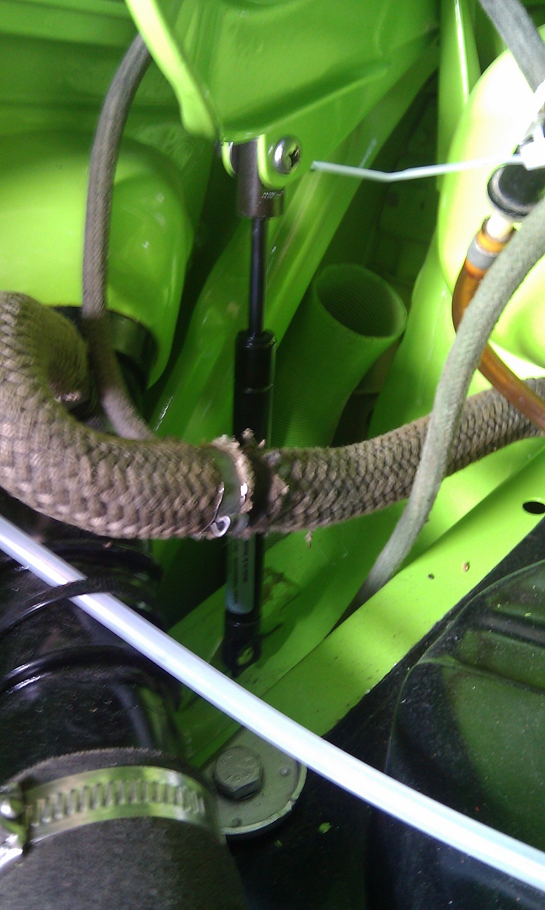

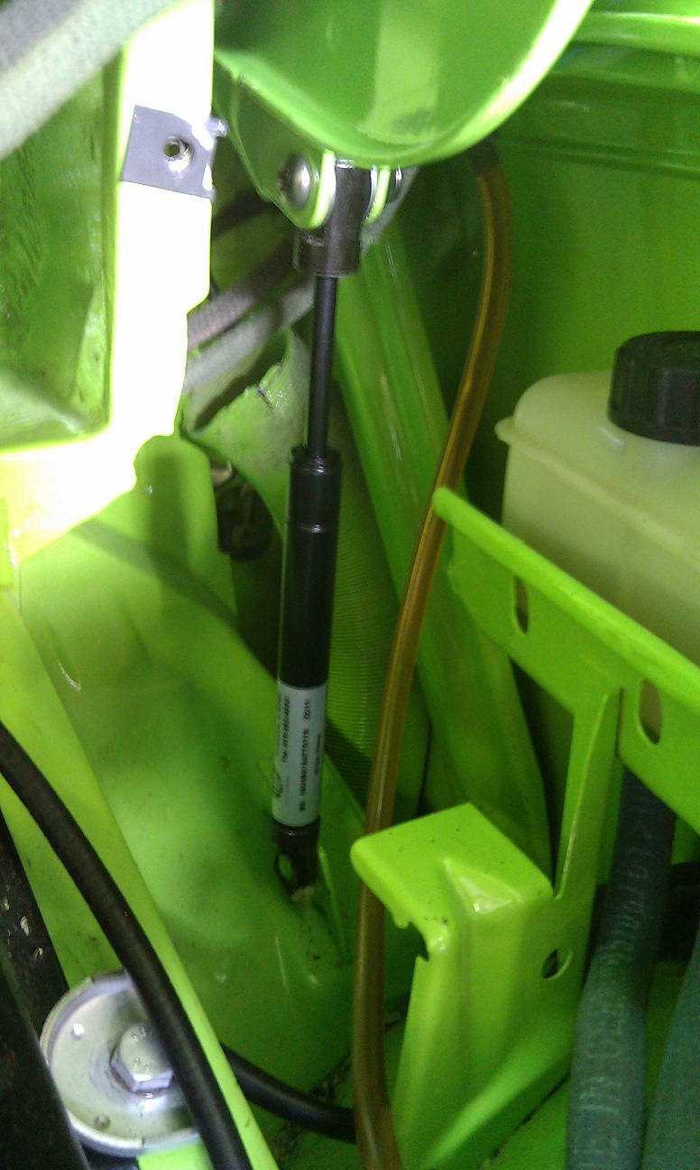

I just replaced my original hood springs with the gas srtut set up. Have a look at the pictures. Nobody offers this kit so I put a kit together. No more squeaking and it looks cleaner

I found them at a gas spring manufacturer in IA. These units have steel eye ends. The lower one is machined to fit the original lower post and use teh original lower clip. The upper has a ss bushing and two ss spacers to keep it all snug and smooth.
I am going to offer these kits for sale as soon as I get pics for the classified on The Samba and in a few other places. Becasue of teh machine work invovled a kit will cost $60 plus shipping.
