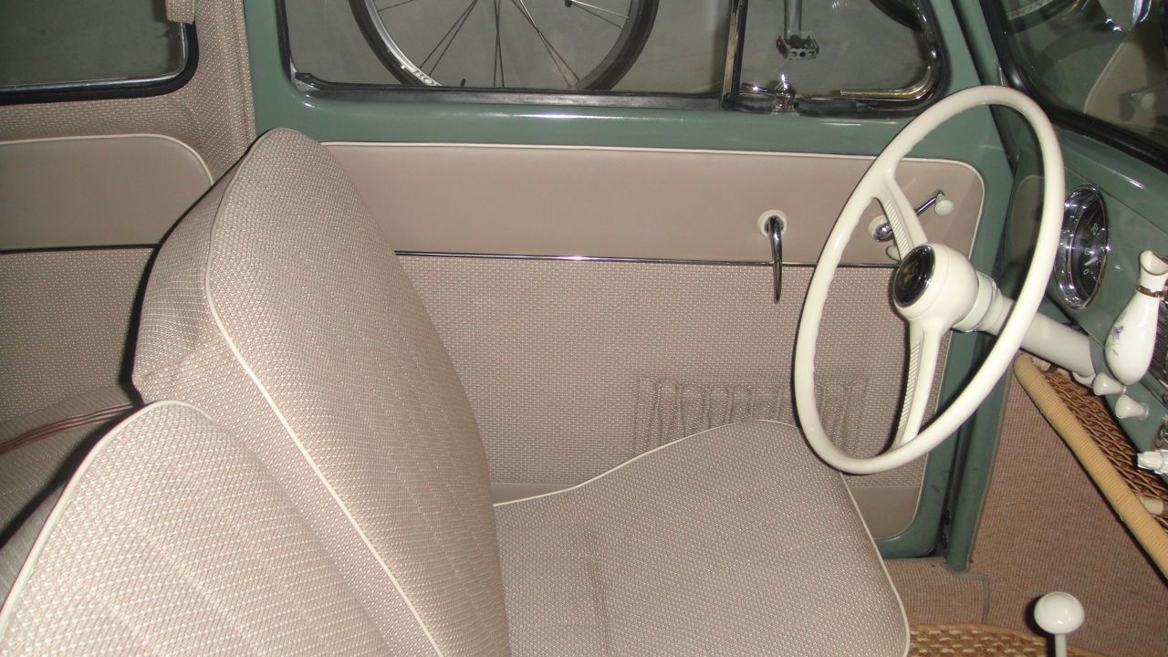

you will find restored examples like this:
but notice margaritavillain's vinyl inserts on the door panels are a light beige color...mine are a brown color.
I wish I would have known the darker color was a possibility as the lighter is too much IMHO.
