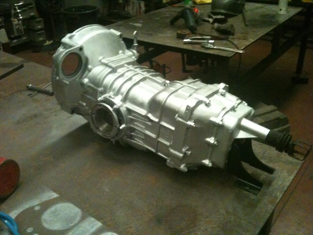

Hello. One question, as I can to mount the transmission of a bus bay windows on my 63

Saludos, si puedes montarla, pero requiere mucho trabajo, al menos mi opinion, las bay window son bastante mas anchas, el IRS va a quedarle grande, entre otras muchas cosas!
P.D: Felicitaciones por el trabajo que llevas.

Hello. Aitor it difficult to put the transmission, I have some idea in my head, but want it to be good

PostPosted: Tue Aug 23, 2011 10:48 am    Post subject: Reply with quote
Here in the samba you can find info about it, i got some IRS arms from a bay to put on my DC but they are bigger, thats why almost everybody uses a straight axle kit or a beatle IRS, and the bay doesn't have the arms that hold de transmission at front i think, im sure it will work, and looking at what you have done, you can do it, but i prefer to go an easier way. Here we have brazilian split/bay cars that have a setup really close to an IRS beatle, but shorter that the one bays have. Im doing a 60 DC now, im not as good as people here doing bodywork, but if you want to see something here is the link: http://www.facebook.com/pages/Volkswagen-DOKA-1960/100652333363858

Hi, I have the transmission and arms irs. prepared with disc brakes. I just need a spark

PostPosted: Tue Aug 23, 2011 3:58 pm    Post subject: Reply with quote
Im almost sure the trans is bigger, the bay doesn't have the suport in the back cause the engine holds the trans with the front mount. I think is better to do something like this: http://www.creative-engineering.com/index.php?page...;Itemid=26 http://www.creative-engineering.com/index.php?opti...;Itemid=26 and use a Beatle trans or find someone to convert the swin axle trans to an IRS.

Hello. are of 70-80
does not matter whether a little bigger
