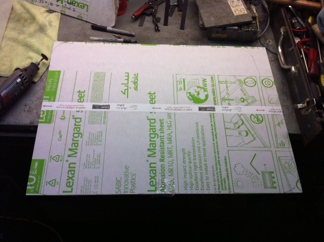

Lexan MR10 (Lexan Margard, coated Polycarbonate)
"Polycarbonate has an impact strength ten times greater than that of automotive glass. Endorsed by sanctioning bodies - Many organizations have endorsed the use of lexan mr10 polycarbonate windows for racing applications, and have made them a standard. The most valuable benefit of lexan mr10 is the enormous weight savings from factory glass, in standard applications polycarbonate can weigh 50 - 70 pounds less for a full set of windows."
PopDisplays, (MR10 distributor)
"Lexan* MR10 sheets improved Margard® II coating resists abrasion and defies graffiti to ensure a “like-new” appearance for many years to come. The next generation of UV absorbers, Margard® coating now incorporates enhanced UV absorbers to protect the sheet from the debilitating effects of sunlight. Virtually unbreakable. High light transmission common to all Lexan* sheet products. Easily maintained without marring, hazing, or yellowing. Compiles with major model building codes. Recommended by GE for use in residential vertical glazing applications. The ideal glazing for high traffic and high impact areas such as: educational institutions, psychiatric hospitals, storefronts and windows, low-level physical attack areas, entrance doors and patios, hurricane protection, railings and sound barriers. Will withstand -40° to 180° continuous and 220°F short term with no load."
USplastics.com
"Lexan Margard sheets have maximum toughness, with mar resistance approaching that of glass, and significantly improved resistance to weathering. MR-10 sheet provides extended service life. It has excellent clarity and durability, it is lightweight, and is superior glazing material for institutions, office buildings, stores, and more. It will withstand -40deg F to 270 deg F. Has a silicone hardcoat surface. It is non-formable and UV resistant. LEXAN MR10 sheet is mar- and graffiti-resistant. It combines the impact strength of LEXAN polycarbonate sheet with a proprietary abrasion and UV-resistant MARGARD® II surface. It is warranted against yellowing, breakage, coating failure and loss of light transmission and offers improved resistance to weathering and forced entry protection. It is useful for schools, store, transit shelters and other high-traffic areas."
K-mac-plastics.com
_____________________________________________________________________________________________

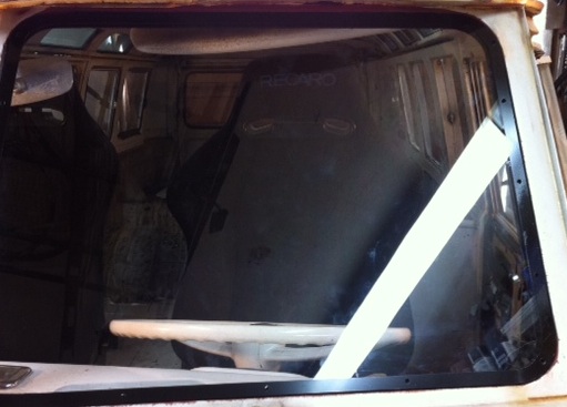

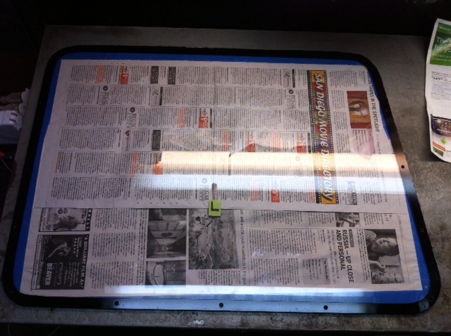

^ MR10 Margard Lexan, NOT standard lexan.

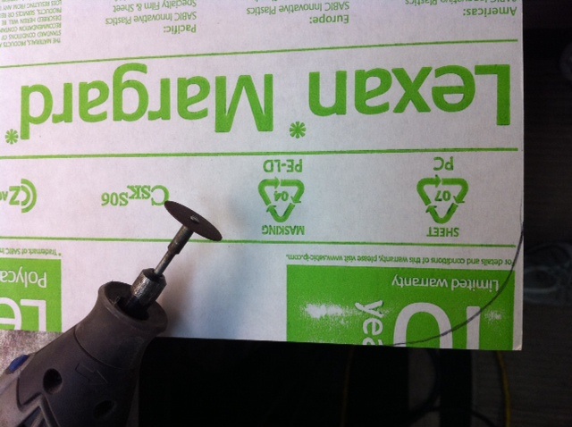

^ Easy to cut and shape.
^Extremely light, extremely strong. Both Type 2 front windshield pieces at roughly 7 lbs.
^ Complete Safari windows & hardware....roughly 25-28lbs.

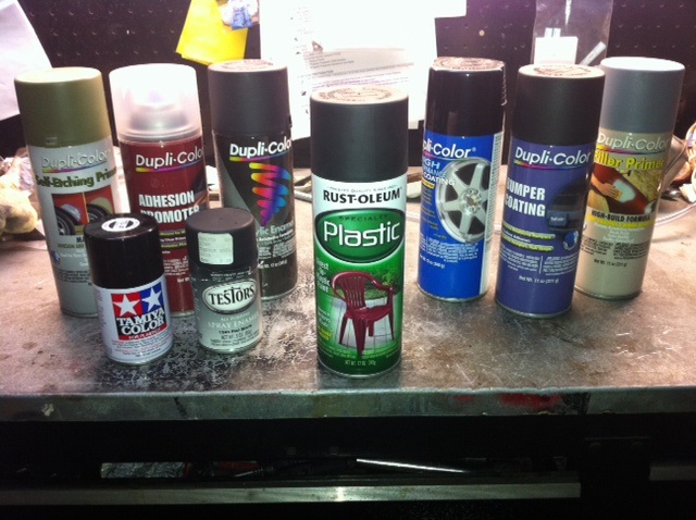

^ After testing nearly every plastic spray on the market (some paints not shown), surprisingly Rust-Oleum Plastic flat black was the best by far for creating a extremely strong holding black trim. Do NOT sand or primer.

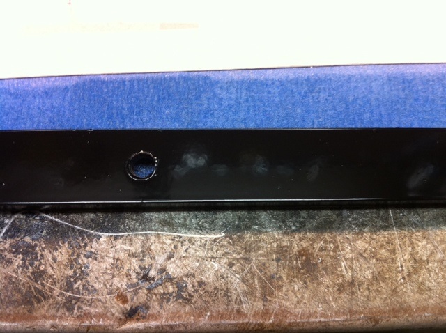

^ Prep. Always use quality 3M tape.
^ Several hours go into one window. Take your time cutting, shaping and painting. Practice on a junk piece of Lexan first. Be prepared to screw up. 3M Blue line tape used.
^ Rust-Oleum will come out beautiful if done right (some glare in pic). Trim can be painted on the inside or outside of the Lexan window, your choice.
^ Installation methods can vary. Can be used in daily driving if needed. (Illegal pretty much everywhere on public roads. Near impossible to tell it's not glass unless tapped by hand).

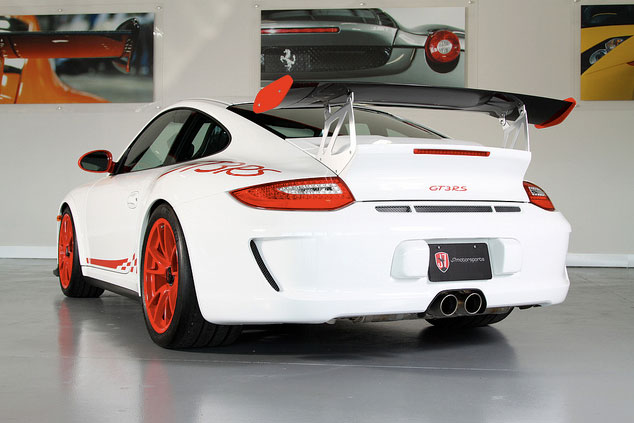

^GT3-RS comes with factory rear Polycarbonate Lexan rear window from Porsche.

Make sure you research what to clean lexan with-
It does scratch VERY easily.
