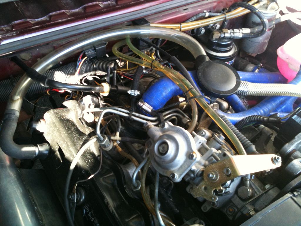

PostPosted: Tue Mar 20, 2012 2:16 pm    Post subject: Reply with quote
Engine starting to look a lot more enginey now Very Happy

PostPosted: Tue Mar 20, 2012 2:50 pm    Post subject: Reply with quote
What's the triangular plate below the exhaust manifold?

PostPosted: Tue Mar 20, 2012 3:04 pm    Post subject: Reply with quote
I've wondered that myself, thought it might be something to do with engine mount?
I'm having hydraulic mounts, so i think its the start of fabbing a bracket
