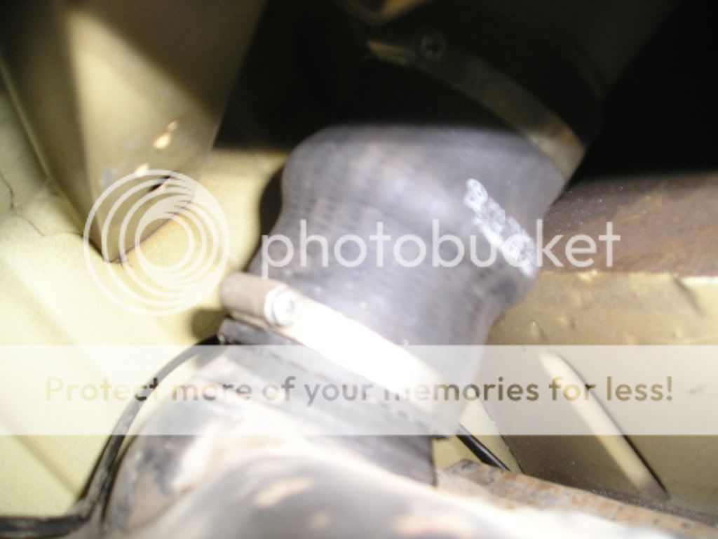

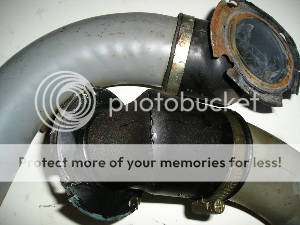

Just replaced the fuel hose and the elbow filler neck.
Some pics to show you the solution with the mercedes fuel hose.
long and short fuel pipe
filler neck a little cracky after 35 years
fuel hoses in comparison. The mercedes hose is a little bit shorter but fits just fine
http://i786.photobucket.com/albums/yy150/Rotdorn/P1010066.jpg
fuel hose installed
I bought this mercedes part for 8,22 euros, a decent price I think.

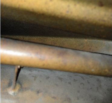

Here are pics I attempted to take by the filler door (obviously from the inside)
I am trying to see if it is leaking up by the gas door. I can't find any wetness.....Can anybody see anything???

I'm reviving this thread partly for my own interest and also to share with the class. IN 2010 Grateful German showed the use of the Mercedes part number 9014760026 which is off of a Sprinter and for him at least, fits identically to our NLA part, if not a bit better.
That said, I've had a terrible time trying to find Mercedes Commercial parts here in the US of A. Not that they can't be had. But the Mercedes folks don't seem to think their parts belong on a a different vehicle.
I finally found a Dodge Dealership in Texas who would do the part number conversion from MB to Dodge and tell me what I needed to order: Dodge part 5119668AA for a 2003 Dodge Sprinter.
I am to pick up the part on Saturday, so I'll post then how well it fits. It SHOULD fit, and if so, we've managed to find an alternative to our shrinking supply of OEM or repop parts.

Well, I got the part and it fits like a glove. The bulge in the line is designed to give the hose a great deal of flex without tearing, more than enough to deal with the tilt of the original. I also assembled all the parts outside the Bus so you can see how it goes together.
I'm going to encourage vendors to start carrying this part. I'd appreciate it if everyone else would do their little push with the vendors you know to start carrying it too.
