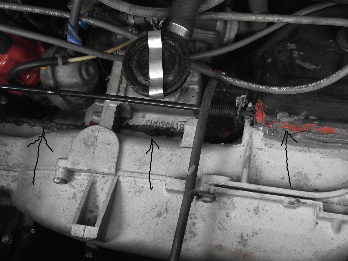

Engine tin seals
The engine tin has quite a few seals if a miss any hopefully some one will point it out. You have the spark plugs seals, oil pressure sensor seal, heater tube seal, oil filler tube seal, some misc. grommets for wires.
Heater tube:
The heater tube seal is NLA as well as the filler tub e seal and a few others. So you will have to get good at using RTV or something else to make one. This is what I did for my heater tube (luckily my oil filler seal is still good):

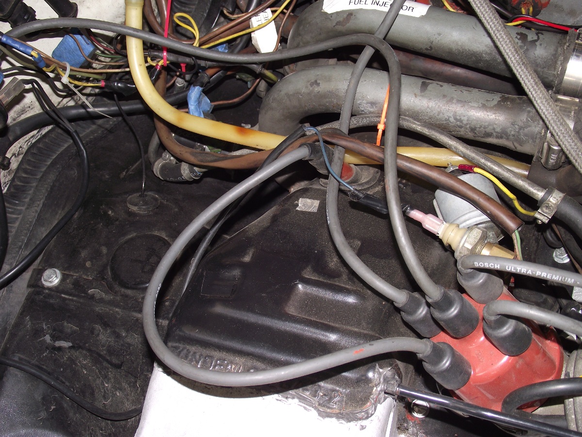

Spark plug / oil pressure sensor:
I do not have a picture of the oil sensor seal but make sure something is in place to seal the engine tin. The spark plug seals need to be moved around until you get them to seal properly..they are not the best design:
There are some holes in the tin that I have taken aluminum tape to cover and I have had to make use of grommets that work as seals for some of the hole with wire coming through in the instance shown it is the oxygen sensor wire:
There are gaps where the engine tin attaches along the fan shroud that I filled in (this may be overkill, if you do this be carefull to not get much RTV on the engine block then you are defeating the purpose by creating a hot spot on the engine block):

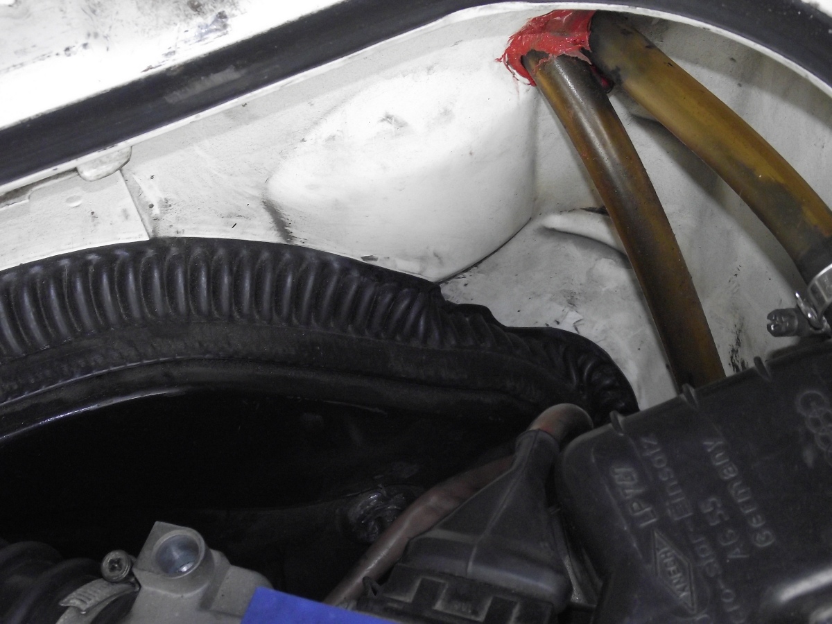

Misc holes in the engine compartment vanagon body
For holes in the body I have either found grommets if there is wiring going through or used RTV to fill it. There are some holes that have nothing going through it.

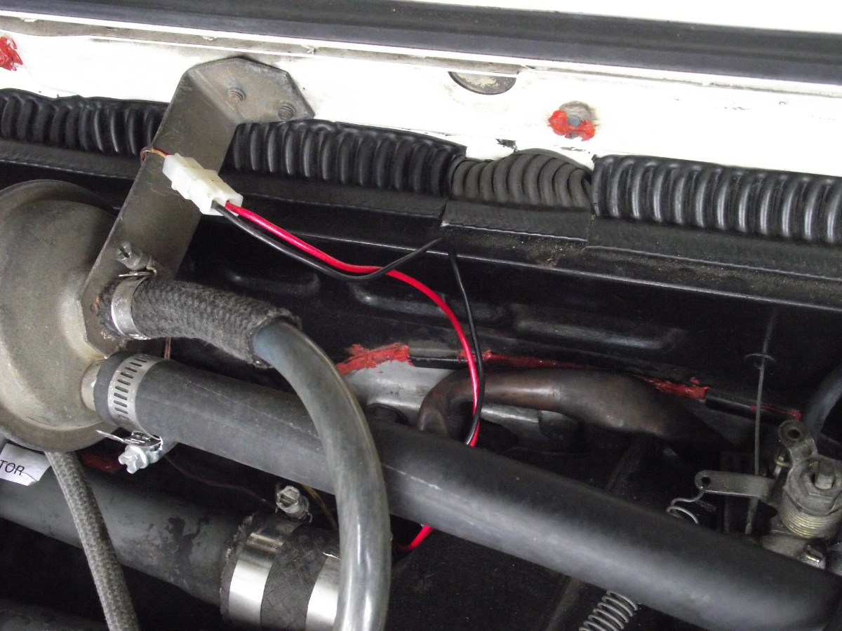

Sorry to revive a old thread, I'm just curious about the wire in this photo of yours. (see below) In the center of the firewall there's a hole in mine above the weather seal, and that red/black connector comes out of it, but mine isn't connected to anything, and I haven't figured out where it goes. (the wire on mine has the connector, and it's a brown ground, and yellow)
Thanks
