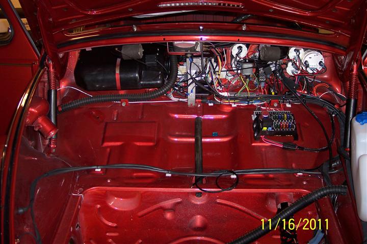

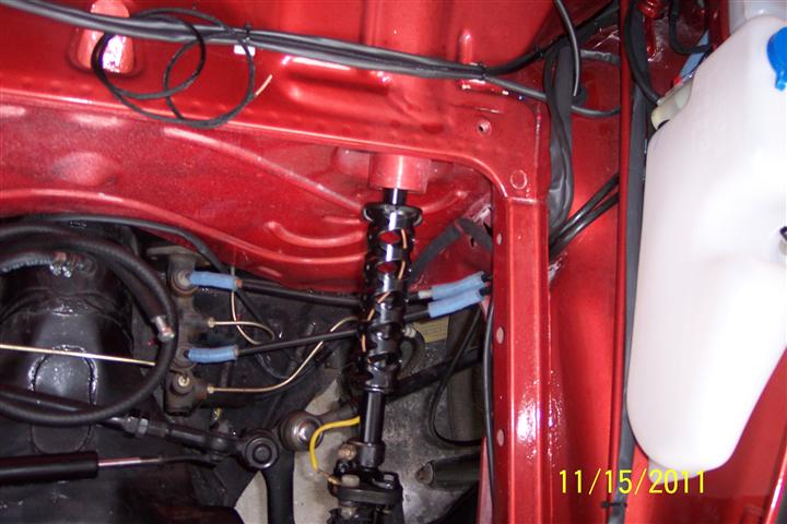

Well I just finished the install of a Watsons street works kit in my 68 bug and while it is still fresh on my mind share a few thoughts, trips, and info with those that are thinking of doing this upgrade. So here goes,
1st, this is a kit put together and built by American Autowire using there Comp 16 fuse panel for Watsons streetworks and is supposed to be a customized kit for the VW bug. I know this because I had a technical question regarding the turn signal configuration and called both watsons and American autowire. American autowire was able to answer my questions and get me going again. The schematics on AAW website are the same ones that come with the kit.
2nd, this kit is put together with an American front engine car in mind. The custom part of the kit is the very few references to switch terminals as they relate to the VW but otherwise it’s a generic kit for an American car. For example the bag that comes with the wires for the dash and instruments have connectors with wires for all the normal things but the wires are only long enough for a front engine car so you have to use the extra left over wires to run to the rear. Ended up cutting several of these and using the wire elsewhere.
3rd, the instruction are very vague about how to hook up the turn signals and hazard flashers. This took some thinking! Your old flasher relay gets chunked! Trust in the fuse box. The hazards and turns use the same flasher and are wired together internally in the fuse box (which you can't see and can't determine with an OHm meter).
4th, very good quality wire, fuse box and connectors.
5th, don’t overthink this like I did. I consider myself to be very good at electrical and wiring and sometimes think too deeply. Think American when you start wiring and follow the schematics except for the ones I have attached below for the hazard turn system and headlights.
6th, Those who have done this and said they did it in a day must have done something differently than I did. This took me a serious week to get in and look factory. I heatshrinked everything and tried to run it like factory.
7th, buy a role of 3/8, ½, and ¾ heat shrink before you start and a bag of tie wraps
8th, run all the long wires to the back of the car 1st including your extras
9 – use my schematics and save yourself some headaches, don’t forget to buy a couple of extra universal relays, one for the fuel pump and one to reverse the polarity for the turn signal indicator lamp (not mentioned anywhere on any forum!)
Theres a lot more to it but I’m not one for typing but if you have a question give me a shout and I’ll try and help out. Here are a few pictures of my install and the two schematics.
Headlight circuit schematic
Turn signal circuit schematic
Some pics of my install

PostPosted: Fri Nov 18, 2011 7:43 pm    Post subject: Reply with quote
I have it in my '73 Super as well.
I did about 1/2 of the kit (all the lights and some of the engine, no dash or charging system) and ended up throwing in the towel. A local hot rod shop who is very familiar with the AAW kits (they use them in their hotrods) were willing to take the project and finished it for me. That is literally the only thing that I had to "throw in the towel" on with my car and it still makes me mad.
With that said, now that the harness is in, I'm VERY happy with it. It is super easy to expand on, which I have done.

PostPosted: Fri Nov 18, 2011 7:47 pm    Post subject: Reply with quote
i feel your pain, I was expecting something a little more designed towards the VW. Actually a schematic specifically tailored for a VW to go along with this kit would have been great.

PostPosted: Fri Nov 18, 2011 8:09 pm    Post subject: Reply with quote
I agree!
I spent a lot of time with a '73 diagram, the AAW diagram and some hand drawn diagrams of the VW switches that I got off of here or maybe it was SuperBeetlesOnly or Germanlook.com.
I'm a technical kind of guy, a geek even, but still I was at a loss on making some of the electrical systems work!
