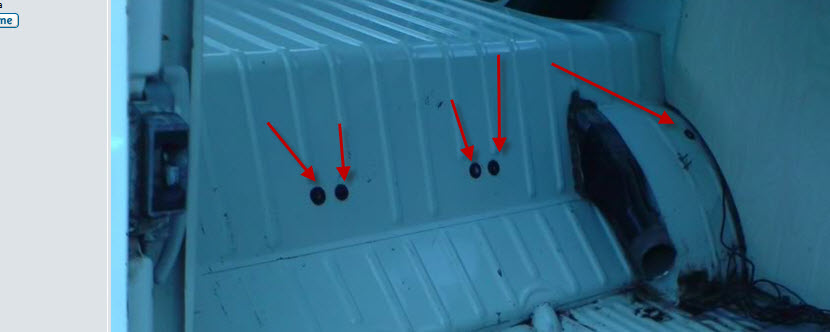

PostPosted: Sun Dec 04, 2011 4:11 pm    Post subject: Reply with quote
Anyone have some pics of what the mounting looks like when looking through the rear seat? I'd like to see what the belts attach to in this area.(not my bus). I need to add a baby seat to the back and need to add a lap belt in the middle or to one side.
My '65 Bus~Subaru EJ20 Megasquirted Turbo conversion
SGKent Premium Member
Joined: October 30, 2007
Posts: 42917
SGKent is offline
PostPosted: Sun Dec 04, 2011 4:17 pm    Post subject: Reply with quote
even with a Z-bed or delmar retro bed the seat belts still attach here

panel
Joined: December 02, 2001
Posts: 1225
Location: Victoria B.C. Canada
panel is offline
PostPosted: Sun Dec 04, 2011 5:16 pm    Post subject: Reply with quote
Thanks! I found it also here. I thought it was more complicated behind there thats all Embarassed
And here....http://paulssplit.blogspot.com/2011/08/fitting-seat-belt-anchor-points.html

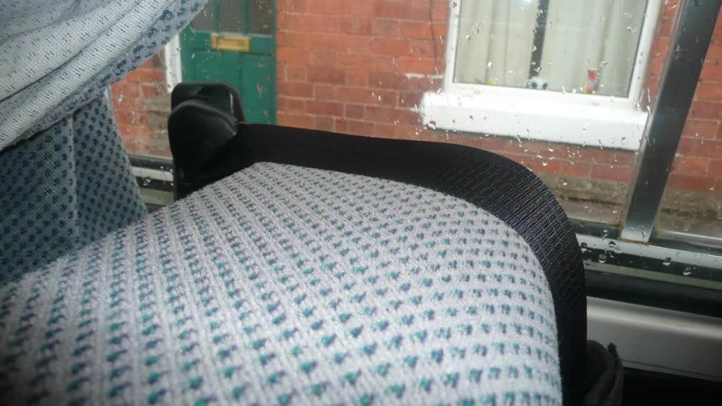

PostPosted: Sat Sep 29, 2012 8:34 am    Post subject: Rear Seat Belts Reply with quote
Rearmost seat belts, with raised shoulder-strap mountings
Regards.
Nigel A. Skeet
https://vwt2oc.co.uk
