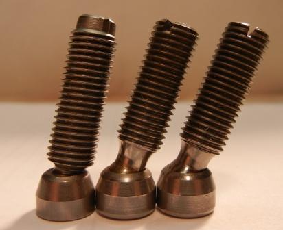

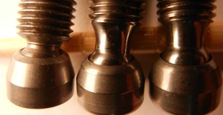

These are all 8mm adjusters. CB Performance on the left, Bugpack in the middle, and no name "p/n 109470" on the right.
You will notice quite a difference in the finish of the ball end that is inserted into the foot. The CB are quite rought, the other two are smoother with the Bugpack being the hight polished ball end. The CB ones feel rough when I swivel the feet. The Bugpack one is the smoothest, with the no name one close second. I initially bought the CB ones because they seem popular here. I thought they were a little rough but thought well...that must be how they are. I ordered a Bugpack one as a spare, just in case one of the CB ones broke far away from home. I noticed right away that the finish was a lot better than the CB units. I then decided to order a full set of Bugpack ones, but was sent the no name one because the vendor was out of stock of the Bugpack adjusters. Sad
The first photo shows the difference in range of motion of the feet. The no name appears to have a slight better range, but the foot also seems to be looser than the Bugpack unit. The Bugpack and "no name" measured 0.197" at their narrowest at the neck, while the CB were 0.18".
What does all this mean? I don't know. Confused Which ones am I going to run? I don't know...
For those of you who have used the CB units, were yours as rough as mine? Maybe I got a bad batch??? Maybe they will smooth out as they break in, but they just do not seem right, but maybe they are made of better material?

you are right. I took my stainless steel pick to the side of each foot to see if I could scratch them. The CB one is definatelly harder to scratch than the other two.

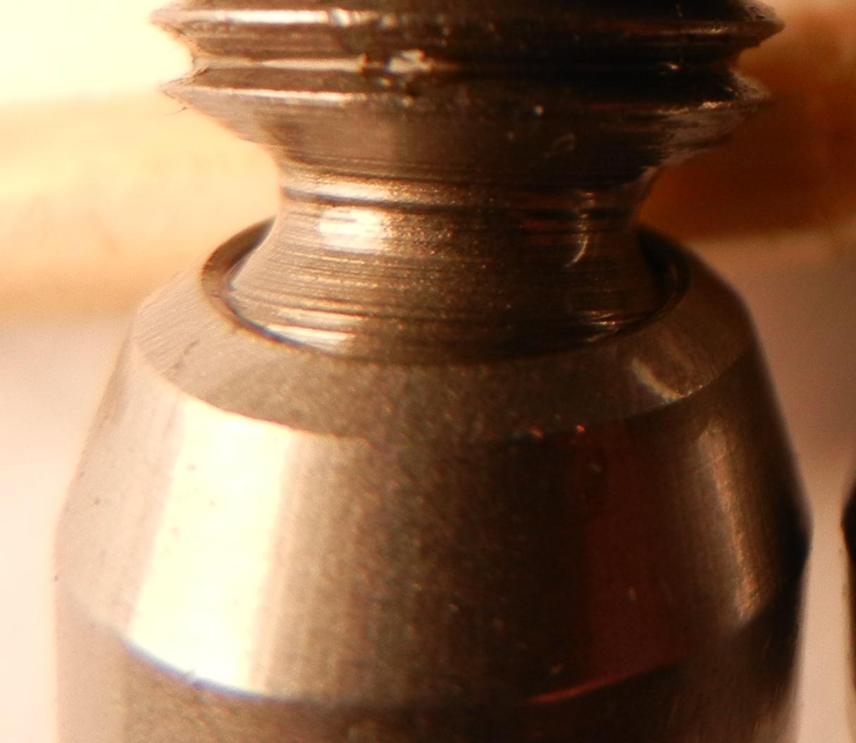

Here is an up close picture on mine. Digital cameras are just like a microscope Very Happy

i took a photo of a genuine 911 adjuster. it's a little different. in the very first photo - top of topic - the middle and right one look the same to me.

Nice Scott! That is the kind of picture what I like to see Very Happy Those are nicely machined and they are definitely different than mine. Are they Porsche or Mahle/Weiseman (which likely make them for Porsche)? I see you have the warning on your site about not using them with hydraulic lifters. I wonder if they would hold up in a WBX like the good set of well machined CB ones would. Anyone here have any experience with them in a WBX?
BTW there are very subtle differences in the two right ones in my first picture, but yes they look pretty much the same. I used a microscope and the middle one has a higher polish ans is machined a little nicer...but they may be made in the same place and from a different batch and labeled differently.

Bet the CB-Performance are the best ones in your picture. I like the way the threads go up close to the ball. I have tried some no name's they did not last long balls fall out! Now I have some scat that are pushing 25000 miles and are still fine.

I'm now thinking that the rough machining of the CB Performance adjusters might allow for oil to lubricate them more readily than a smoothly finished adjuster. As I mentioned earlier they are the hardest of the 3 brands that I have and maybe the harness compensated for the roughness and allows them to last in hydrolic lifter applications. I've read that several people and vendors say the elephant feet will not last with hydolic lifters, but the CB ones seem to work for WBXer.
The other difference is maybee the WBX has better oil flow to the rockers compared to the aircooled type 1 engine which might enable the elephant foot adjuster to get properly lubricated and be compatible with the WBXer hydro lifters.
