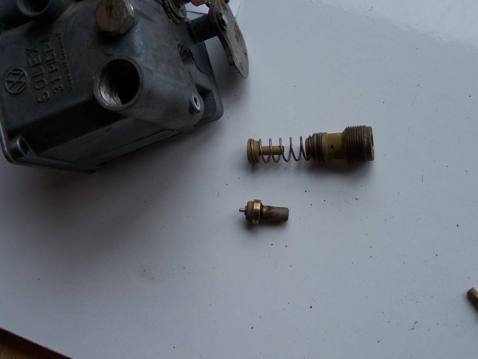

Hi,
I'm finding it hard to see what this here is for.. It's a sort of multi piece spring loaded valve that vents into the bottom of the float chamber and seems to serve no purpose at the moment from what I can see. The whole thing is sitting behind a big hex bolt, so maybe it's just blocked off from use... It's difficult to find a 31 PICT-4 diagram, unless anyone out there has one. So, anyone know what this might do?
Sit's behind the big hex bolt bottom left:
Thanks,

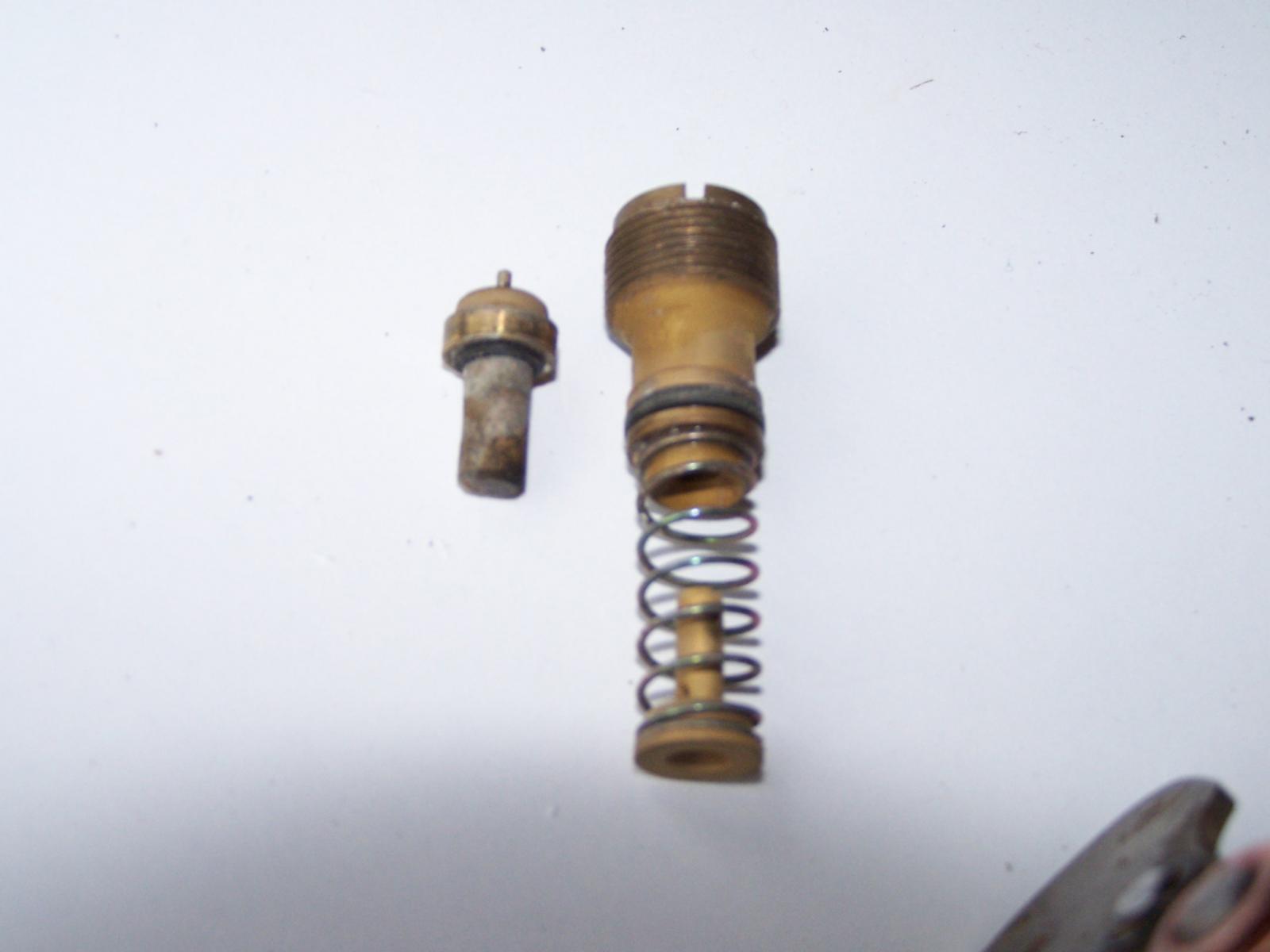

Right I did some 'research' based on your info and I think I understand how it works.
I've had the valve in the freezer and in hot water, and the stubby bit with the needle is definitely the thermo piece (actuator). The needle retracts in cold, extends in heat. Total range of pin is about 5mm. The needle seems to extend at about 20-30*C, but it's out further at about 50*C.
thermostat - stubby bit on left with needle in top
The larger assembly with the spring is the valve. This get's installed in a near fully compressed state, with one end of the non-threaded hollow shaft piece touching the thermostat needle and the other end of the shaft touching a spring-loaded-ball housed in the bigger threaded bit on the other end of the spring. The ball is pushed (opening the valve) by the hollow shaft when the thermostat needle extends as the carb body warms up.
And this is the bit that stumped me because I could not see what good it was doing to open the valve, cos it seemed to deadend in the valve chamber. I finally found by eyeing the lines of the carb and my photos, that this valve opens a channel between the bottom of the float chamber (red arrows) and the accelerator pump chamber. (the green arrows, lines, star - photos below, the blue arrow is the thermostat)
Based on the theory that this system reduces the amount of fuel squirted when the engine is warm, and that this channel is opened only when the carb is warm, I'm going to hazard a guess that some of the fuel in the accelerator pump chamber will now get squirted back up the opened channel into the float chamber, and the rest down the carb throat. When it's cold, the channel is closed and all the fuel gets squirted down the carb throat. I also suspect that the way the thermostat extends by degrees, and maybe the length of the notch on the springloaded shaft, that there may indeed be a temperature variable rate of fuel squirted down this channel.
Does that mode of operation sound right?

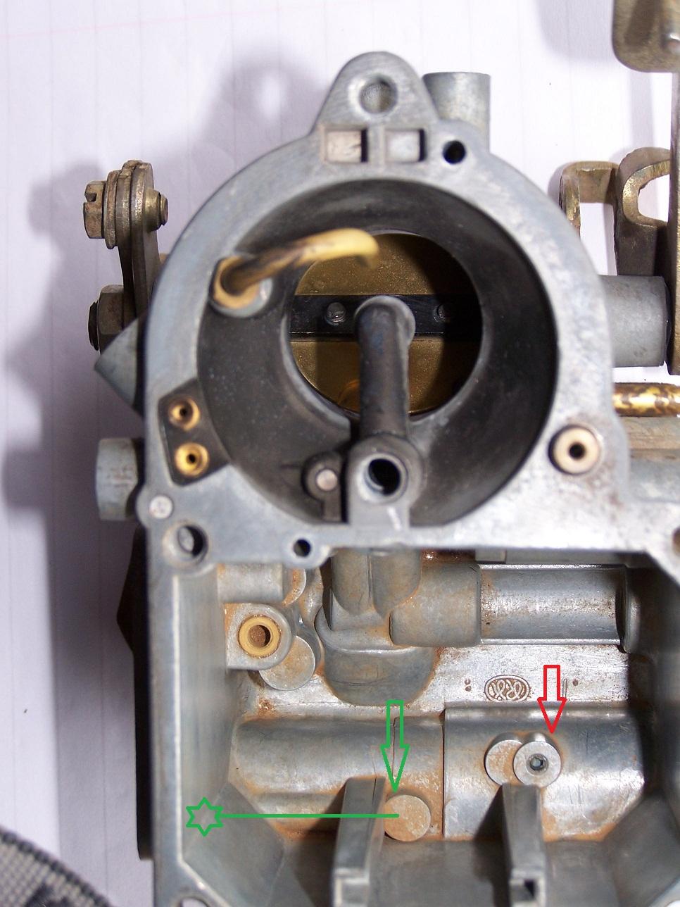

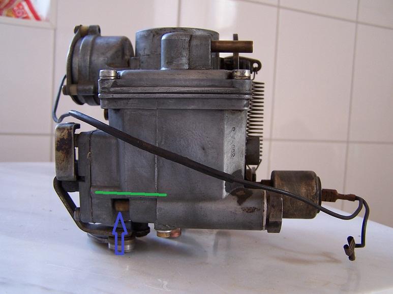

Let me add something to this.
Unfortunately I was not able to unscrew the big valve from carburetor, it is too tigh and I ruined the threading.
How to check if the whole assembly works and eliminating the doubt that the accelerator pump sprays always at its maximum?
I found this way: just at the bottom of the carb there is a small screw, circled in red in the image borrowed from Volks Wagen.
That screw if removed exposes the volume between the accelerator pump chamber and the big valve.
So the check is simple.
At first fill the carb with gasoline or other fluid less aggressive.
Then remove the little screw.
Test n.1
- no gas should drip off.
- with a termal gun or similar (not a torch) apply some warm to the thermostatic unit, following the blue arrow.
- when the thermostat is warmed enough it opens the big valve so the gas should exit from the hole, see red drops in the picture.
- The path is the red curved arrow.
Test n.2 (The other half of the channel)
- carb filled
- act on the accelerator pump
- also in this case (no matter for the temperature) some drops of gas should exit from the hole
- this indicates that the path from diaphragm pump and the hole is clear.
