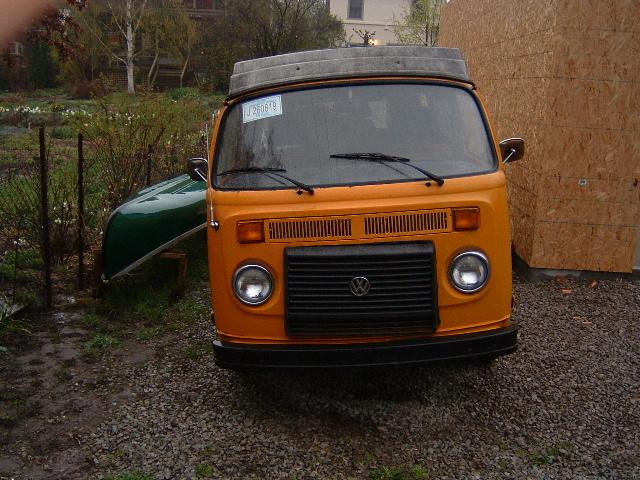

I've had my '78 Westy for nearly 11 years. I've wanted to install a TDI motor for almost 10 of those... My dad had a '96 Passat TDI which he crashed a few years ago, and I quickly snapped up. The car sat at my house for like a year and a half, and after that the engine sat in my garage for another year, waiting for these boxes to finally arrive:
You can see the heart transplant patient waiting outside.

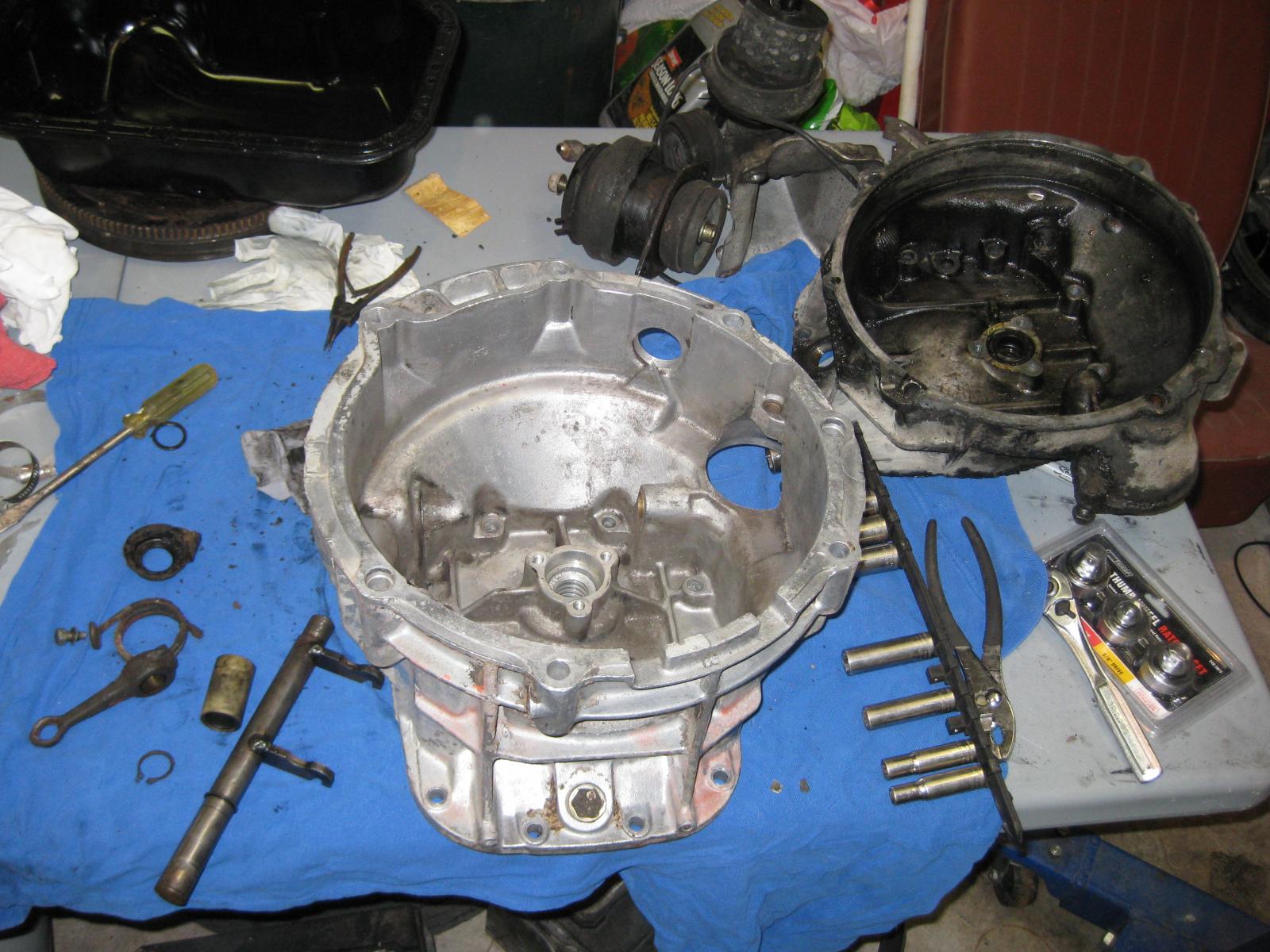

PostPosted: Sat Apr 20, 2013 8:19 am    Post subject: Reply with quote
Here is a pic of the Mexican Watercooled Bay bellhousing, taken as I was prepping it to install on the transaxle (mostly moving the clutch lever parts over from the bus bellhousing).

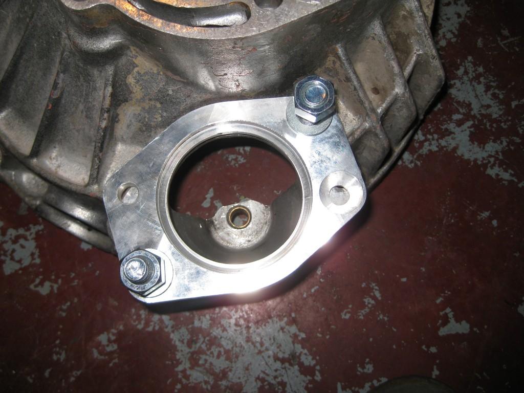

This is the starter adapter I used:
This is actually developed to mount the TDI starter on a Diesel Vanagon bellhousing, so it required a couple modifications for my purposes. I removed the studs and drilled those holes open to 1/2 inch.
I then had to cut the ear with hole visible on the left side off so that it could rotate around. I then had to order longer starter bolts. The bolts now go through the starter, adapter plate, bellhousing, engine block to the nuts and sandwich it all together.

vwwestyman wrote:
tristessa wrote:
An earlier diesel with the pump out of the block and flange on the side of the head wouldn't need the notch.
The vacuum pump is indeed on the block and not interfering.
It appears that with the engine at the right height, I could use the current coolant flange and it will fit under the seam of the fuel tank, though I don't think the fuel tank cover would fit as-is.
I've got a blockoff plate on that flange and run heater coolant from the outlet between 3 & 4 on the cylinder head in my '75, which has a counter-flow 8V gasser in it (ABA block, 1.8L head).
I had to pull the fuel tank cover for clearance even with the flange blocked and the oil pressure port plugged, but it's an earlier 002 gearbox (shorter than 091 anyway) with an adapter. The Mexican bellhousing would give more clearance for sure.
