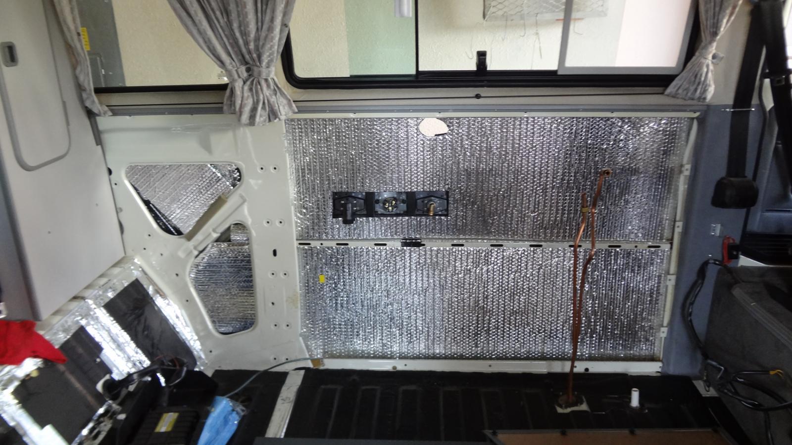

After all the nice feedback I got in the Samba I decided to get my van some sound proofing.
After all the reading online and in this forum, I chose the Second Skin product line. I bought the Second sking Factor Five Roadster kit (set me back north of $500), their wooden roller, and a can of their spray adhesive.
http://store.secondskinaudio.com/factory-five-roadster-1/
I did the rear hatch, sliding door, areas next to the rear bench seat, being the kitchen, and under the floor. I have yet to, but will, do the right rear panel (where the window washer fluid thing is), the front doors, and floor in the drivers and passenger areas. Not sure I will ever get up and under the dash (too much work).
Everywhere that there was room, I did a layer of DamplifierPro, then glues one the Luxury Liner pro, and then a layer or two of Reflectix.
On the floor I only did DamplifierPro (I was nervous about raising the floor too much and messing with how the cabinets would go back in).
All in all, I am very pleased with the result. The van is noticeably quieter. I don't have any scientific measurements. But it is very very noticeably quieter.
BEFORE
THE SECOND SKIN SHIPMENT
GETTING STARTED
MOVING ALONG
MORE AND MORE
REFLETIX BEHIND GALLEY

no need to use deadener over the entire panel
Indeed... Overkill on my part.
In my reading on this all. 90% or more of the work of sound deadening can be done with 50-75% coverage... But with more coverage there are still gains in performance, just incrementally smaller gains as you increase coverage...
I decided to just go 'all in.'
'90 Syncro Westy 2.5Subi Turbo, BFGs 215/75/15 Rheins

I understand. No use in doing a bunch of labor and not getting it done right...
"all in" will also involve a layer of MLV and then something like this next to the interior trim panel:
http://www.cascadeaudio.com/car_noise_control/VB2_Vinyl_Damping_Material_Installation.html
I did CLD then CCF then MLV then reflectix. 4 layers.
The CCF and MLV come 'melted I to one sheet' from second skin..
I only did the CLD on the floor and firewall, where I was worried the thickness would upset things.
