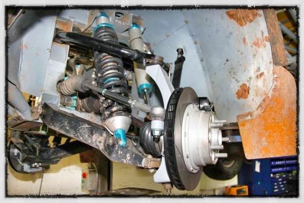

There is a monster upright on Jaeger's facebook page. Scroll through the photos until you see one of the front suspension.
I have seen the ones from his Ralley van...I want ones to match these rears.

For everybody else,

240Gordy wrote:
For everybody else,
Sweet!

Is that the custom upright Syncrodoka?
Very much so.
