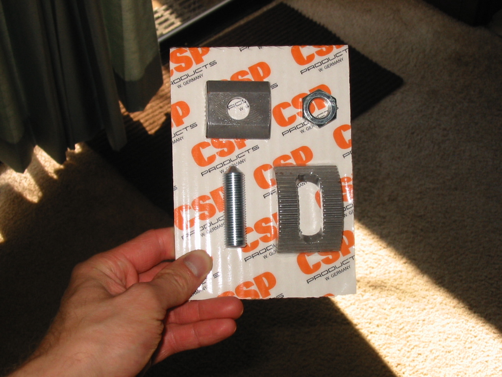

Here is everything that came with my Avis adjusters, and everything I used with the adjusters. The factory screw isn't long enough so you'll have to use the one provided with your adjuster and disregard the factory screw. There are no other screws involved, just what is shown in my first post (photo).
If you do use the Avis type of adjuster, make sure you keep the upper and lower plates together when welding so no weld splatter gets into the splines of your adjuster. Obviously I chose to tig weld my adjusters into place to avoid the splatter issue. Also, once you remove the factory dimple in both tubes, you'll want to slide the inner part (that holds the spring pack in place with the screw) over to the side while you drill and grind your slot. I slipped a long piece of angle into each tube with some grease on the inner part of the angle iron so that the metal shavings would be captured while drilling/grinding, but I also used the angle to force that inner piece (inside the tube) over so it wasn't in the way.
Tack welding the serrated adjuster plate in place is good for checking fit up, but make sure you get good penetration so the plate doesn't come off later! I trust that you're fully competent in this area since you have a shop, but I just wanted to bring it up for other's who might read this and think that tack welds are sufficient for securing adjusters into place.

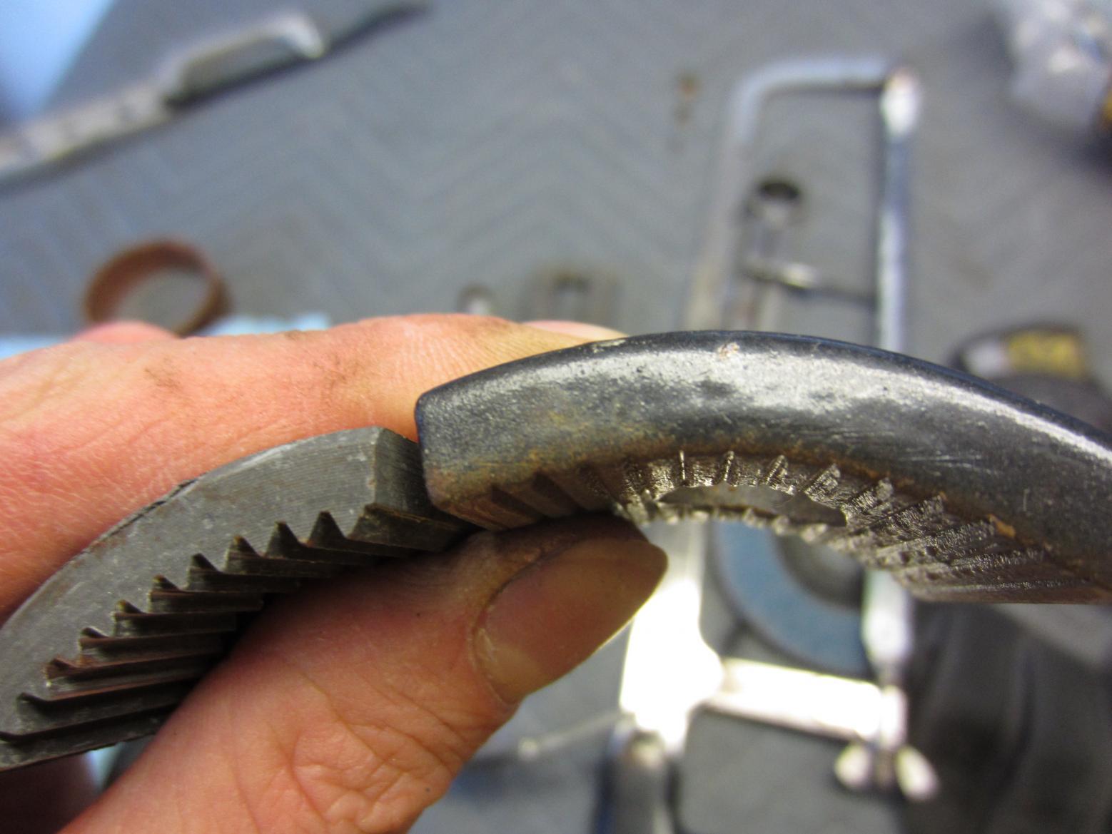

Also, MAKE SURE YOUR ADJUSTER PLATES HAVE GOOD TEETH ON THEM! Shown below is the difference between CSP adjusters with the really good teeth machined into them, and the CB Puma adjuster plate that came welded to my brand new B/J beam....This beam has never even been driven on and is BRAND NEW, yet the teeth are nearly missing due to the lack of machining! I never understood why people complained about their adjusters "stripping out" until I noticed this! You can see why I cut those garbage adjusters off the new beam and welded my own on.
