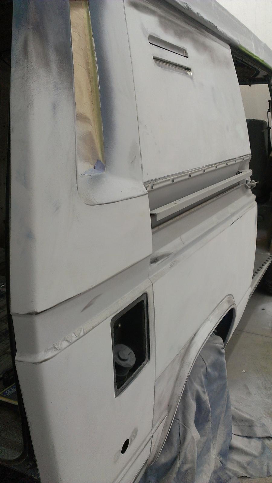

I did something similar to the rear side windows. We cut beyond the window rubber flange so it looked OEM.
