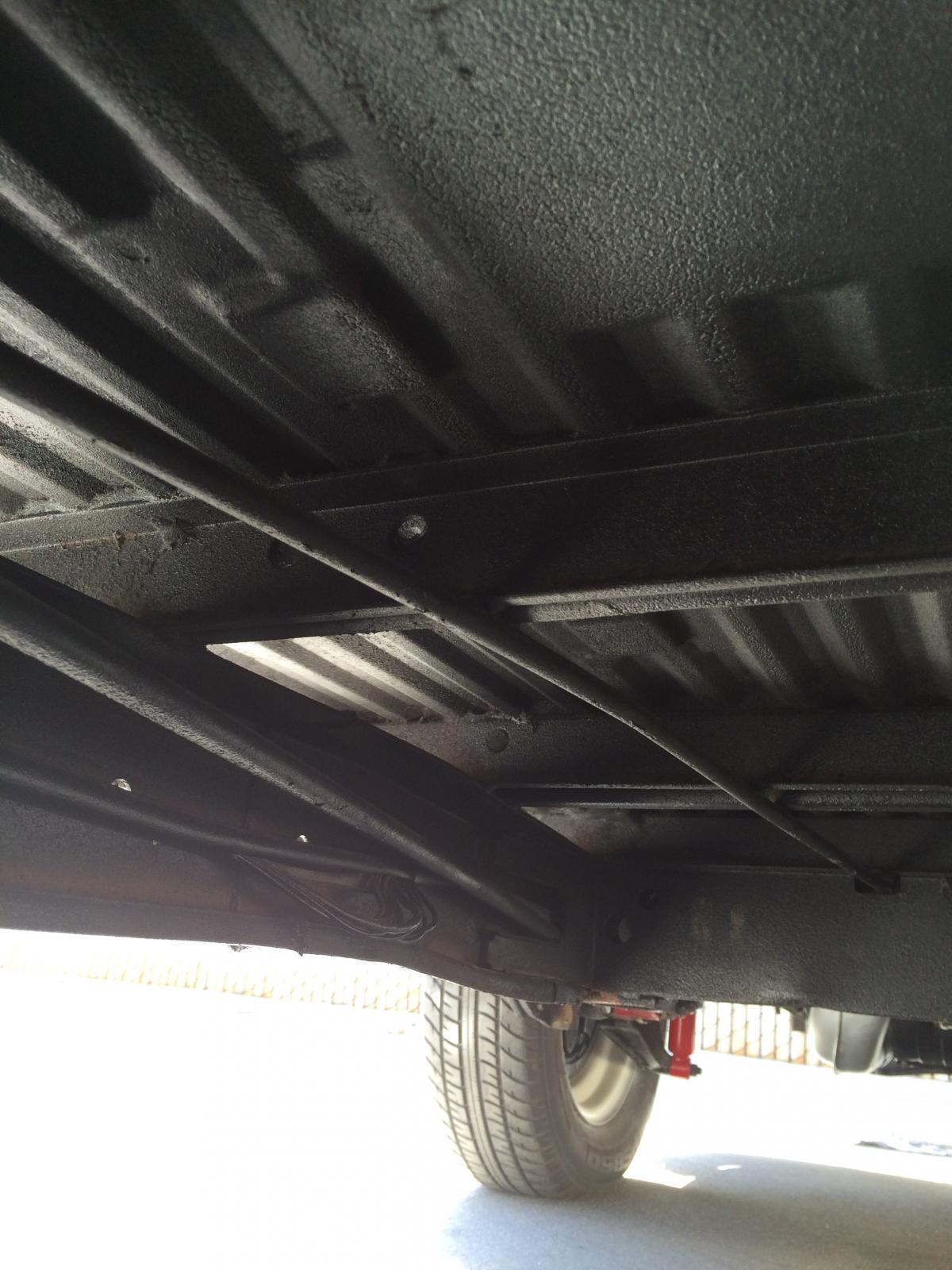

I have to say, your metal work was poor at best. leaving holes etc in the rockers is pretty bad....
again, not knowing both sides, I would say for what it was, it was an "ok" bus, however some of that work was 100% back yard. it was more like a 15k bus in that condition....useable, but FAR from perfect, and even farther from "restored"
as I commented in that thread, TUV is tough, a lot of the shoddy work would have been deemed "ok" here in the states.

I think the pics on his (StefansBus) website speak for themselves...
That's pretty shady work right there. Far from what I would call a "8 months complete restoration." Rolling Eyes

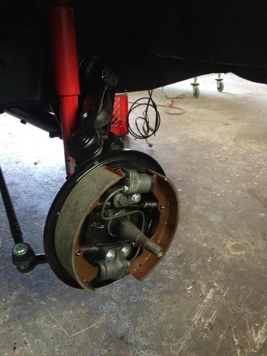

Just to give you a quick sample, you will find a picture of the brakes correctly installed. (This is just an example ). Yes our contractor has probably forgot a spacer and a washer or other things and we agreed on and on which we are unfortunately responsible but i can assure you that all this story is a complete manipulation.
This will let think about the honesty of this whole story. Therefore YOU guys are the judge.

when will you accept responsibility for the bus you sold me? Ok, you got a pic of the brake line correctly installed in one place. However, the pic I posted is NOT from that place. Have a look and compare. My pic shows the right rear top connection between the brake line (coming from the line and connecting to the hose) and yours shows the connection downstream, connecting the hose to the line....
Besides, you will have to post many more pics to prove that the bus was in good condition when it left your shop. Got pictures of the underside of the bus before you sprayed it with the black stuff all over? Didn't think so
Got pics of the brake line in the front drum correctly installed? The sway bar?

Again, your pictures don't prove anything. They are the same that are already on your website.
I never said that you did the terrible weldings. But you left them the way they were. You also left the rust holes and did not repair them.
To say that there was only surface rust on the frame has got to be a bad joke. By the way, the pictures I posted were after cleaning with dry ice. NOT sandblasting. So if you had cleaned the frame properly you would have seen the same.
My intention is not to destroy your company. It's to share my story so that others don't make the same mistake I did. If that results in a bad reputation for your business then you only have yourself to blame.
Did you take your "contractor" to court, finally?
Why are you so obsessed with the money I am prepared to spend on such a bus? That's absolutely none of your business. Many enthusiast spend a lot more on their vehicles than they are worth. Following your logic no T2 should be treated to a proper restoration. I want to use the bus as a camper, a T1 is less suited for that then a T2, which is the more modern vehicle. I want it to be reliable, safe, look good AND last. It's for all those reasons that I am prepared to spend what it takes on the bus. Since I am not planning on selling it anytime soon, it doesn't matter whether my investment will be worth it in terms of value of the car. And in the long term, I am pretty sure it will. Exceptional T2s are already 40-50k Euros here in Germany today.
You brought up the piston rings on here. I did not. The engine has been leaking quite a bit of oil on my garage floor AND it has been burning oil (blue exhaust smoke). I asked the shop that deals with the bus now to investigate. They disassembled the engine and shortly thereafter sent me an email to say all piston rings were installed upside down (which of course explains the oil being burned). I have the email, in German, and could post that here but I think the rest of the things that are wrong with the bus speak for themselves. Hey, I am sure it was a respectable company who built the motor but mistakes do happen. If that had been the only one, it wouldn't have been a problem. But here I want to focus on all the things YOU and YOUR company screwed up.
Have I even mentioned that heater cables were not hooked up, the fuel gauge was inoperative, the reverse lights did not work because the contact on the tranny switch was painted? Oh, the swivel pin kit for the steering was incomplete, resulting in steering play.
There was just sooo much wrong with the bus, it's crazy. I am sure I haven't mentioned everything yet. I will post some pictures of the inside of the bus after I removed the interior. Again, lot's of "quality" work right there.
It's sad that you say you "can't" do better then what you have already offered (thousand bucks) because what you really mean is that you don't want to to better. Which is a shame because it proves that you don't really car about your customers and their satisfaction, contrary to what you say.
How many "full restorations" have you done and sold? The scary thing is that somewhere you wrote that mine was "the best bus ever restored by vintage bus import".....

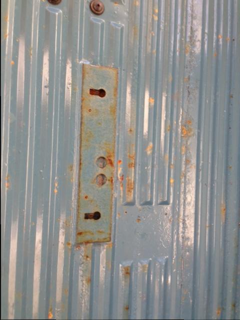

all the drill holes for the screws that hold the wood panels in place look the same.
pic speaks for itself
that's what the floor looked like after I removed the interior. This is just a few months after a "full restoration" by Laurent and the bus hasn't even been used once by me other then getting it home...
The paint on the floor is lifting. I guess it hasn't been cleaned from grease and oil properly.
