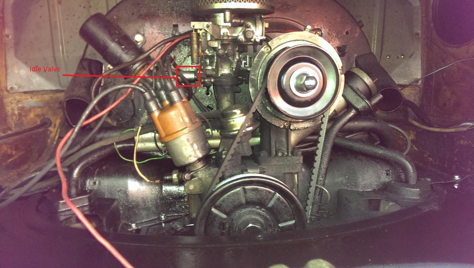

Did you check the electric idle valve on the carb? With the ignition turned on remove the wire from the idle valve then touch it back to the connection spade of the valve several times. The valve should make an audible click when you do that. If it clicks it should be good to go. if you hear no click coming from the idle valve its most likely bad. Double check the 12v power source for the idle valve to be sure. If it tests bad or has no voltage your engine won't idle. Idea
airschooled
Air-Schooled
Joined: April 04, 2012
Posts: 13474
Location: West Coast, USA
airschooled is offline
PostPosted: Wed Mar 09, 2016 1:02 am    Post subject: Re: No Idle on 1500 Single Port Reply with quote
[img]
Also check to make sure it is screwed in all the way. Snug is good, just because it has a hex section doesn't mean you need to wail on it with a wrench.

Thanks for the reminder. I have verified the Idle Cut off does function and "click" when I turn the key. Of the two carbs I have, only the 30/31 has an idle cut off on it. Currently, I am trying to run the 30 Pict-3 because I just cleaned it out last weekend. But, I eventually want to switch back to the 30/31.
As promised, here is the a picture of the engine as it was when it ran a little last night. Sorry for the low light. I can not wait until the time change so it will not be dark outside by the time I get off work!!!
