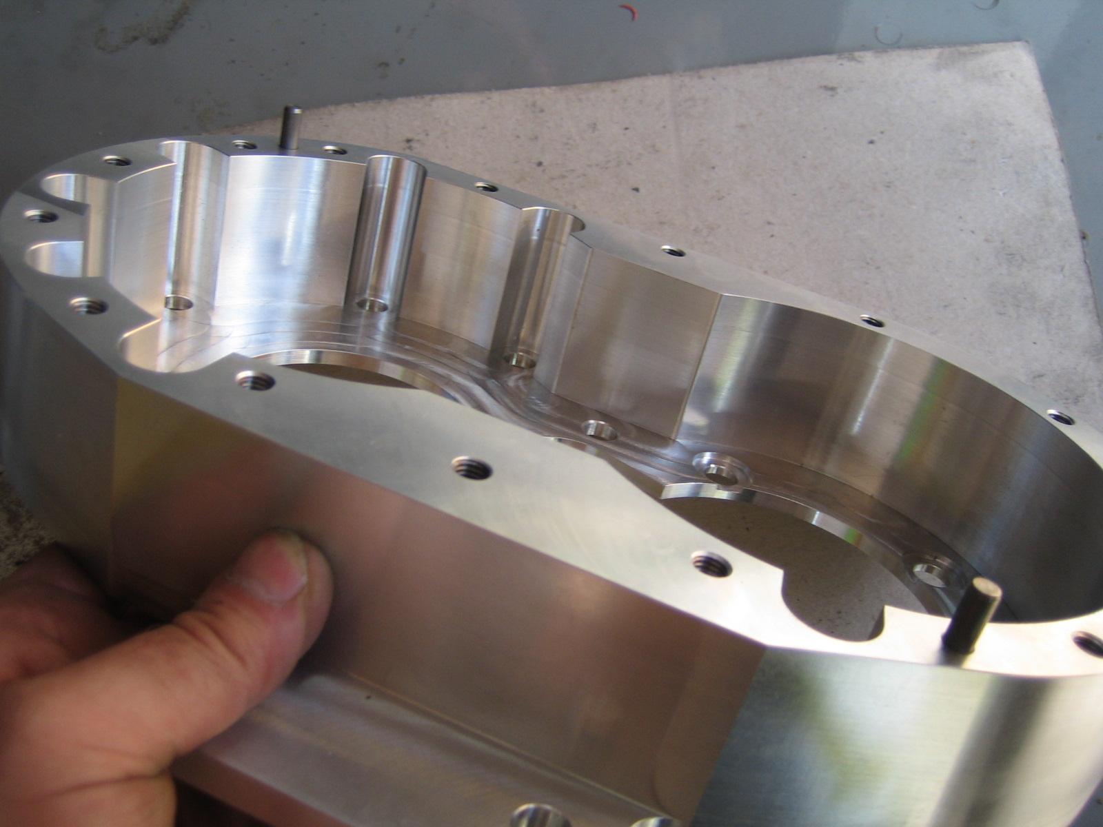

Hi Guys, because this mod never had much demand (so I didn´t sell anything)
and also because no machine shop was willing to manufacture gears for a
reasonable price, I decided to release my Audi-Tiptronic reversal set
into the public domain.
Anyone can now download the zip mentioned below, and I would be happy if
this is spread through the community.
http://www.v6bus.de/Tiptronik.zip
If any Vanagon converted to tiptronic successfully, praise me to at
least show some public domain spirit!
Financial donations also accepted
readme.txt only in german yet.
Basic info in there:
CV joint adapter works with Porsche 924 shafts on one side, needs
another 10mm spacer on the other (I hid that on the outer CV joint).
Folder 1 shows my setup: 40mm teeth on gears, lowered holes for stock
gearbox studs.
Folder 2 show new setup: 38mm teeth on gears, no lowered holes for stock
gearbox studs.
Stay tuned for Audi Brake Adapter data...maybe
Regards
Raimund

Is this a reverse ring and pinion set for the Audi Tiptronic?

Nope, this lets the ring and pinion turn backwards on a 5HP19 ZF Audi gearbox.

Ray's mod reverses the rotation at the part of the trans that directs power to the R&P.
If I had sufficient capital, I'd invest in this excellent mod. It's a perfectly valid approach to keep these German vans all VAG...instead of the direction they're currently heading with all the shillmeisters on this site.

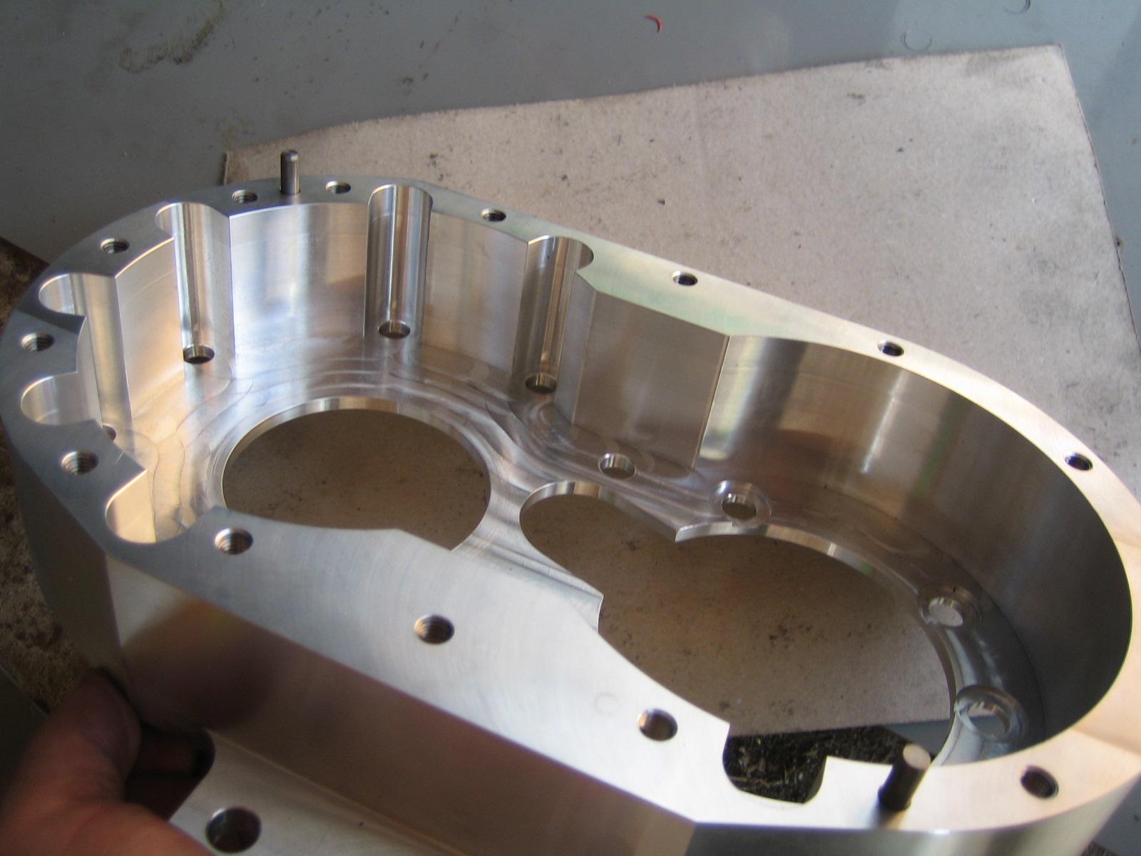

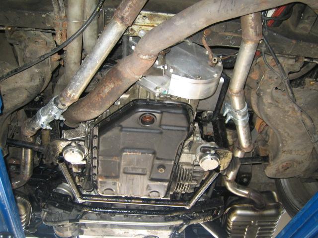

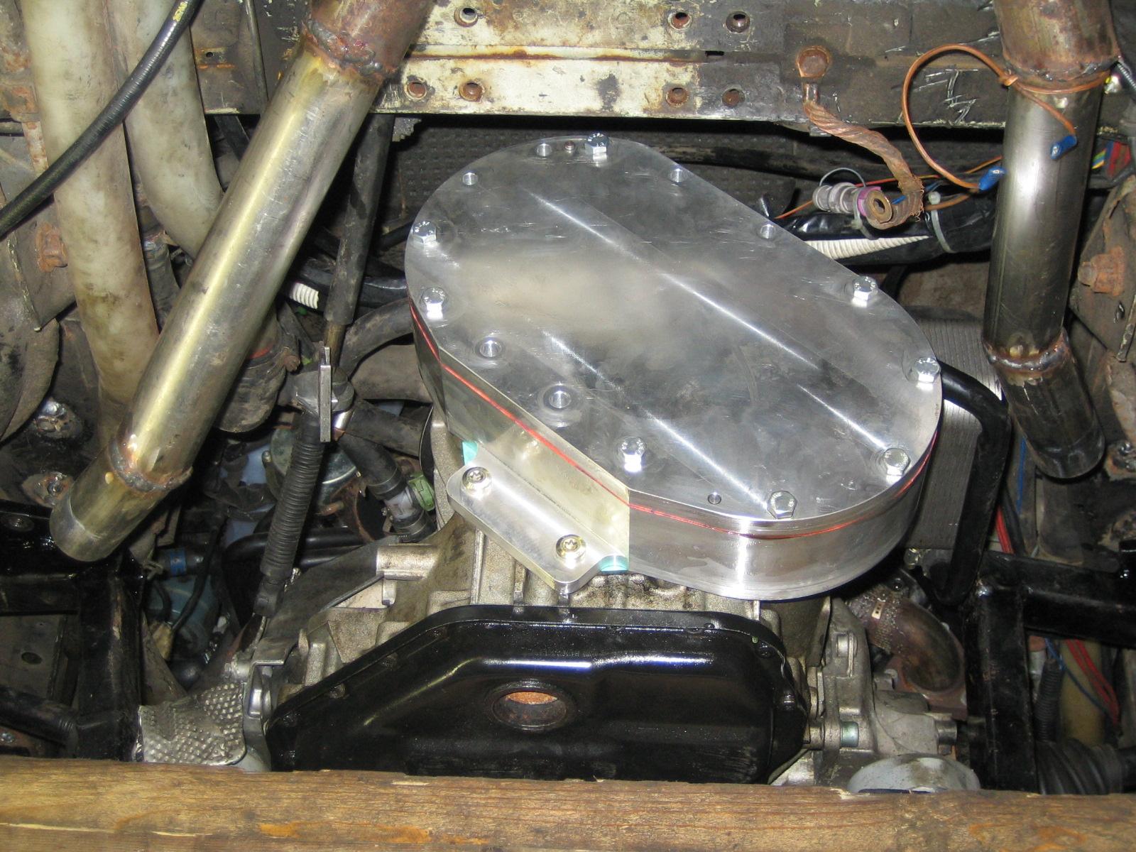

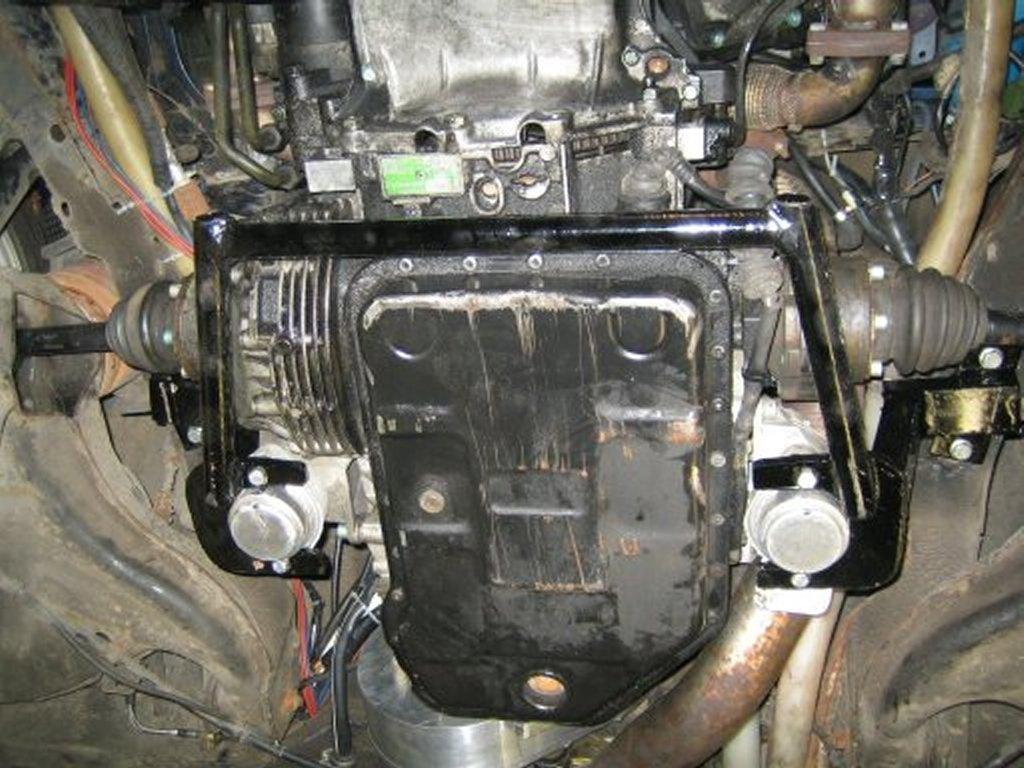

Ray_V6TDI
Joined: January 12, 2012
Posts: 24
Location: Bremen, Germany
Ray_V6TDI is offline
PostPosted: Sun Mar 20, 2016 12:54 am    Post subject: Re: Tiptronic-Modification now public Domain Reply with quote
Original Gearbox end:
My solution since 2006:
Orignal:
versus
all on the net:
www.v6bus.de

PostPosted: Sun Mar 20, 2016 3:57 am    Post subject: Re: Tiptronic-Modification now public Domain Reply with quote
Thanks for that, makes sense now, just mylimited understanding of that set up

Looks like well thought-out plan. How many miles have been put on this set-up?

I made quite exactly 50,000 km with this setup so far.
A german Vanagon friend with the identical setup made over 70,000 km, then gutted the Van and sold the powertrain... still running in another Van (current mileage unknown).

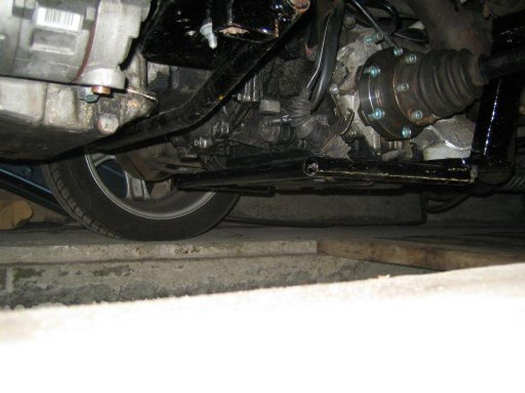

I got a few more pictures where you can see rear-engine exhaust, gearbox mounts, and engine mounts (mostly hidden behind oilpan etc), all still oily from assembly:
www.v6bus.de/neu.zip
The gearbox mounts are still on both sides, the reversal kit replaces the standard rear-end (front in Vanagon) of the box. No additional weight there, and none of the replaced housing parts are used for mounting gearbox on chassis.

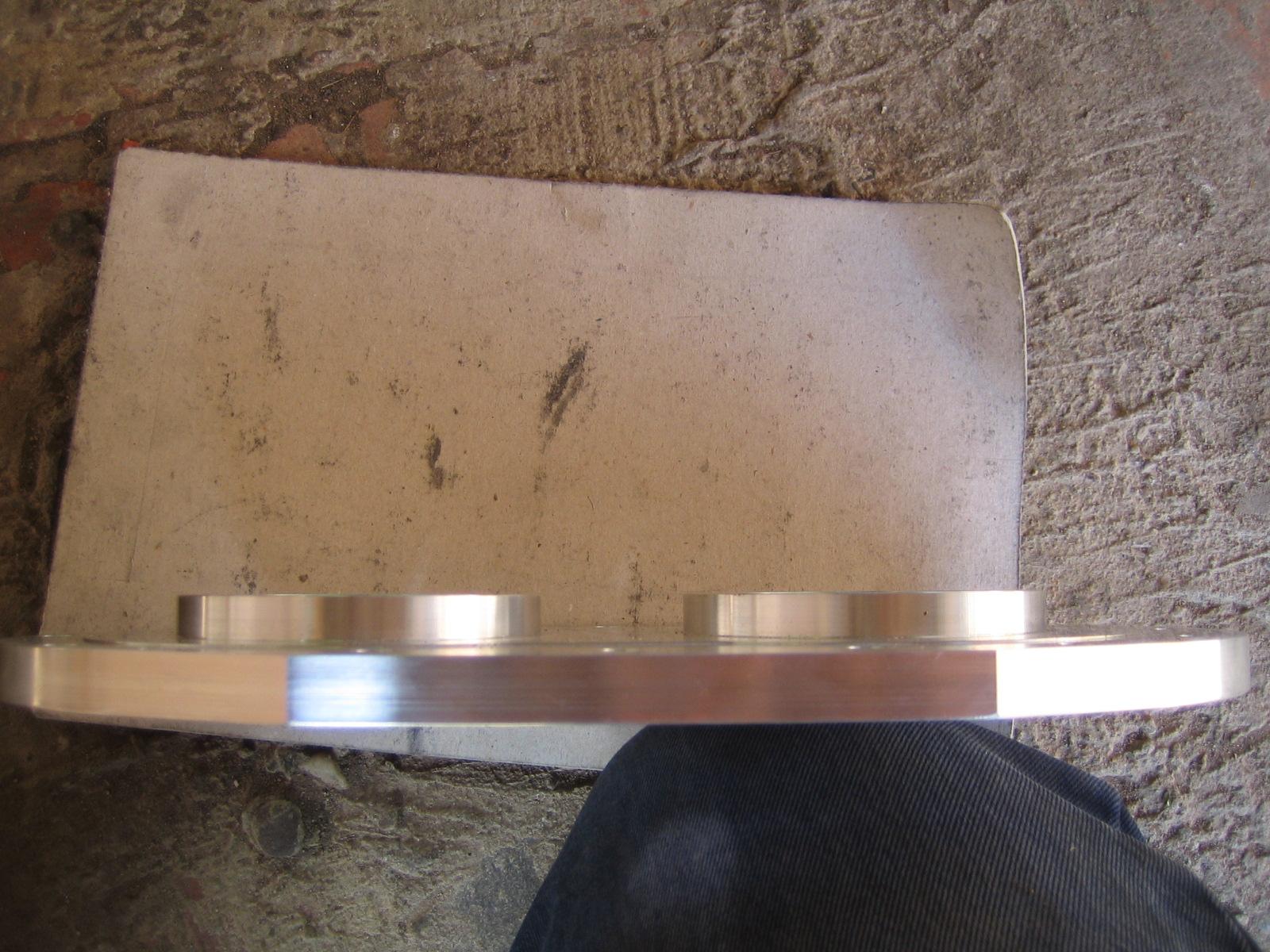

Regards
Raimund
Hi Raimund, very very very nice work!!!
Feel free to comment the pictures below.
From the zip file above:
