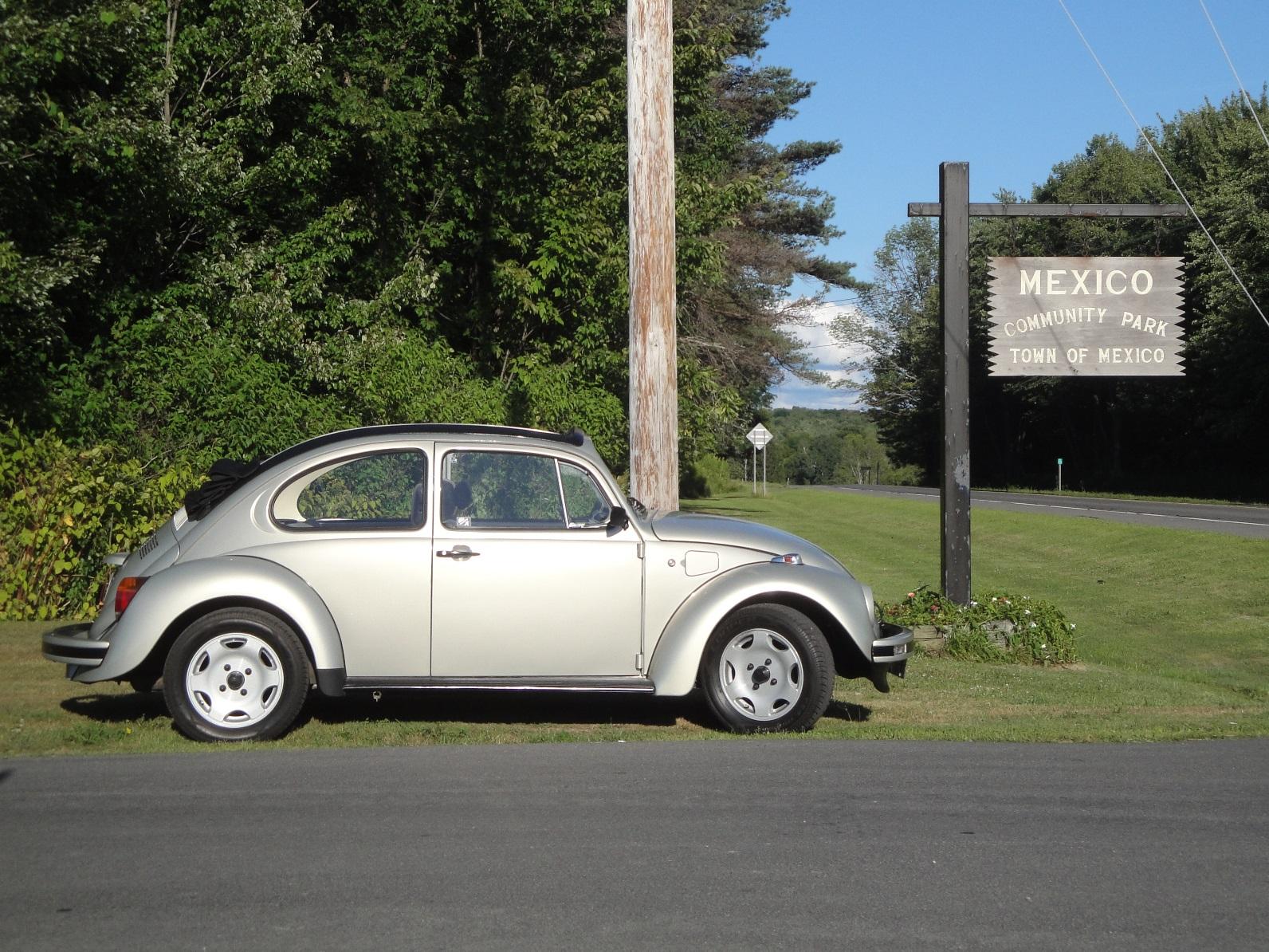

First, for anyone reading that hasn't seen a picture of an 'Open Air' Beetle, here is a few pictures of the cars, starting with one of my favorite pictures of my car:

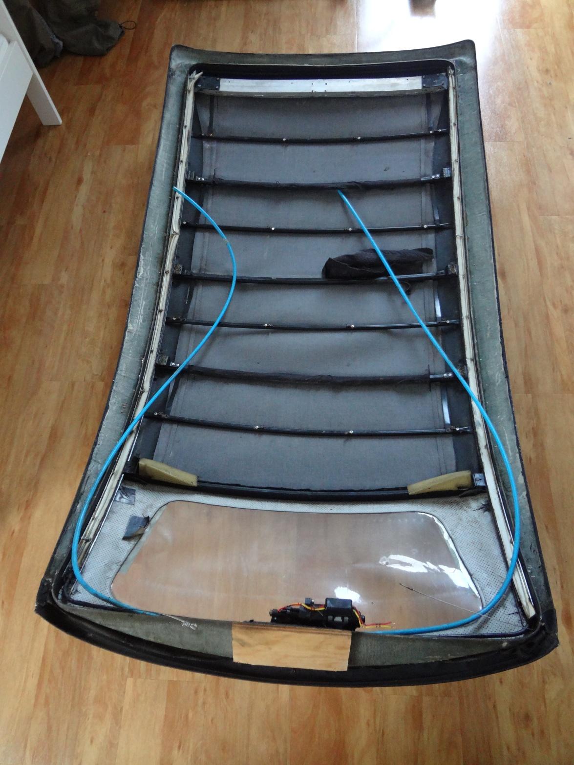

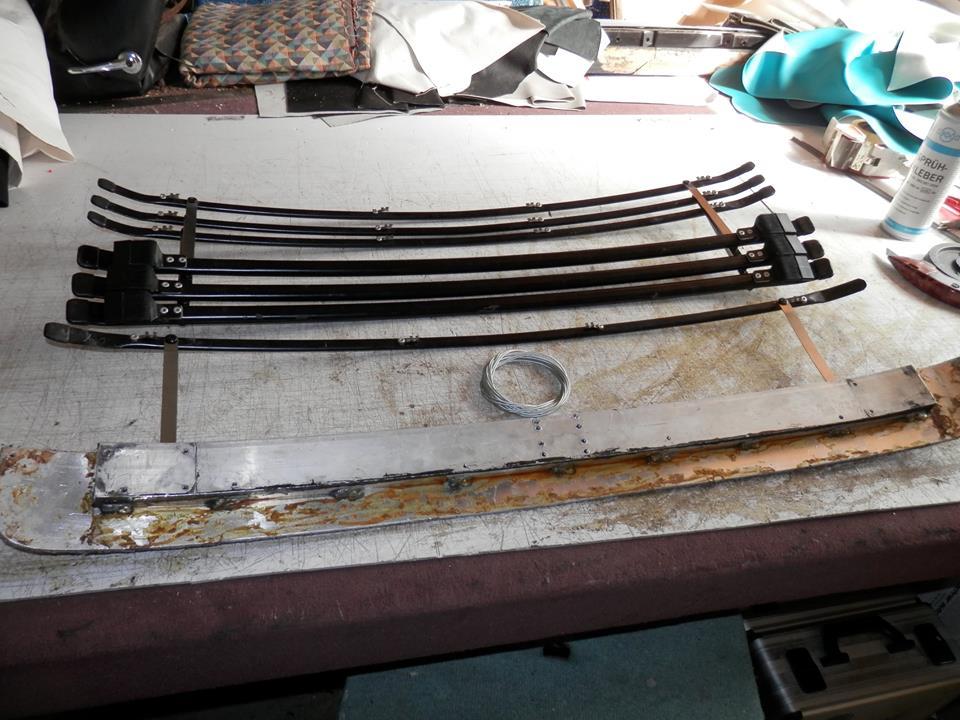

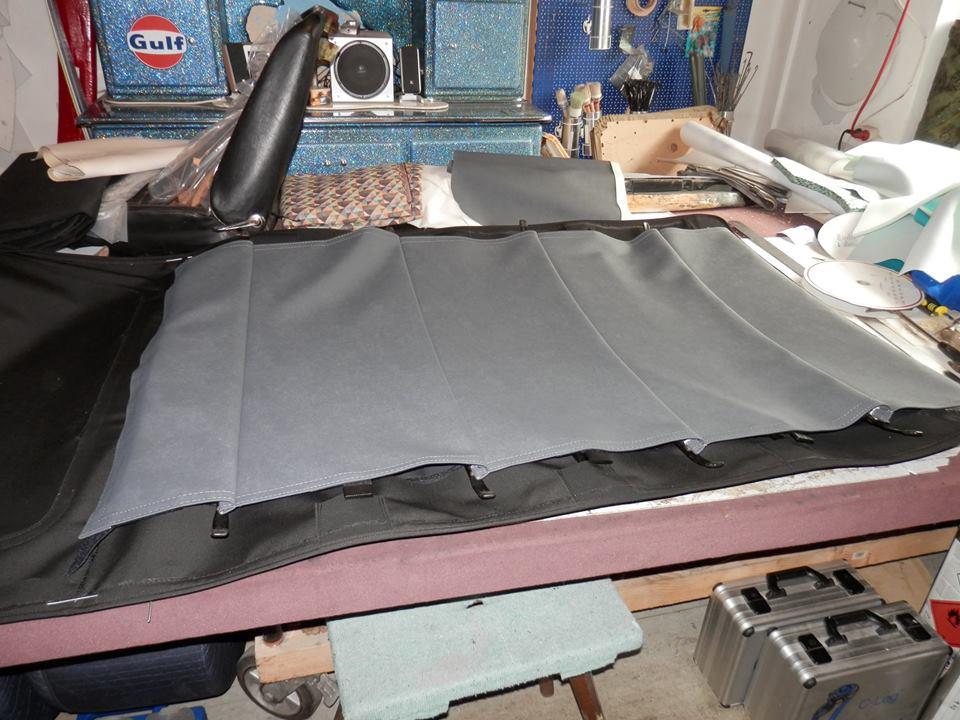

Roof
Finally some pictures of the roof in various states of disassembly.

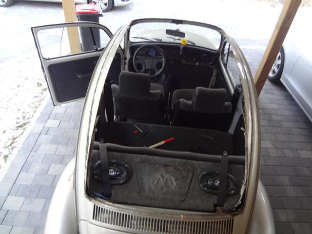

Here is a photo of a car with the roof removed:
And the roof:
And some photos of a new roof (from Deco Haus):
You can see the header in this picture as well:

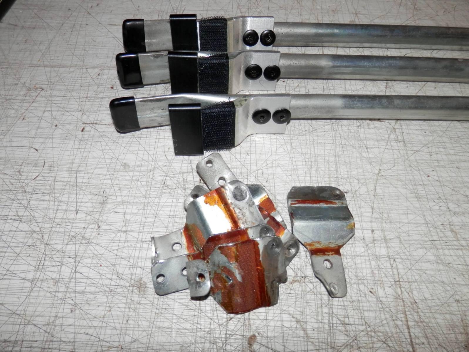

Frame
There is a black frame mounted along the opening, covering two aluminum 'tracks' that some sliders and a wormgear
use when the roof is operating:

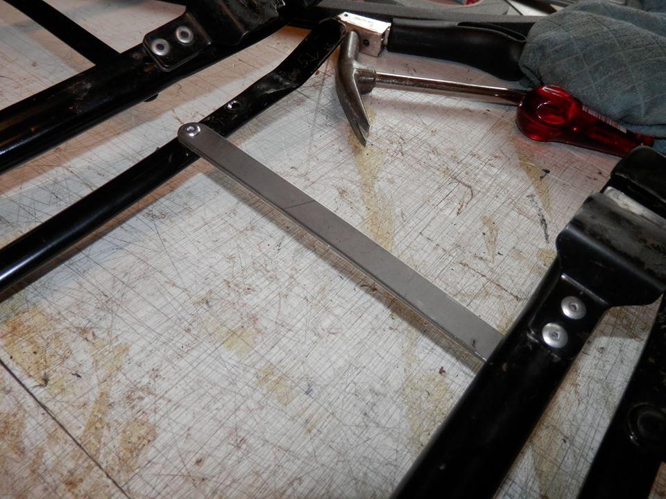

Ribs

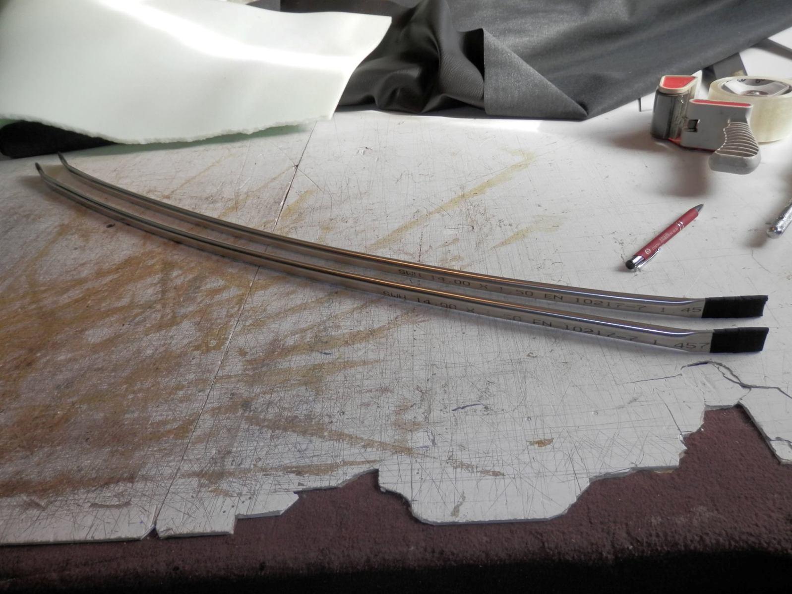

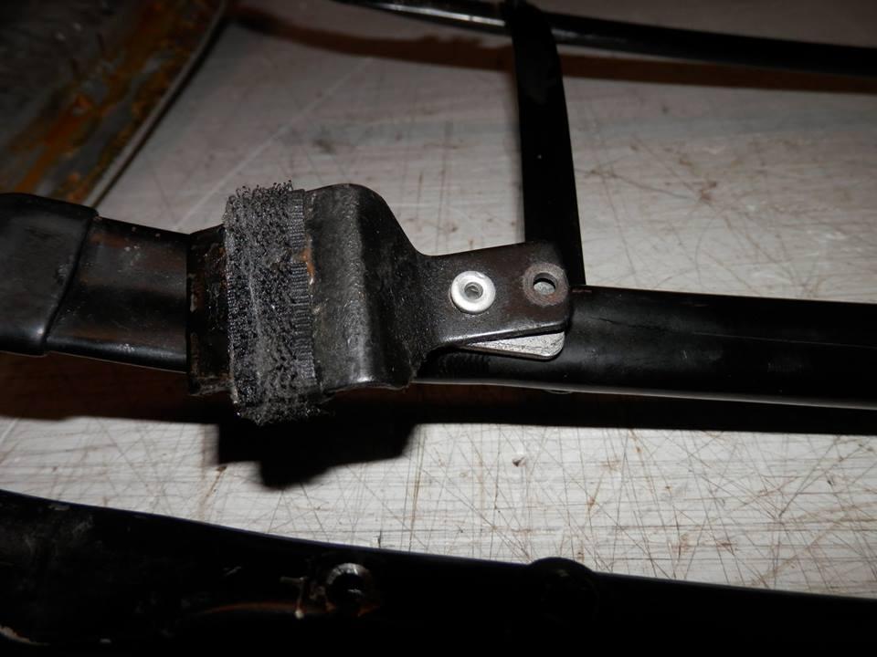

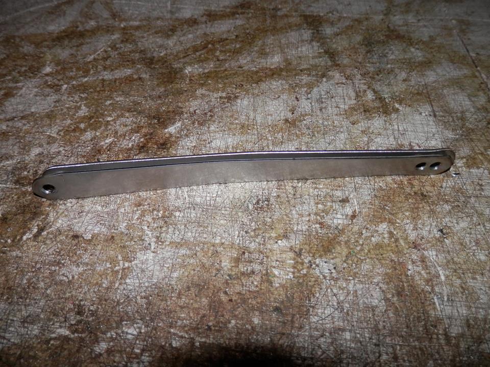

The roof itself has a series of ribs for support. Here is a series of pictures of the ribs:
Sliders

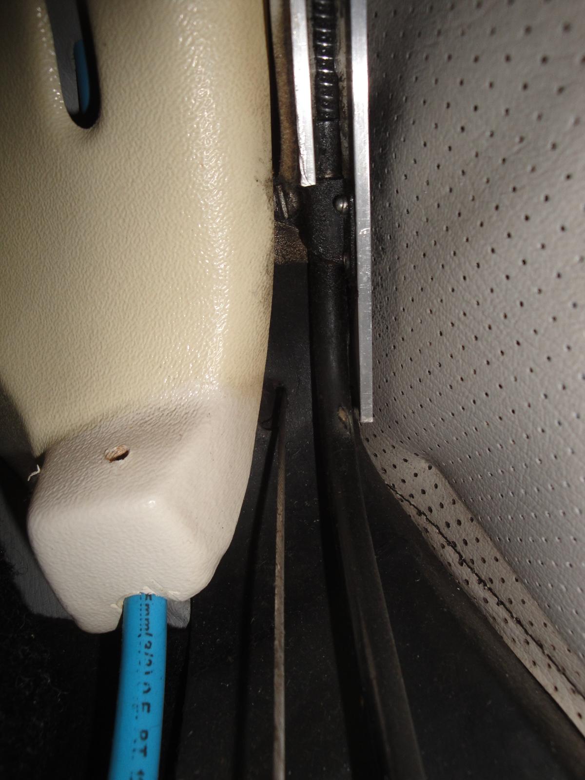

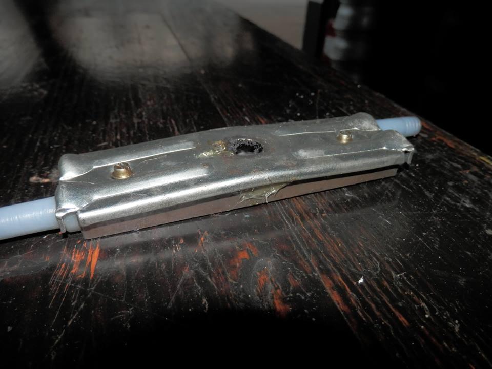

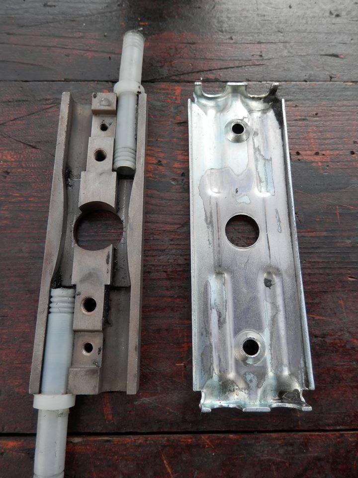

There are sliders that ride in the aluminum track:
Wormgear
There is a wormgear, similar to the gear used window regulators that sits in the track. It receeds into the
blue tubing when the roof is open:

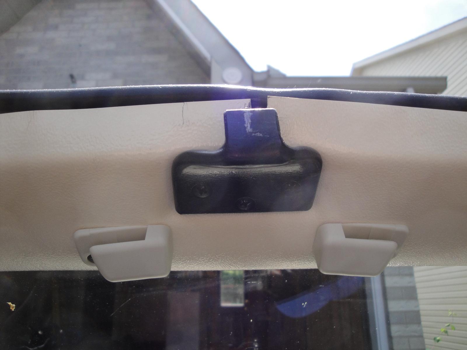

The roof latches above the mirror to hold it closed:

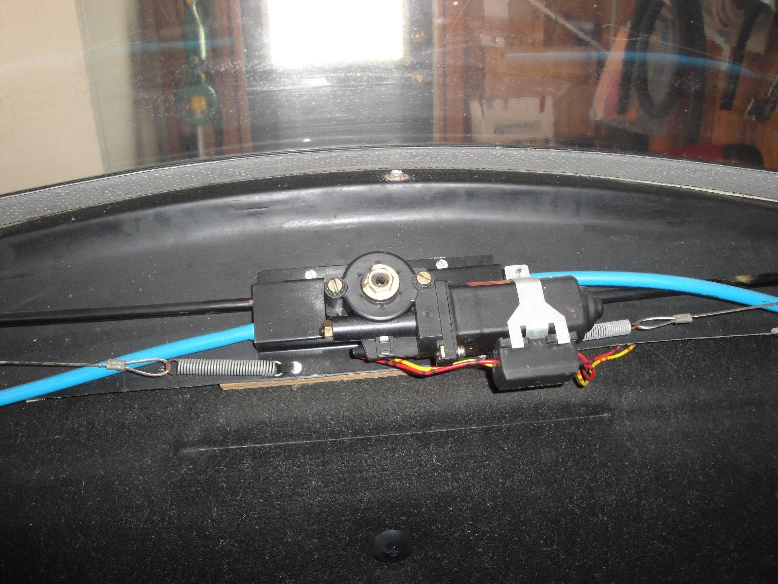

Motor & Parts
And finally the electrical portion of the roof. If you examine these pictures it's pretty easy
to see how the motor, wormgear, tubes, etc are assembled:

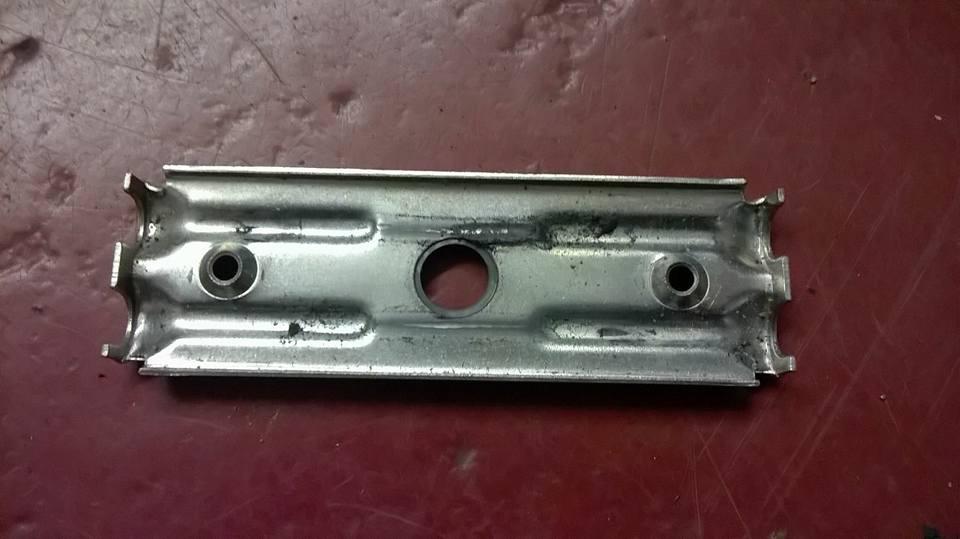

This piece is mounted under the motor and guides the wormgear to the tracks when the roof is open and back into the blue tubes when the roof is closed:

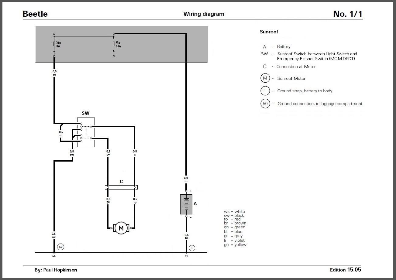

Switch and Schematic
A rocker switch is mounted between the headlight and emergency flasher switch.
Also I've drawn a schematic of the wiring (which I've posted before):

It looks like in some cases they leave the frame on. A few of the pictures show them repairing the frame. I think the frame was being repaired in the series I posted.
D'oh, I should have posted a picture of your car also, but I can rectify that:

Very Happy Very Happy Very Happy Thanks for posting that picture!
I am going to try to replace the roof without removing the frame. We'll find out if it's necessary.

Awesome reference images, Hopkin. My open-air top moves very slowly (think, sloth). Is this normal? Also, is there any recommended maintenance for these tops? Thanks!
hopkin wrote:
I have more pictures from Deco Haus, have a look at their FB page.
This is how fast my roof moved just after I bought it:
The roof material is old, and the temperature was about 5 degrees celsius, so it was a bit stiffer then usual.
Later on, I found that the plugs on the roof-open-switch weren't very firmly attached to the wires. I redid them and soldered them to the plugs, and that improved the speed (and power) a bit.
You might want to check those plugs.
