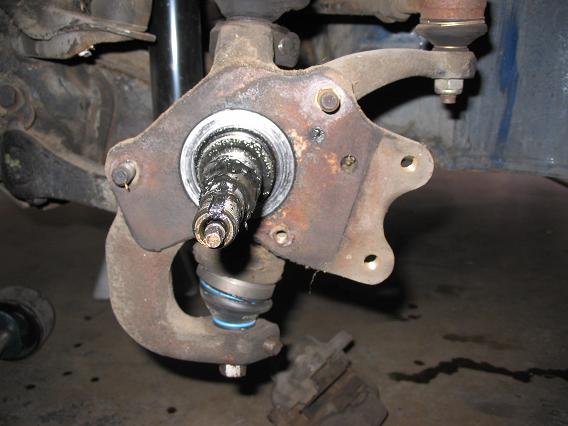

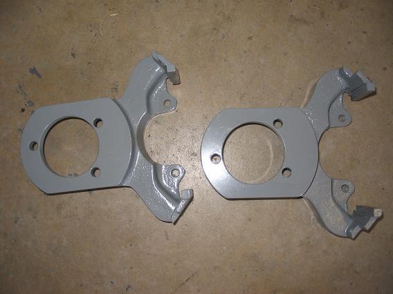

empi 66-67 beetle disk brake kit was used. As for drilling the holes I clamped the caliper bracket in position and used a center punch then a center drill and finelly drilled for the 10mm 1.0 tap size. (my 10mm 1.0 tap had cracked while doing this so I had to locate another not easy at 9pm) I had also checked the spacing from the bearing seal edge to the inside edge of the caliper bracket with a 5/8 round rod.
I think my wife also posted pictures of 61-65 type 3 spindles that I did not use as it looked like I would have to drill a new lower mounting hole for the new caliper bracket.
