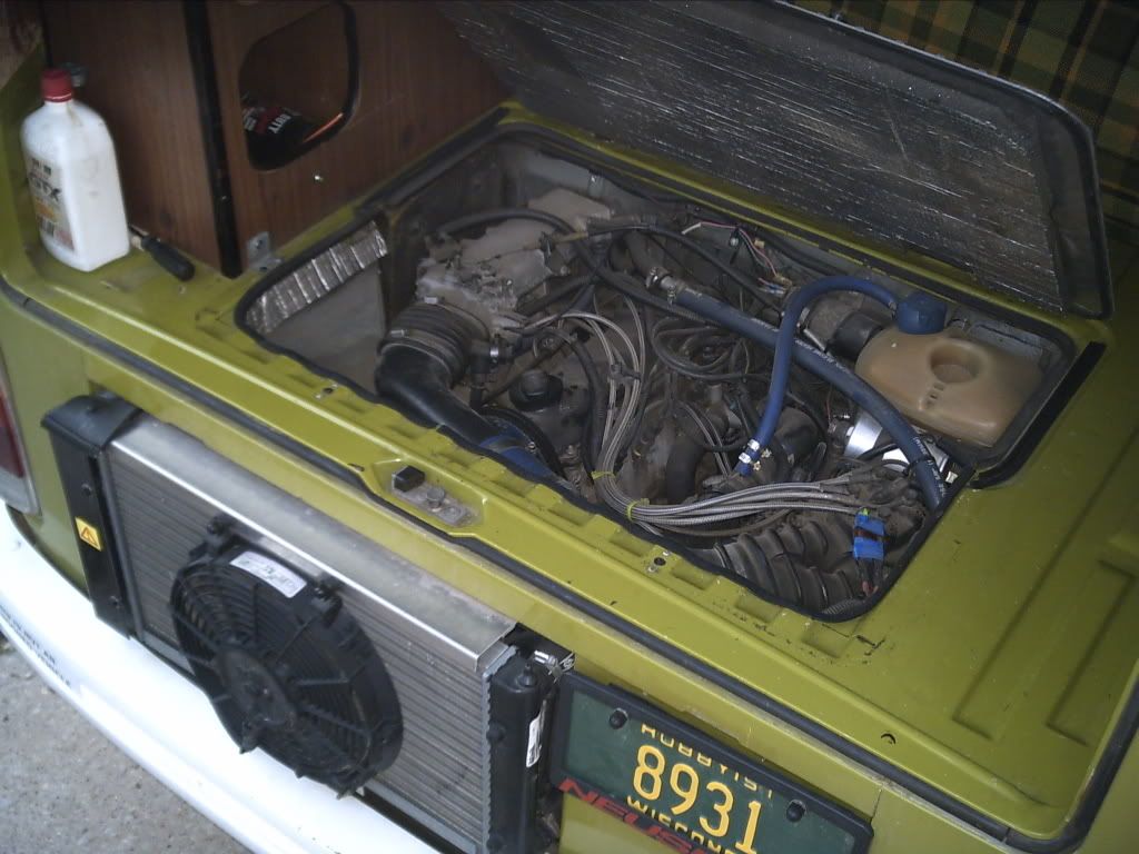

Thats true. in the 1.8 watercooled version, the air filter is confined in a cylinder shaped box wich has its normal inlet conected to a large periscope thats bolted all the way to the top of the left scoop.

Eh? water cooled bays... Think
