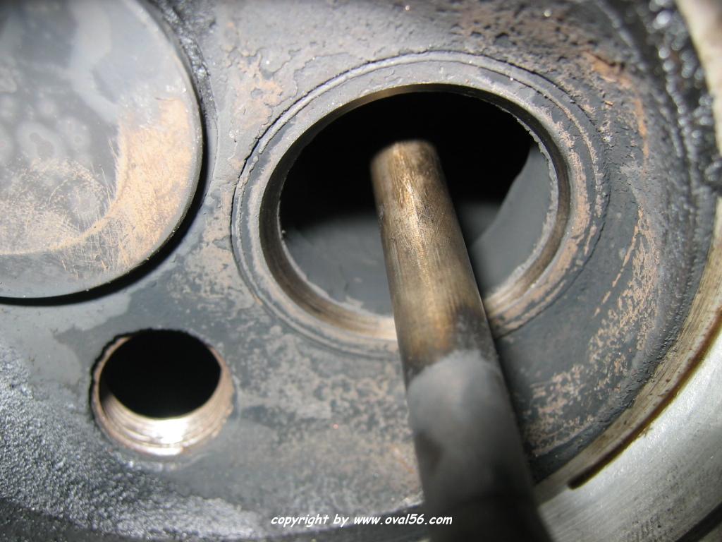

yes you are right, the oiltemperature will go down but the 356 oilcooler block the aircirculation in the fan shroud...so the cylinderheadtemperature rises! - overheatproblem on cylinder 3 /4
i do hat the problem on my second 57...
90°C oiltemp up tu 100°C at strong longtime runs... but an overheatproblem on cylinder3 with damage on only the head
after changeing to an standard vw cooler, oiltemp goes up to 100-110 deg
but no damages on my valves and head..

okay, the other way, 8000km with 356 oilcooler- before complete rebuilt engine AND heads, ignition 8° static, mainjet driven on dyno...., 8,5:1 compression ratio
8000km, problems on third cylinder..
after rebuild the head again, 18000km, no problem with any valve or head..
i do not say that the cooler of a 356 is a bad thing, but in my case , the airstream is lower becaus the surface of the 356 cooler is bigger than a stock cooler
if i would do it again, i would modifiy a stock fanshroud with a dog house shroud, and would use the adapter tu us a 356 cooler (356B or 912 type) in a doghous conversion...
and here the discussion in a other forum: http://forums.pre67vw.com/Default.aspx?g=posts&t=16265
