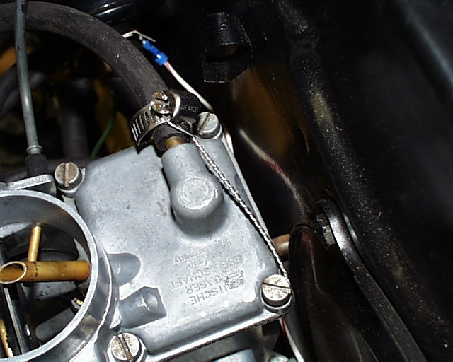

I'm replacing all of my rubber line today, I only have a rubber line coming from the tank under the bus and into the engine area. I will put a filter low (below the distributor) so I don't have the risk of fire. I'm also putting a wire on the carb section to prevent the line from popping out.
What is the hard line you are referring to?
