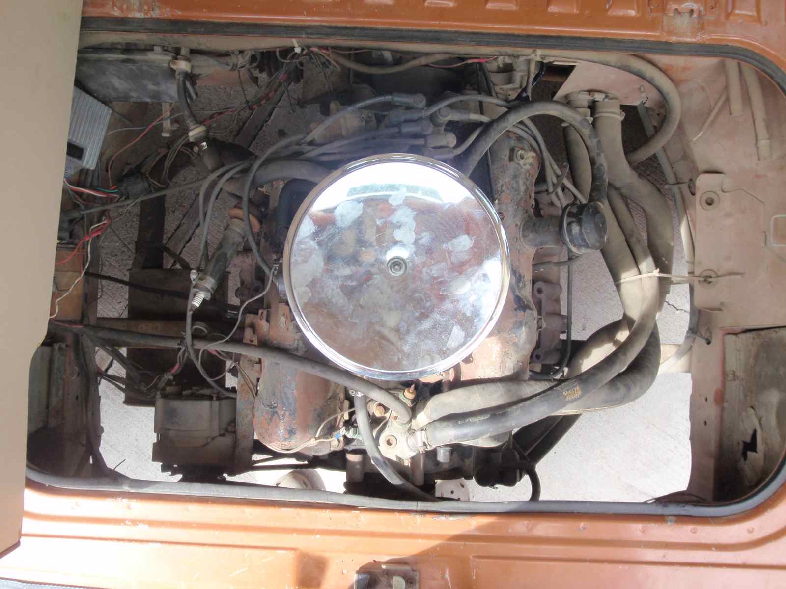

I recently bought a 1984 Westy with a 2.8L Ford Cologne (171 cid) conversion in it. Before I bought it, I tried to find some decent info on this engine and how it functions in a vanagon, and there was not a lot out there. I did find some good info on the engine: Here's a good description: http://www.therangerstation.com/tech_library/2_8L_Performance.html
Anyway, I thought I would post some pictures for those who are curious about the benefits vs. costs of American V6 conversions and what one looks like.

Here's a view of the upwardly expanded engine compartment. This is not my favorite thing about this van, but the trade off is a simple, strong, reliable engine. The deck is raised 6", and there is some plywood in there to make the rear bed work.

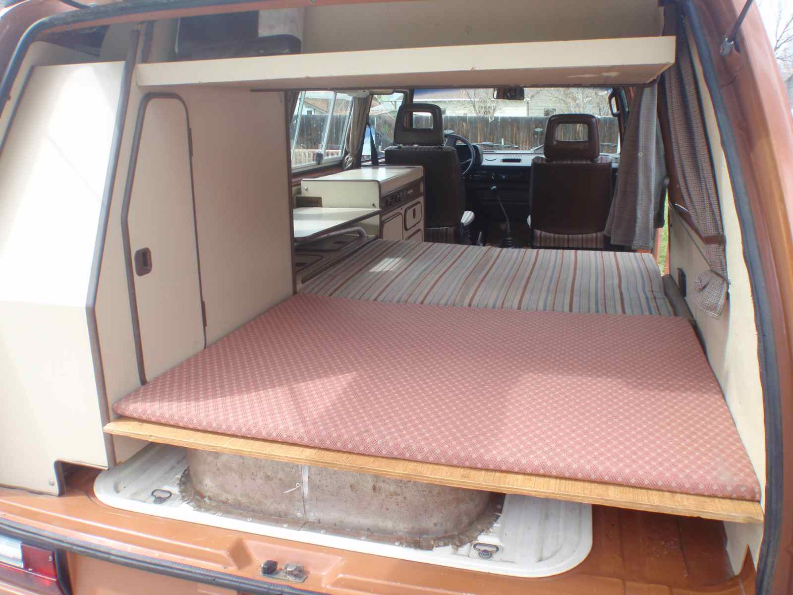

Here's a view of how the bed can and does fold out nicely. The original mosquito net was included (no holes).
Unfortunately, the closet cannot be opened without removing all the foam padding from the trunk area. Also, the coolant expansion tank is in the closet! The original expansion tank is still in the engine compartment, and I don't understand why a new one was installed up in the closet. There must have been a good reason because this took some work to do.
Here's the engine cover...
Here's the engine. It's super simple. There's the old school air filter with a carburetor under it, an alternator, some coolant hoses, and a dozen or so wires. Hard to get lost in there! Kinda reminds me of a lawn mower... and it would be about as likely to pass emissions inspections as a lawn mower. No inspections required in here Montana.
Another view of the engine here. There's paint peeling and there's some dirt, but it's mostly cosmetic. I did have to clean the carb out after this picture to loosen the throttle up. It idles at a constant rpm now.
Here it is with the air filter off. It has a Holley 2 bbl carb. I don't think this was stock on the Ford Capri. I have worked on 4cyl motorcycle carbs before, and this is way easier to work with.
So how does it run? Great! A friend (who is on here) put together a subie syncro once, and said this felt like it had similar power. I have passed a couple of 18 wheelers on the interstate without problem. This van feels spunky to me. More importantly, like Johnny Ramone once said, it is important to look cool, and this van at least sounds cool with it's old school deep, throaty exhaust. It smells old school too - kinda like how I imagine Mad Max's Ford Falcon smelled. My four year old thinks it cooler than a hand full of quarters and a gum ball machine!
On the down side, the instrument cluster is not working (no idiot lights, gas gauge, or coolant gauge), and I'm working on that. Maybe a grounding issue?

Wow. I wonder if you could rig up mega squirt for that and get rid of the air cleaner and lower the deck some what.

is that an afterburner igniter in the egr tube?

That engine name rang a bell. IIRC I was googling around curious of installing a V6 from a Ranger or Mazda.
re: MS. Maybe one could get the engine management from a later model year V6? Maybe more or less a bolt on affair?
In Wiki here:
http://en.wikipedia.org/wiki/Ford_Cologne_V6_engine
check out the 2.8 paragraphs. There is mention of this engine using carb, mechanical FI and electronic FI
"..... In Europe the 2.8 was produced with carburetor (132 bhp), mechanical fuel injection (Bosch K-Jetronic, 160 bhp), and electronic injection (Ford EEC-IV, 150 bhp). Electronic injection only featured on the 2.8 Granada models for one year before being replaced with the 2.9 unit.[citation needed] "
I wonder if either the Bosch or Ford FI system was installed on any North American vehicles?

probably good ol fashion cast iron on that bad boy no aluminum, i think the colognes stopped in the early eighties or so maybe late 70's , how miles do you think on the motor?

ENGINE COVER: I probably won't spend any time lowering this for some time, or at all. The mega squirt idea is new to me, and maybe someday I'll look into it more. However, their website says, "the MegaSquirt® family of EFI Controllers is not designed to be a 'no hassle' solution to user's EFI needs...a large amount of reading and study is required." Hmmm....for now I'm a fan of K.I.S.S. (I'm a grad student and a dad).
GAS MILEAGE: this rig gets 19-20 mpg. I'm OK with that and hope to improve it. BTW, what is proper inflation for R14/75/195 class C (50 psi max rated) tires on a camper vanagon? I've been going with the 185 standard specs .
FUEL DELIVERY: The FI from a newer model Ford 2.9L from a ranger can be retrofitted on this 2.8L engine. However, for now, I like the simplicity of the carb.
KENNEDY ENGINE CONVERSION CHOICES: This might be interesting to some. I have the original Kennedy Engineered Products (KEP) installation guide and catalog, which is cool. The KEP catalog lists a whole bunch of engine conversion choices and rates each in the following: performance, smoothness, durability, price [outdated], availability [outdated], expected gas mileage [mine is 18], and minimum radiator size. I can post a picture of this if anybody wants it. Interestingly, my engine was rated #1 for compromise - smoothness, power, and simplicity, which is why it was probably put in my van. They say the subie 2.2L is ideal if you can connect the "computer, etc...", which people seem to have conquered. I like my engine because it has pretty consistent power at all rpm's, and this is the only vanagon I have driven. I am betting a FI 2.9L out of a Ford Ranger would be nicer. I would prefer a subie engine given the choice. My engine adds a tad over 100lb of weight over the stock 1.9L boxer, but it does run nicely.

@r.e.wing_fc3s : Yes, that IS an afterburner ignition in the EGR tube that is currently non-functional. I didn't want to ruin my nice tires via burn out, so I unhooked it. I'm still considering a Gatling-potato gun retrofit to the Thule roof rack to deal with pesky tourists. Twisted Evil
Seriously though - somebody plugged it up for simplicity. Again - car inspections are not required in Montana, for better or for worse.

While I'm certainly not a Ford Cologne V6 enthusiast, I do remember that the 2.9 liter fuel injected version that came in late 1980s Rangers was quite powerful. When I was in high school there was someone with a 2wd Ranger with the 2.9 V6 and 5 speed. As much as I hated to admit it (and still do), it was as quick as my 1984 Scirocco. Upgrading to one of these in your van would be a natural choice. It would probably be more compact too.
yes you would think. ford used this engine in 4.0l ohv form up until 2000.
D
Had this same combo in an '88 Aerostar van and loved it. Surprisingly quick for a van, at least subjectively.
This motor was rebuilt in 2008 and came with a 6 mos/6k miles warranty from a local shop. The previous owner said he put about 7k on it, and then adjusted his estimate to 10k. He never had a working speedo, but I believe him. He has another car for getting around, and he works as a flight attendant. So, he was out of town a lot. I know he drove it to St. Louis twice without problems.
