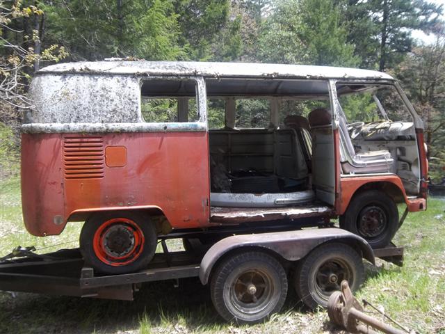

The bus burned on the side of I80 on the way to skinner's shop last night. It is totaled. Crying or Very sad
Looking for a walthrough bus to replace it.
kombisutra
Joined: October 02, 2003
Posts: 4127
Location: San Anselmo, 10 miles North Of San Francisco
kombisutra is offline
PostPosted: Sat Dec 22, 2012 8:38 am    Post subject: Reply with quote
My condolences for your loss, I just heard about it... even from 20,000 miles away.
The good news may be that your walk-through is actually waiting for you to pick up right now. I pulled it out with Christopher Moore last year and I'm sure Robert would happily help you unload what's left of your cadaver and turn right around with you and drive up to Willits to pick it up. It's a Standard that will require the surviving parts off of the cadaver, along with quite a bit of the sheet metal. It looks good, it's pretty damn straight, and it's got your name all over it. Price is likely VERY reasonable too.
Robert will contact Mr. Moore. If you don't have money now, I have good credit with Mr. Moore, and you have good credit with me. Plan on leaving immediately.
Oh, wait... you had full coverage insurance on it... Laughing Idea
This means you have -other- options. I guess it boils down to whether you want to pay off bills with the bread and slowly put this one back on the road, or just find another driver and use the insurance bread as intended.
Lucky and SMART guy you... having full coverage. Will be curious how that turns out.
