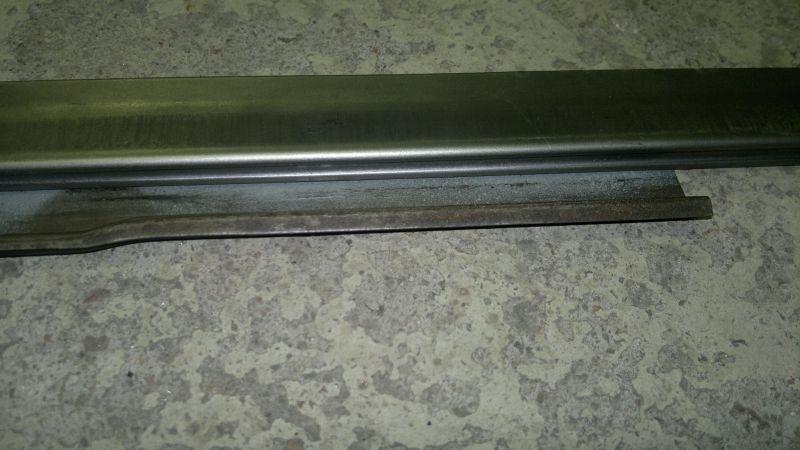

Removing old rotten sash. This is for left side.
I used 12x12 mm iron bar to get correct distance.
And distance from end approx 18 cm
Spot welding to original points
Ready to use

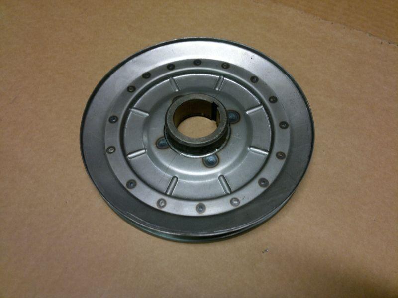

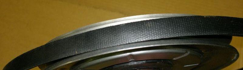

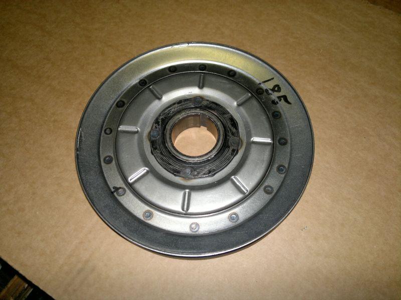

The first proto of crank pulley for 25hp Very Happy
My plan to use old used hubs.

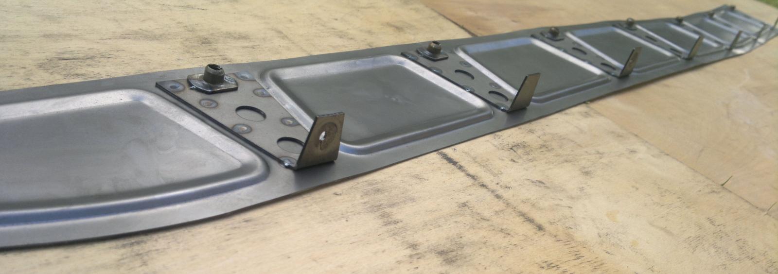

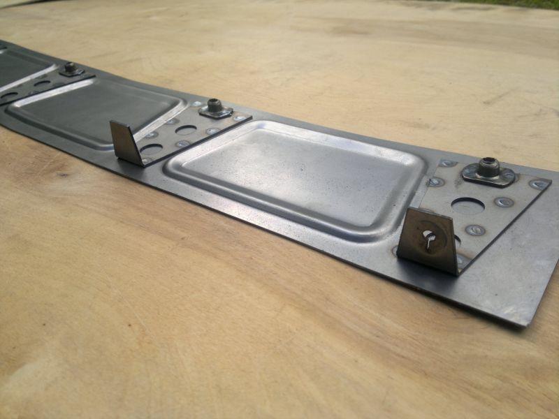

Complete bottom plate for early heater channel.

OMG Shocked all beetles with bad heater channels can smile from now on Very Happy

Wonderful parts Mika! Thank you for your suppport to the hobby!
Could you briefly explain the difference of the heater channel bottom throughout the Split/Oval-era? What are the "generations" of pressings?

I made this according a late '51 original part, and have not inspected later versions so close. I have noticed some changes for outer cutline later versions.
One question is not clear for me, there is a douple hole at front, does the douple rectangular nut belongs to the bottom plate, spot welded there? I think it does. So some more work to do to be complete bottom plate Smile

I think the double nut block needs to be free so it can be moved around for alignment of the bolts. I have removed and replaced several bodies from the pan. On each body the block was free to move.

Yes, nut needs a holder which allow some movement.

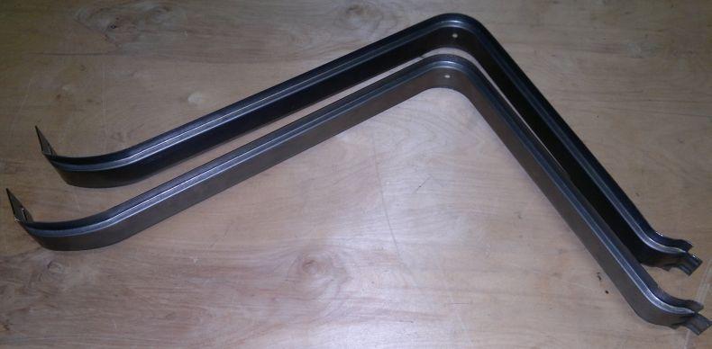

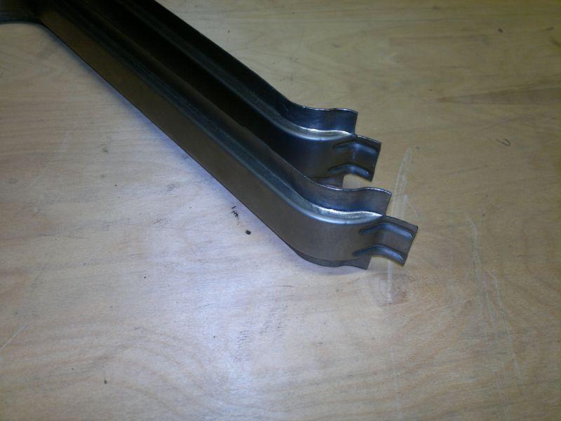

Protos of early pre49 bumper irons, made of special spring steel. One for rear (both left and right are the same) and one for front left side.
