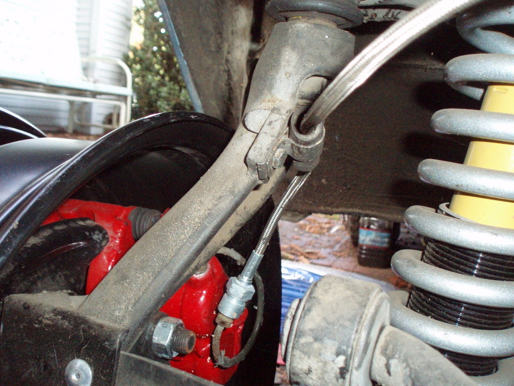

I mounted a one of the 16" steel rims on the front of my syncro to verify that they will work with my big brakes. I gave it the "hand test"- which is simply stick my hand between the rim and anything that it passes by and it passed with flying colors. My 15" SA steel wheel will not work with my Audi G60 brakes. Any custom rim made from a 14" center like the ones that GoWesty sells will not work as well.

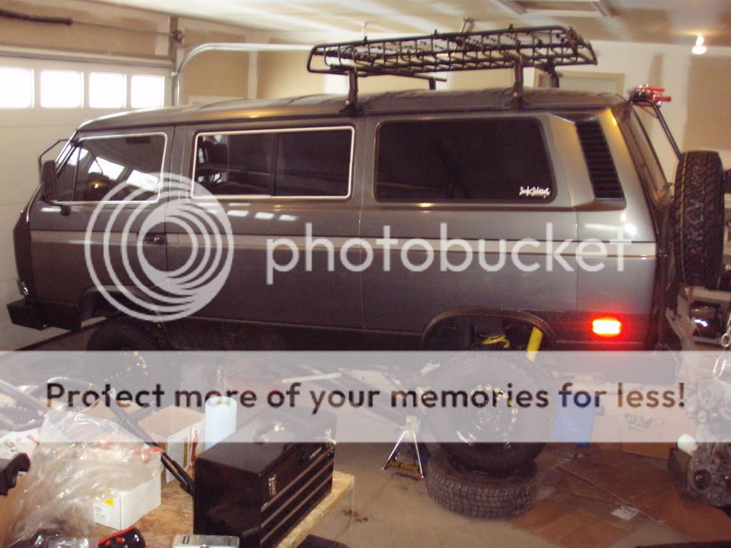

GOT THEM ON LOOKING TIGHT!!!!
In the midst of doing the BOSTIG CONVERSION... Got my Gary Lee Ladder and Go Westy Spare tire Carrier on as well.....

The 16" merc rims will bolt straight on with the correct hardware. The lugnuts from loogy have the correct size ball seat for the rim and the correct 14x1.5mm opening to fit the vanagon. I am not aware of any stock lugnuts that will work safely. I would never consider running any rim that the lug nuts do not correctly fit the profile of the lug bore from the fear of losing a wheel. I do not know what is needed to make them fit a 2wd but a syncro is not a problem. The pictures I posted have the correct hardware.

Got them on, had to smooth out all the welds.. real tight fit.
Put the safri basket on... dont like the towers though... going to use a pair of ladder racks and paint hem black..
Winter need to get over so I can put that damn Zetec in there..... Razz
-Lorenzo
