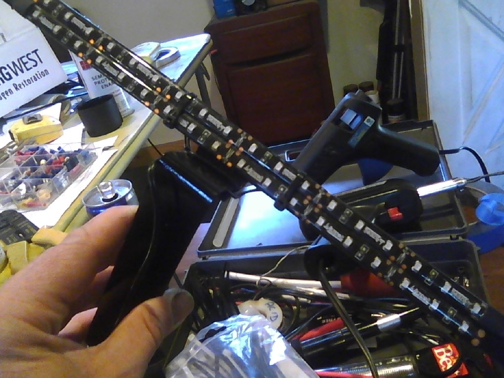

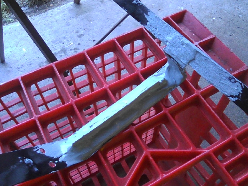

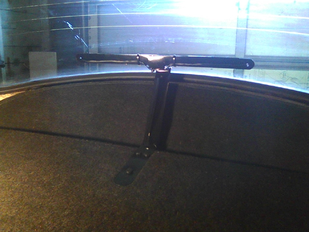

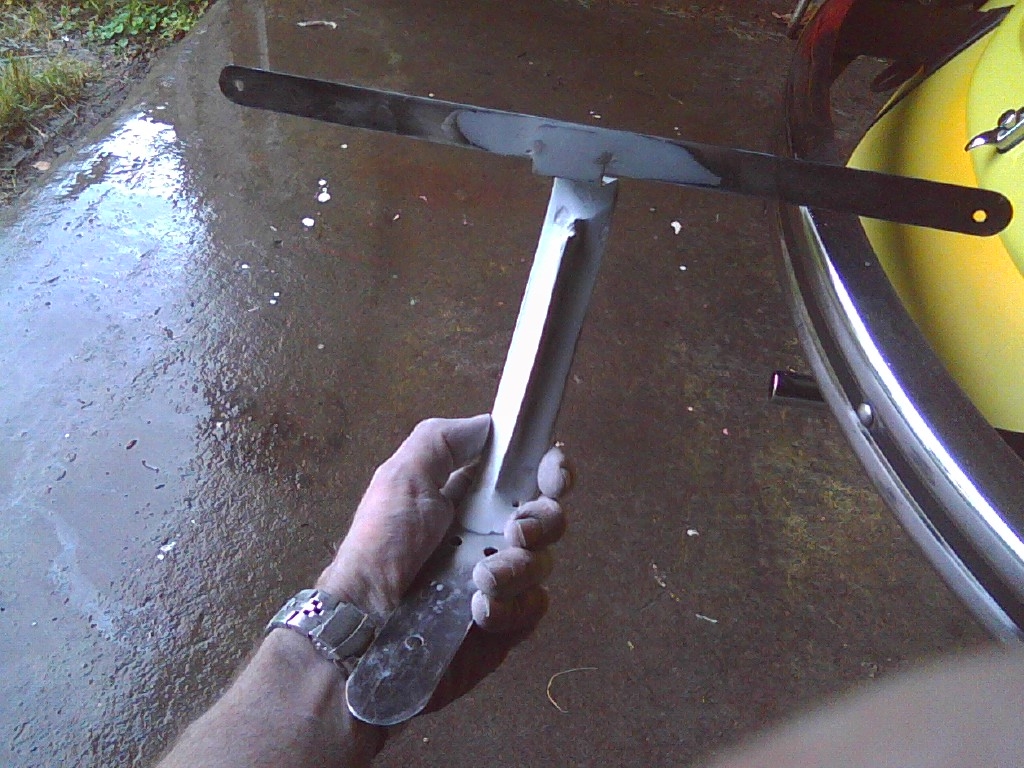

PostPosted: Sun May 27, 2012 8:37 am    Post subject: Reply with quote
So here is the project in it's entirety. The pics pretty much tell the story. If you only have something crappy to say, please save it and just post your own superior work. I worked to the best of my abilities and it does what it is required to do. LED strips from Auto Zoned, the bracket was made from free discarded steel banding. I picked up the power next to the voltage regulator as mentioned by Ashman. Thank you everybody for the advice and recommendations.
1

PostPosted: Sun May 27, 2012 12:01 pm    Post subject: Reply with quote
Man ----you knocked it completely out of the PARK ! ! ! !
Wow
love it - I need to get started on one for my vert !

PostPosted: Sun May 27, 2012 12:13 pm    Post subject: Reply with quote
WOW!! I don't know why anyone would have anything bad to say about that, it's gorgeous, and kicks the ass of MY craptastic 3rd. Nice thought process on the gusset by the way. I prob woulda left it out, got pissed when the bloody thing flopped all around like a bobble-doll like and ripped it out Laughing

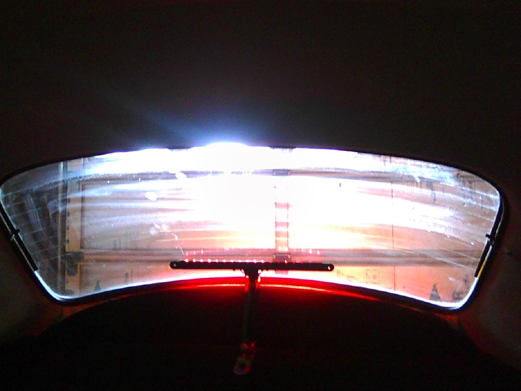

68IHscout
Joined: March 10, 2010
Posts: 3122
Location: santa ana ca
68IHscout is offline
PostPosted: Mon May 28, 2012 7:20 am    Post subject: Reply with quote
Willhelm wrote:
Thanks all. If nothing else let it inspire. I'm happy the thread grew into something so useful. The contributors here posted some really good information about options and wiring. Hopefully it comes up for people doing a search, I know all my questions where answered. Thanks again for the help and kind words.
hey take it easy we are not done with you here ,..I have to get in my two cents worth ,...that is some very creative well done work , and it looks great , one question , on the pic inside looks like there is glare on the glass from the light if so what you doing to direct the light just straight back ...

Willhelm
Joined: February 13, 2011
Posts: 818
Location: NY
Willhelm is offline
PostPosted: Mon May 28, 2012 8:53 am    Post subject: Reply with quote
Ha! I thought I was getting off too easy. Smile Yes there is some glare on the rear window. It really does not trouble me, in fact it tells me the brake lamps are working which is good to know and I wondered about sometimes. I'm not really a frequent night time driver so for me I won't have to worry too much. Crossover and SUV headlights are my pet peeve. If I can put up with that in my rear view mirror a little red glare is a minor inconvenience. You make a good point though. I reckon one could go a step further and make a shroud but I opted for simple. I admire all the cool solutions people are posting. Seriously though, it is what it is. I'm going to leave the post alone. Awesome if others want to add to it.
