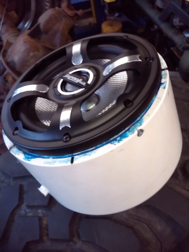

I had thought about something like this, double sided tape on the back, for the rear. Ugly and the boxes are tiny. Not sure about that part yet
some PVC end cap speaker pod redneckery

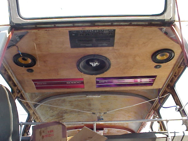

Here are some pics of my install......not the biggest system, but nice and crisp Very Happy
I did have a sub, but it had to make room for a gas heater Rolling Eyes (British summers Rolling Eyes ).
I think that's about it, hope it was some help ?
Phil. Very Happy

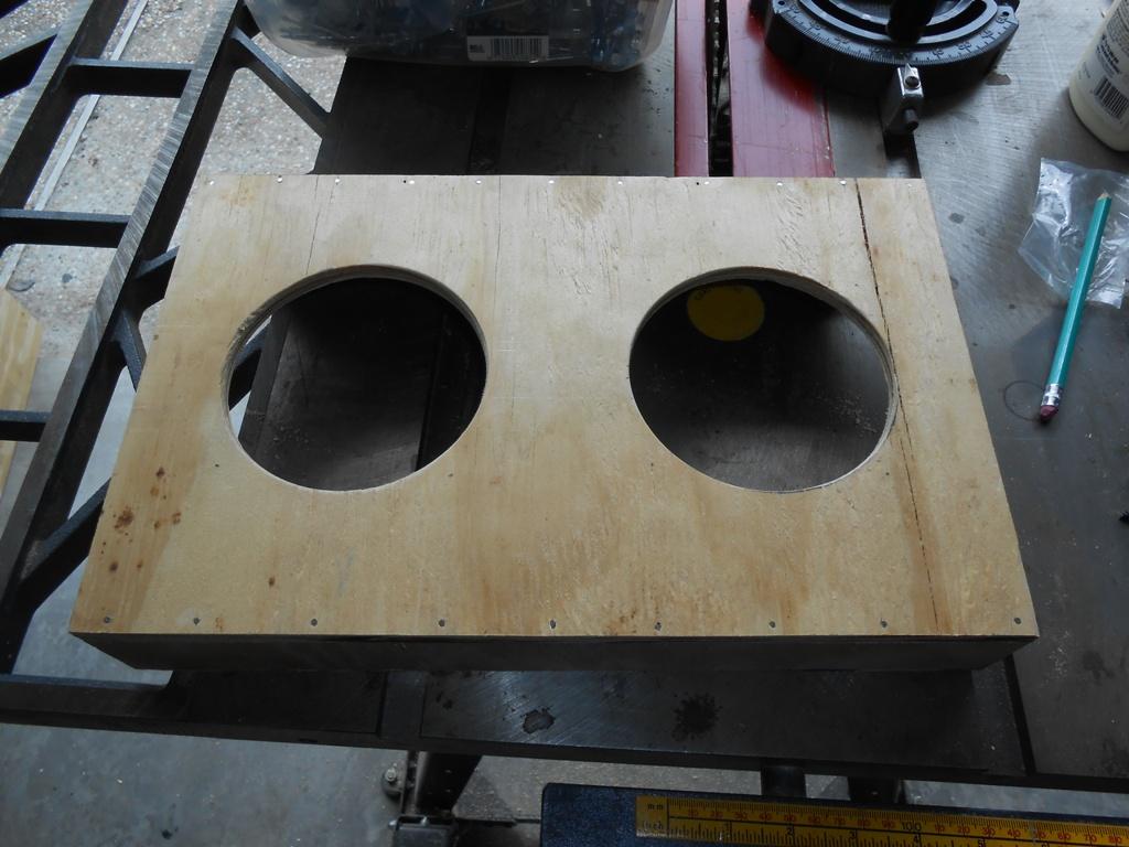

I just got finished installing my rear speakers but didn't want to cut any cabinets or panels. I saw Phil's picnic basket and borrowed/stole the idea.
I originally wanted a vintage basket but didn't want to spend the big $$ for one. So I bought this one on-line for $40 brand new:
Then made a wooden stand for the speakers and covered it with the material from the bottom of the basket:
Trying to keep with the period, I placed the basket in the back of the bus. My speaker wires come down from the ceiling through the corner cabinet and out the back side (gap). The wires are long enough to place the basket on the rear bench seat or the fold out table if I wanted. I also put disconnects on the speaker wires that poke through the back of the basket in case I want to remove it completely. Most surprising is the sound even with the basket closed - which it is most of the time. Since the basket is weaved the sound is not muffled at all. Pretty cheap solution without any custom work or cutting.

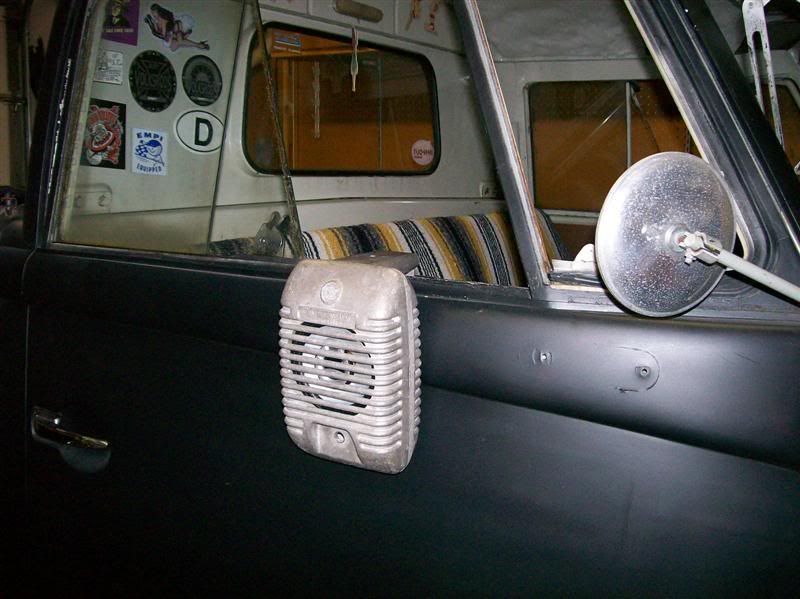

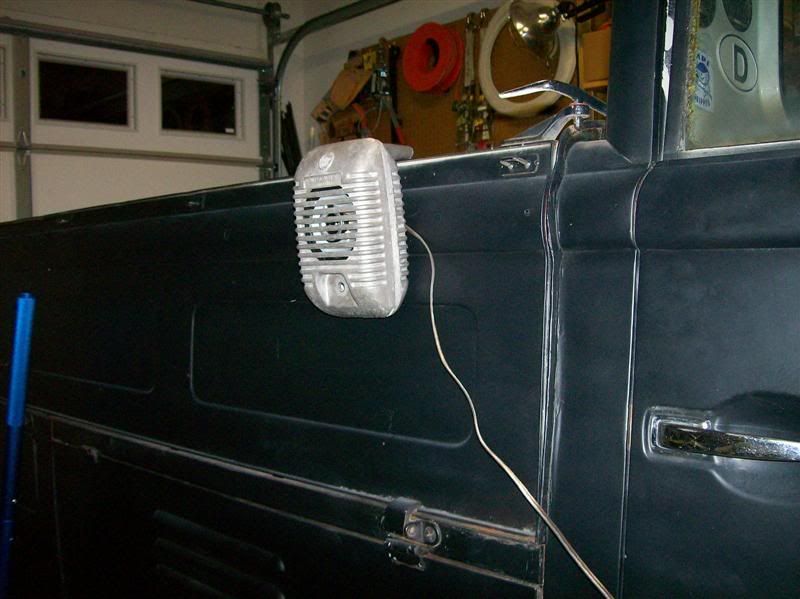

here is my setup. i lost the pics of the amp but i was able to get a kenwood amp in the space under the bench seat, rear section was saved for the 10" sub. the amp is secured by about 6 square inches of Velcro, not gonna move. the hot wire was ran from the battery with the correct inline fuse. the ground is made at one of the holes under the bench seat.
since i am using an iPod i did not have a "remote" switch. 1 wire was ran from the (+) of the amp to the "remote". an in-line fuse was used on the (+) side and a light up switch was put in place. now i can run the tunes without the motor tuning and w/o fear of messing up my ign parts. the switch is under the seat and come out at the heater knob, no drilling was done. the iPod input cable is between the bottom and back seat, nice and hidden.
speakers are (2) 4" 3 way Kenwoods in drive in speaker boxes with about 6 feet of extra wire. i can hang them outside on the door, gate, whatever.
i still need and want to cover the speakers inside the cases but that can come later. also i want to use some vintage looking cloth covered wire, again that can wait. i did put in some early bug dash knobs with some bolts to fill the volume knob hole (did not come with those).
the sound is ok but i need to get some foam in the backside to cut down on the "tinny" sound. the sub will help on that also.
I paid about $30 shipped for the drive in speaker cases.

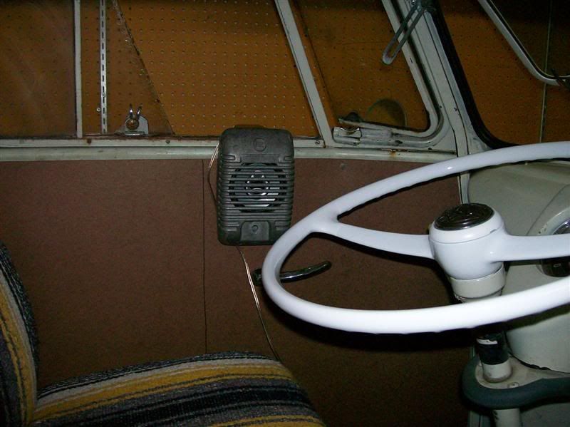

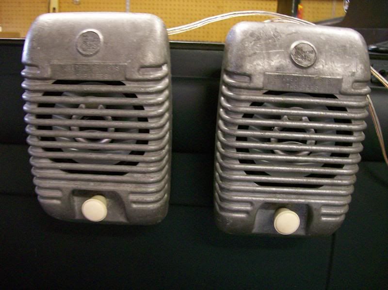

I also have Drive-in speakers in my 57 SC w 200w Boss' also have a 1000w 8" slim subwoofer where the spare used to be and a pair of 6" Polk audio in kick panels powered by 1 5 chanel amp in space under seat Cool It thumps the lil cab Very Happy
