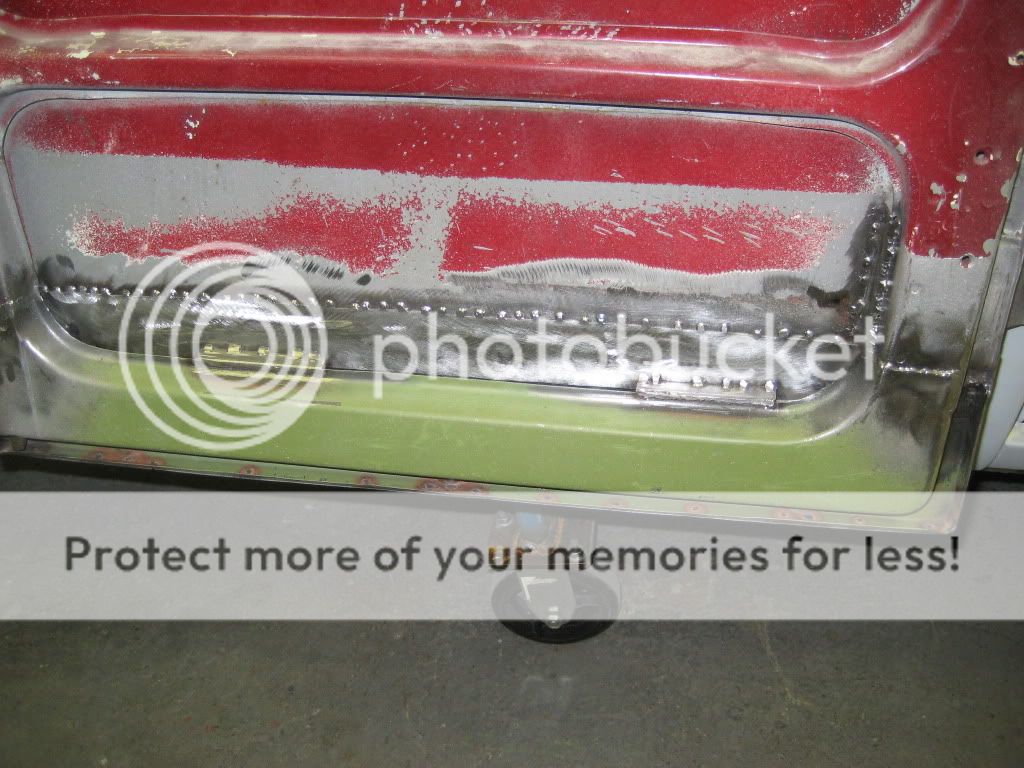

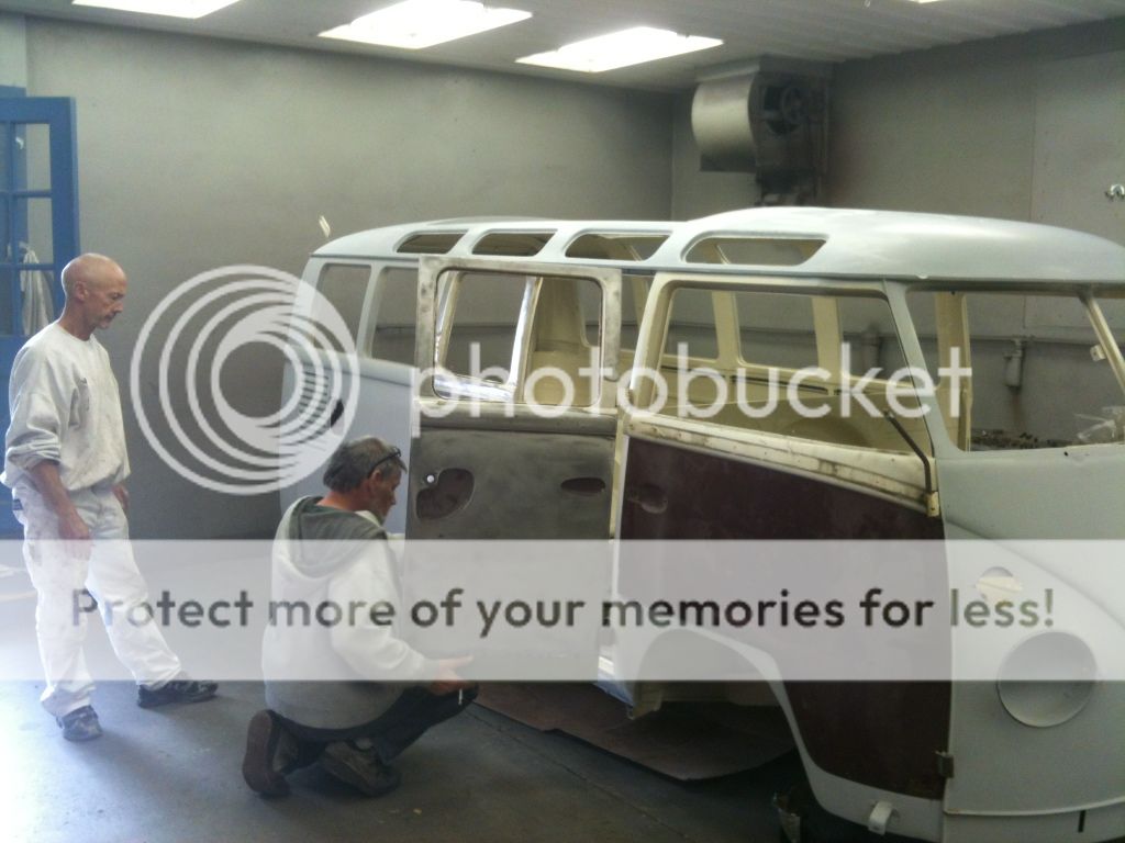

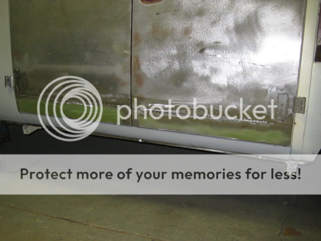

Ok ,That out of the way,lets play a little catch up and start with the cargo doors .
We fitted both doors and both need some attention.
Both doors were a little to long so we careful removed the exitisting replacement panels, which luckily were only tacked on. The lower rear door hinge pin was pretty stiff,probally seizied at on time from sitting causing the hinge to start breaking away from the frame. We replaced the pin then cut an access to weld the hinge back up to the frame and get a nice gap to the rear panel.The front door seemed ok but did the same there just in case. Finally after all the fits were good and tack welding the replacement panels back on they were welded up for good. The pinch weld on the rocker also got a little TLC.
Inside both doors got a little extra reinforcement welded in and some extra reinforcement in the centers to stop any oil can effect when the welds and dents are refinished.

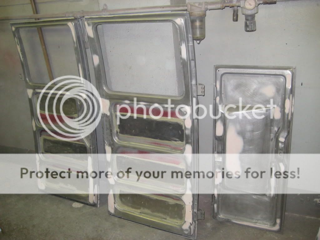

Here the inside of the doors have been sandblasted refinished with worn out trim screw holes welded and any dents filled.
Finally the finished doors along with the engine cover refinished on the inside.
Will post more very soon. thanks Gary

Everybody uses filler, especially on a project as infected by the tin worm as this one.
I don't care for the drama but I do appreciate seeing the panels with filler, before 2k. Helpful to bodywork amateurs like me.
