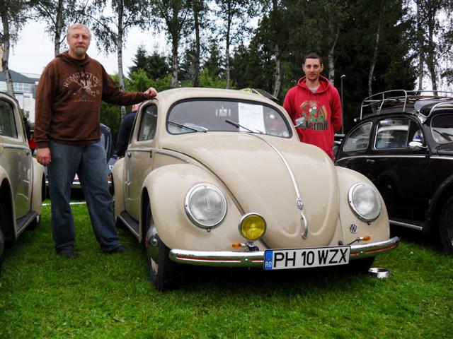

Just to add a nice picture of your car taken ad BC (I almost forgot on your topic here), but I recognized your car while sorting my pictures taken there...
Greetings from Croatia... Razz

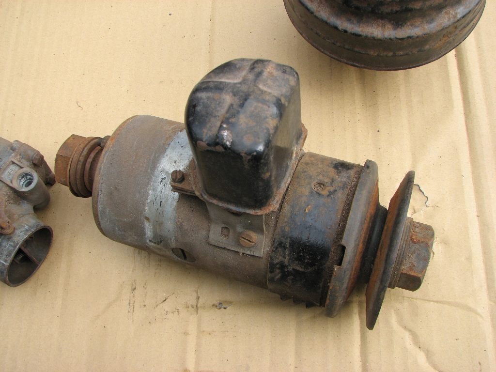

having a short summer, well, i thought this winter i should do something different. so, with the right timing... i just got what you can see... is this a 25 horser? well, i guess it is. year? unknown. but i guess 1953 1954 the latest?
what i could see: D regulator, big nut , thin lip gen pulley, 25hp crank pulley, split era fuel pump(but maybe 6mm line) . the shroud seems 30 hp.. with the banana pressing, i was hoping for a 52 only type, guess i will have to use the seamed shroud in the basement. also, the generator belt looks split type with louvers..
unknown wingnut airfilter, magneto, 28pci carb, etc
the water pump is missing but i have no use for it, the cart will be staying in Norway a while.. i don't know if i will get it with the engine as well.
now, on to find a 52 split gearbox, to go cruising the right way! ah yes, 6 volts as well!! Laughing
i will be selling the parts i won't need, like magneto, airfilter, carb (if it's the early version without vacuum port) or maybe trade the parts for what my split needs

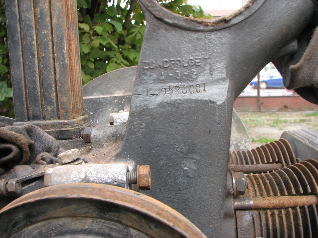

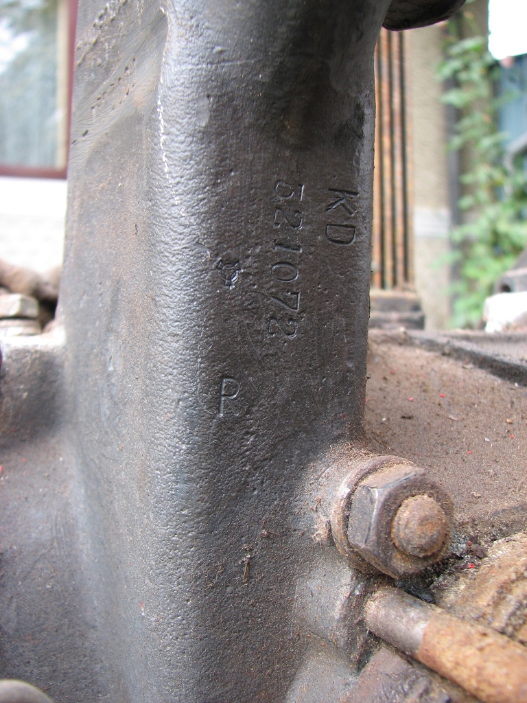

update, serial number is -1-0523081 so a january 53, 100% zwitter engine. looks like someone put in a sedan engine but kept some industrial parts like air filter, magneto..
other serial is KD 321072 . sorry but the engine is now in Norway waiting to be shipped , so it will take a while to get and post exact details.

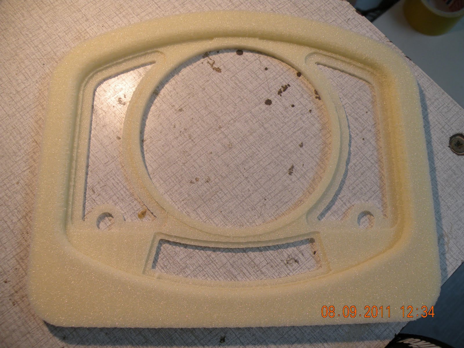

next, on the list... preparing a proper radio faceplate to assemble a becker monza radio with blaupunkt guts! Laughing i like the idea of keeping the clock in, just to have the original split dash look with original instruments. the metal net was sourced easy, will be a bit tricky to have the becker monza knobs made as close as original as possible.
meanwhile, the split will have a "garage" to spend the winter. not done yet, just because i liked the idea of open space. will have a sliding door on the right side, and a half glass wall on the left side, foldable doors on the middle. in the pic, my small fiat abarth 595 for a select company. the dog was there in the pic but actually just visiting. a dachshund is the guardian, pics of him later Smile

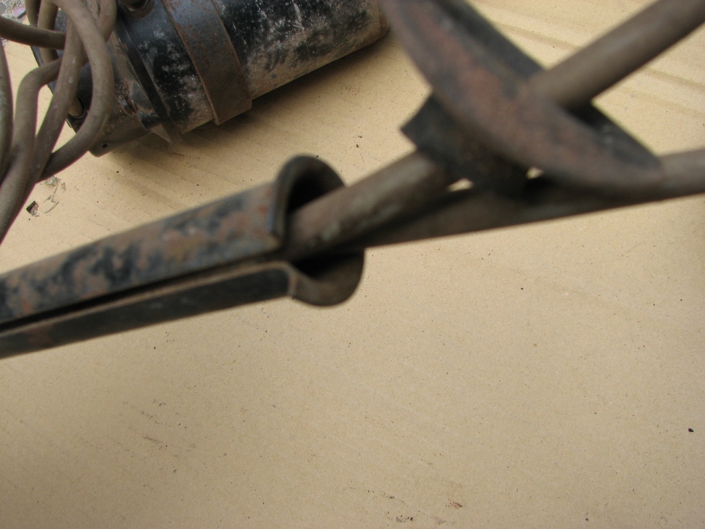

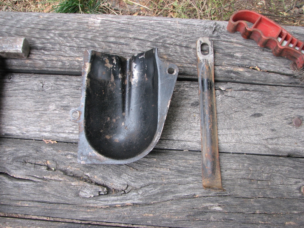

Monday the "new" engine showed up at my garage. well, what can i say :
KD engine, looks ok, but won't turn a full turn on all cylinders (maybe stuck valve or maybe one or 2 damaged cylinders ). lots of dirt on it and under it, some parts with austausch square on them. LATER EDIT: there was a stuckk valve, now the engine turns ok
cylinderheads are later replacements but look brand new. also the inside of them is clean and nice.
big nut generator thin lip pulley
D generator regulator,
split fuel pump almost nos, have not measured if 6mm or 8 mm
magneto by scintilla, looks nice but will be for sale soon

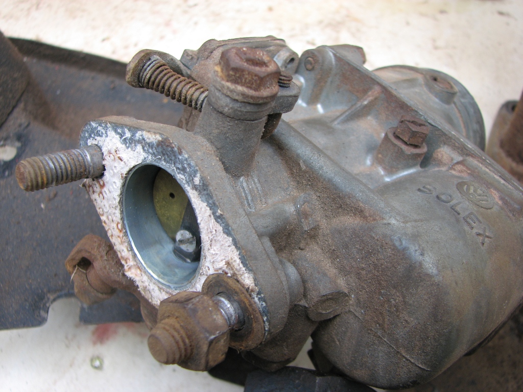

1953 only carburator 28 PCI without vacuum port casting, in very very nice condition,
casting date is 21 1 6
some of the tins are 36hp, some are 25 hp.
36hp: fuel pump tin, left bottom tin, shroud.
25 hp: pulleys, upper cylinder tins, lower right cyinder tin with the margin for X tin, but do not have any heating levers and such. clamps for the tube look 25hp, what about the tube for the plug wires?
intake manifold is the 701 with erased E, 25hp, light surface rust on the outside but not clogged and perfect on the inside.

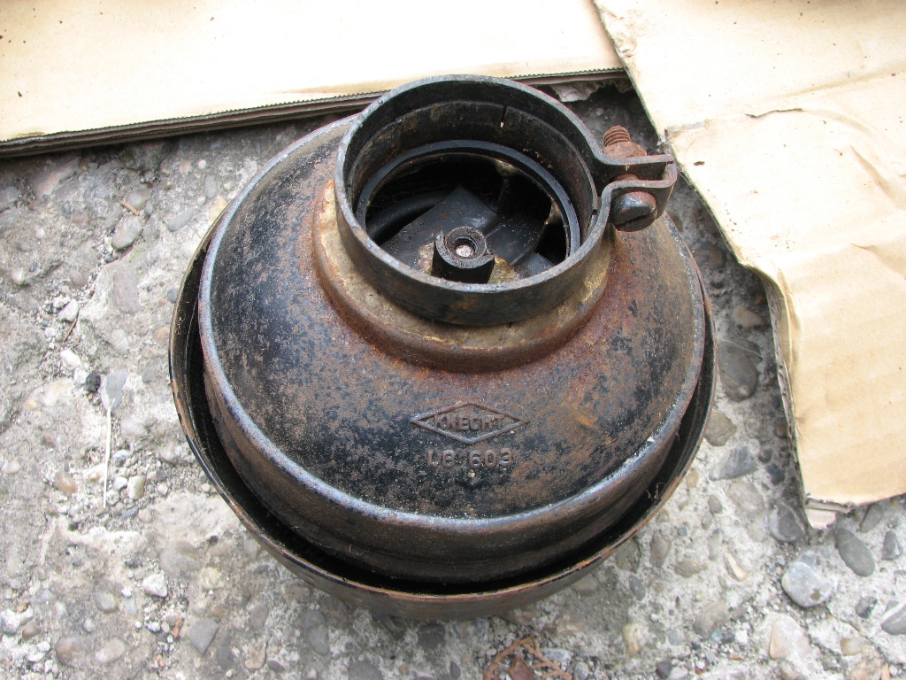

airfilter with wingnut seems to be a split bus version.
exhaust is solid but needs some love too
pressure plate has a small tooth piece broken but seems ok , i will try to rebuild it,
clutch disk will be replaced.
the cart that was the engine on doesn't look vw at all, not even the engine mount. it has 19" wheels from KPZ, with motorcycle good year tires on them. i will assemble it sometime later this winter.
now the fun begins: getting correct parts, a 383 dizzy, cleaning and painting tins, tear the engine apart, measure it, replace what need replaced, put new seals and gaskets, etc etc. the flywheel is trashed, teeth are worn, will have to buy another one. will the 36hp one fit ok? is there anyone selling just the crown to be replaced?
i am a bit worried about the serial... because it's modified that way, i hope i can put it there and get it registered as such. usually is not ok to try and erase a serial from an engine. was KD in Germany, KDS in Sweden and KDF in Finland etc? this engine is bought from Sweden but seems to be repaired in Germany?

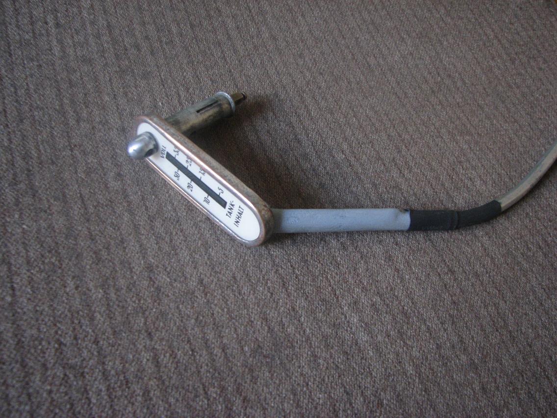

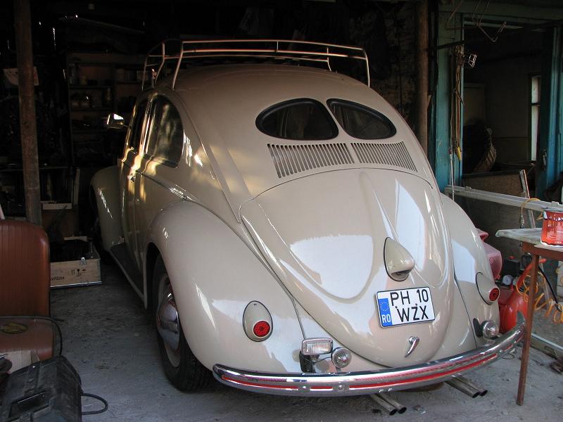

after a month of pause, the split is in the garage with the Fiat, its battery sleeps with me in the bedroom... Laughing
as updates, i traded the zwitter carb and fuel pump for 8 mm split fuel pump and 26VFIS carb, i added a Dehne fuel gauge project to the split project and a Dehne sender project to the Dehne gauge project (sounds confusing, right? Laughing )
Andi Oval56 was providing a 51/52 dehne face for the gauge, wonderful quality, i repaired the cable and bowden tube and that's all. i can't wait to drill the split dash! Evil or Very Mad
i got 2 rear original cloth panel, so now the hunt is on for a complete split interior, maybe in time for Hessisch Oldendorf 2013.
i traded the bosch early fog light for a Bekowa 6 slat roof rack, got the bumper guards to a rechrome shop, hope i get them done ok.
a new challenge for 2012 is on my list, Austrian Alps. for that in the menu we have nicely done or redone brakes, right side mirror, Dehne fuel gauge, roofrack, Becker Monza clone radio and soon to be, a headliner net to keep the needed maps Wink
