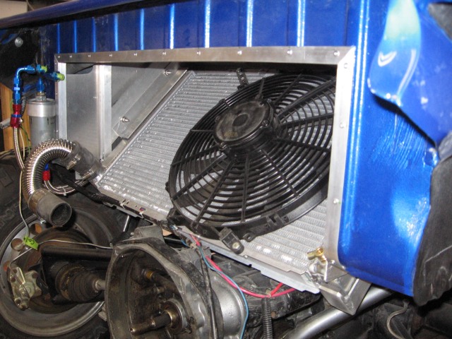

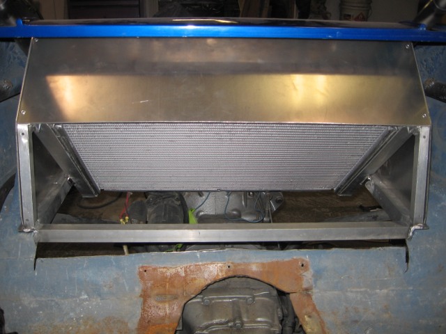

I got a little more accomplished on the motor swap. I finished up the radiator rack/ductwork. It is sheeted with .090 aluminum. When all was said and done, I think I could have gone a lot lighter duty on this part. It is pretty much bulletproof.
(note the rack is just sitting there. That is why it is crooked, SCOTT! Rolling Eyes )

I also pulled the motor (hopefully the last time) and cleaned up the firewall opening. I also started to finish up all the plumbing and get a head start on the wiring.

OK, so that final "motor pull" was wishful thinking. I threw it back in the car to finish the mock up. At this point it gives a pretty good idea what the final product will look like. The only missing parts are the engine cage and a few accessory items. Hopefully this weekend I will R&R the motor for the last time, button everything up and start focussing on the fuel tank and pump. After that, its "Wrrrrrrr Wrrrrrrr baaaaaaruuuhhhooooom". Wink

SHMO very nice fab work. I have two question's and I know you have it all figured out no doubt. I see the fan pushing air thru the radiator. Where do you have an exit for the air the fan is pushing? Is there a reson for the fan not being on the inside pushing the air towards the engine? Reason I am asking is because I may go water cooled on my next project.
Fans normally pull air, not push, although some can go both ways...like SHMO. Laughing
