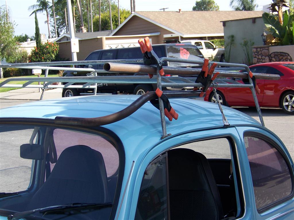

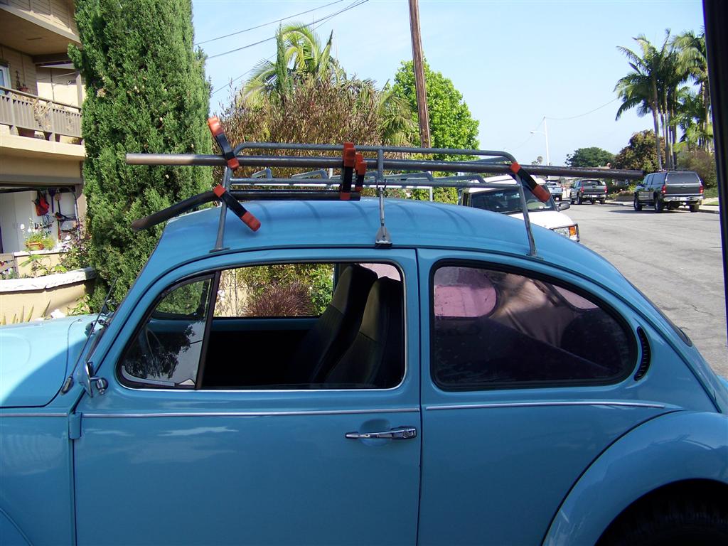

Roof Rack 101: The Basics
I used a standard VW rack as the base for the new one. This way I could clamp tubing to it and back up to see how it looked. I made the lower hoop to fit inside the legs of the stocker, added some temporary legs to the new section to hold it in place and then unclamped and lifted off the stock rack. From here I added the top section, center runners and new legs. Total weight is about 35lbs, without lights, using all .065 wall mild steel. I tack welded most of this with MIG and had to throw a blanket on the roof to keep the sparks from burning the paint and sticking to the windows. When it was all tacked together, I pulled it off and welded it on the ground. It came out perfect, no twist, everything straight and level. Smile

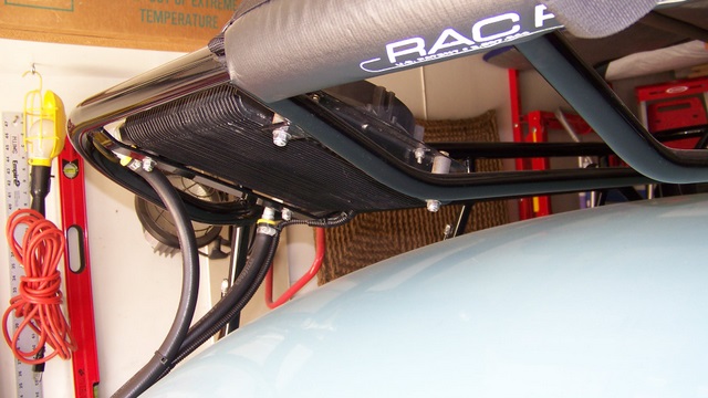

I got the oil cooler mounted in the roof rack. Everything is working good - still a bit sloppy on the freeway, but not anything to worry about.

Your not worried about getting oil everywhere when you take the filter off?

As for the oil, I have a plastic container that fits in there to catch the overflow. I just cut away enough from one side that I can slip it in there and then be able to twist the filter.

Will the oil cooler get hot enough to cause damage to a board-bag, or worse, a board?

No worries on the heat, boards go next to it. Plus the wind is blowing right through it so it doesn't get too hot.

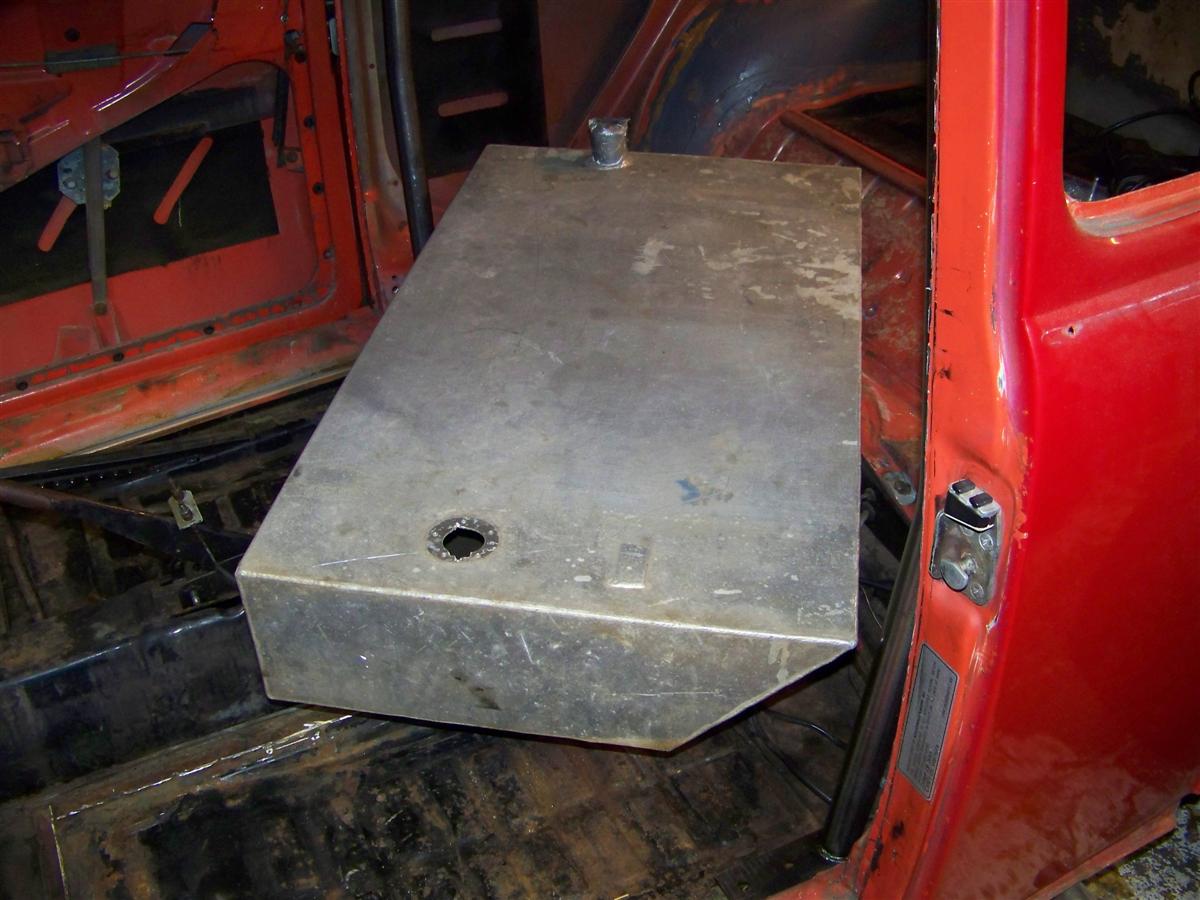

Thinking about a full size spare in the front, so I think I'm going to build a gas tank for the rear like I had in my last car. Maybe pull out the stock tank and make a storage box/battery tray to move the Optima up front.
Then skid plates and side bars when the cage is in.
Here's some shots of the 20 gallon tank I used to have:
