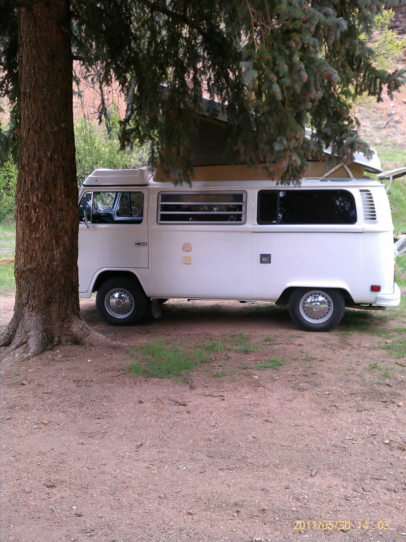

Here are a few shots of our first day trip in the Westy with the Subie engine in back. We drove from the front range up through Conifer, CO and down into the Buffalo Creek area. It felt great on the steep and sustained incline from Denver to Conifer and was a blast to drive (still smiling). Next project is sound proofing and insulation! Even with a subie motor, it is still a metal can inside...
Parked for a picnic:
