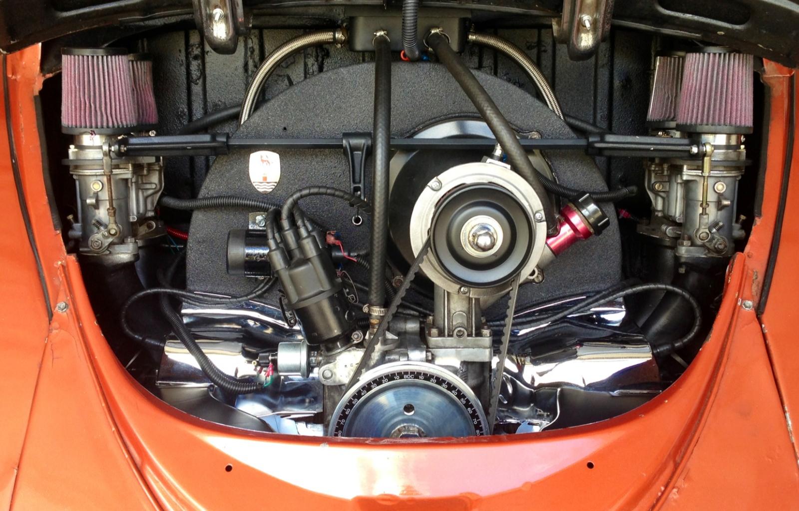

So Here is my 65 bug. Long story but i bought this little beauty and after about a week the motor blew up. I am new to the VW community but not to motors. So with advise from A local shop owner and lots of time in the garage and on the Samba. Im done so here she is.
ENGINE:
2110cc stroker,
As41 dual relief full flow case,
CB performance Forged/counter Balanced 82mm crank,
CB straight cut cam gears,
Recondition 311 rods ARP bolts,
AA forged 90.5mm cases and pistons,
Engle Fk8 cam with eagle cams,
Dual valve springs,
Epco heads port/polish 42x37.5 valves,
.040" coppeer shim makes for 9.5:1 C/R Dual HI Rev springs,
Forged 1.4 rockers with chromoly push rods,
1.5 sump,
009 dissy with comu-fire electronic ignition,
Dual webber 48 IDAs (Still playing with the jetting)
Lightened flywheel, kennedy stage 1, 4 Puck
Ceramic Bugpack 1 5/8" w/ Mondo fatboy
Runs awesome. I never new these little motors could be so fun and fast. No dyno papers yet but its snappy. Only about 300 or so miles on it. Nice long drive today(50miles) oil temps around 200 degrees. Filters are on for daily driving. Couldn't fit the king kongs so I had to modify.
Video:
Trans is a Built pro street freeway flyer, super diff and welded 3/4.
1st-3.80
2nd-2.08
3rd-1.43
4th-1.04
Pinon-4.37
Still more work to do but im loving it. Might be my first but wont be my last.

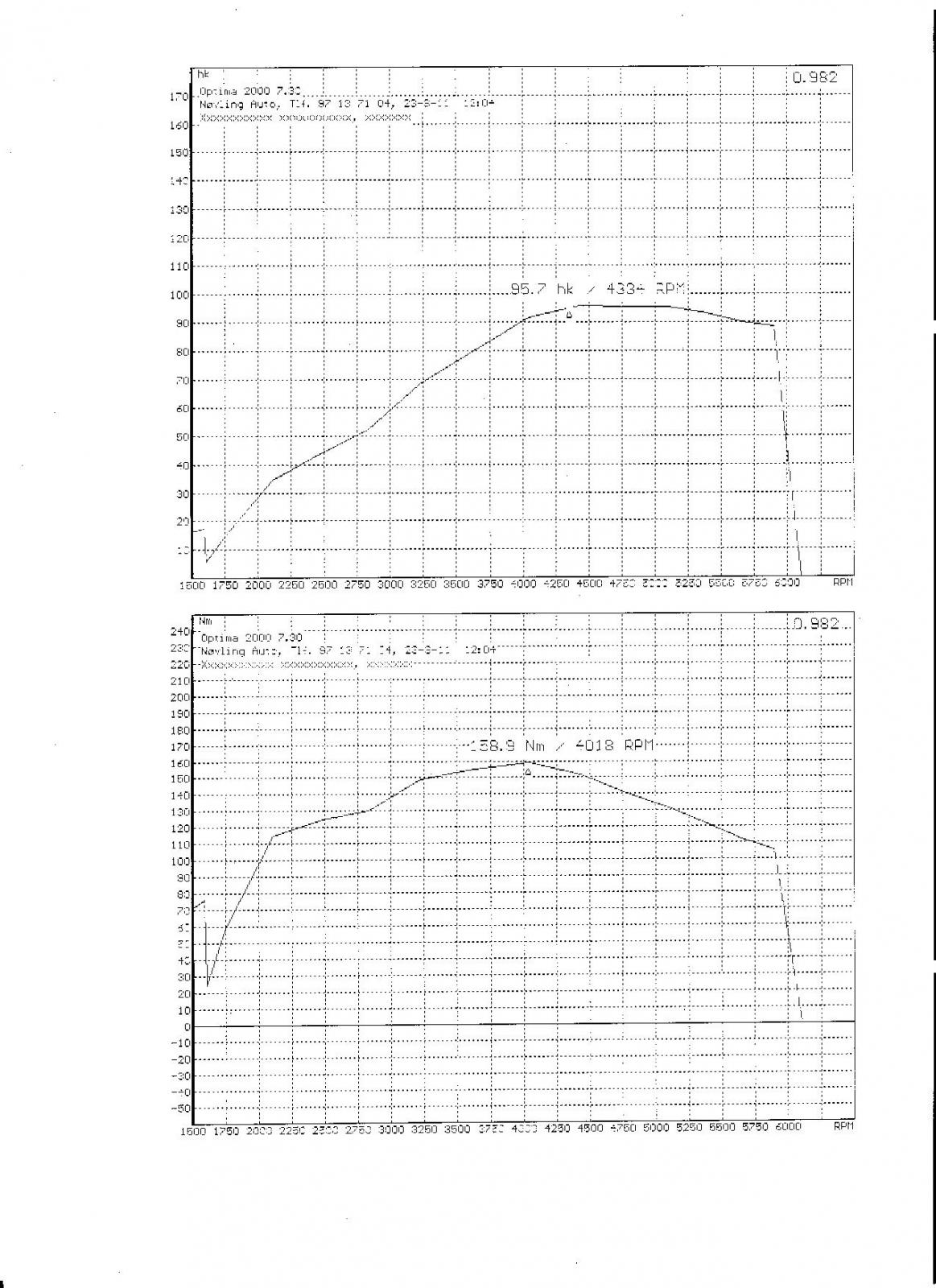

2017 stroker built by Art Thraen and the guys at A.C.E. (now Blackline) This is for my '71 Westfalia with original gas heater...
75HP peek @4500 then it plateaus... 120.75 LbTQ @2800RPM .... and don't forget this is with a single solex... I'm very impressed, and happy. Thanks guys!

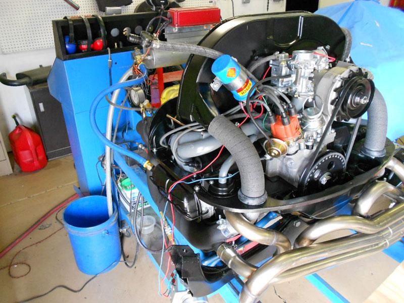

Here's my 2110 build - the 2110 is probably the most often built 82mm stroker there is. For good reason - it tends to hold up very well over extended periods. This is my second 2110 build - wish I'd kept the first one!
Bottom End:
Case VW AD case AS-41, machine work by RIMCO
welded #3 web with deep stud (stock) - OS main saddles first cut - standard thrust - case was nearly 'virginal'
CB 82mm 4340 crank P/N 1154 & 5.5" 'H' rods P/N 1290
KS steel backed main bearings
Clevite rod bearings
Mahle 90.5 stroker forged piston/cylinder set standard ring kit
Sand seal machined - EMPI 7" black degreed pulley - we'll see how this works out - so far so good - a check for TDC showed it to be less than 1/2* off
factor 8mm stud inserts - CB chromoly studs nuts & washers
Valve Train
CB 2242 cam with 298 deg duration - 248 deg advertised with .389" lift at the cam - .486" with 1.25 rockers
CB aluminum cam gear - Engle lifters - Manton chromoly pushrods - CB 1.25:1 rocker kit solid shaft
Cam has a relatively gentle (slow) ramp and should be kind to the lifter bores of which all were near perfect - lifters fit tight with no observable side or up-down motion
Oil system
CB full flow 26mm oil pump (Shadeck) - standard remote mount oil filter kit
OG type 1 doghouse cooler - new stock oil control plungers/springs
CB 1.5 quart sump with drain from L/H valve cover to sump - visit Muffler Mike's website to see why I've done this
http://mufflermike.com/news2007.html
page down to the 1-18-2007 entry - this will explain why you should do this if you experience low oil pressure when you get on your engine for even brief sprints. No oil? - soon no engine!
Blowby control will be handled by a CB oil tower with a pair of vents from right hand valve covers channeled to it
Oil is Valvoline Racing oil - 10w-30 - also added for cam break-in was cam break-in lube from CB - so far in about 400 miles there have been no funny noises coming from the valve train - just that click click from the Manton pushrods - runs very nice!
Cooling system
Stock doghouse shroud with NOS 35mm fan - used OG thermostat flaps with OG thermostat - type 3 cool tin in black (working very well too) - Since there are no heater boxes the stock heater vents coming off the shroud have been cut off and a flat plate welded into place
Exhaust
Bugpack 1 5/8" merged header with Mondo muffler - not as loud as I was expecting and it sounds great
Induction
Dual EMPI HPMX 44mm (Weber 44 IDF clones) set up and test ran by ACE and Art Thraen in Salt Lake Ut - CB Performance linkage - ACE throttle springs - all sitting on CB style offset manifolds
All fed into CB Los Panchito heads with 40x35mm valves and dual springs - mild polish job by your's truly - intake manifolds have been hand matched to heads - gaskets reworked to clear interference
Ignition
is an aircooled.net SVDA 034 with points - fed vacuum by both carbs with a 'tee' - very drivable even in low rpm situations - no bog!
Other info:
All rotating and reciprocating parts have been balanced to within a gnats ass (or two).
Deck height adjusted to .042" with 59cc heads for final compression ratio of right at 9:1. Originally I was going for 9.5:1 but I thought better of taking deck height down to .025"
Dual HPMX carbs work awesome - and feed vacuum signal to an aircooled.com SVDA distributor with Pertronix point replacement system - coil is a standard 35k volt unit
Flywheel is a 12 pound forged unit from CIP1 - and clutch kit is the standard Kennedy 1700 pound stage 1 with solid disc.

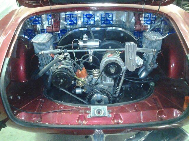

Target was for a daily driver 71 Karmann Ghia on 89-91 pump gasoline - no ethanol - I have several stations in my area that are ethanol free --- RPMs should top out at 6500 but I haven't had it there yet - my goal was for around 130hp - my 'seat dyno' tells me I'm right there - Engine feels strong and pulls very well even in the lower rpms - I've had it to ~4800 so far
Here's a picture of the finished 'product'. And yes - you see an A/C pump sitting on the L/H side - a Gilmore unit - Works pretty damned good! It gets to 90+ on a daily basis in summer here - If I was planning on driving this car much it needed A/C - with no heaters that mandates parking the car for about 3 months of the year when its just too damned cold - seldom gets above freezing for a few months during winter
And a utube video ==== a couple days after the 20 minute cam break in. The guy in the video is my nephew who "just had to put it on utube". He did the body and paint - very nice job too! I did all the motor work.
So far with temps in the 95* range the motor runs very cool - head temps haven't gotten past 310* - oil temps of 190-210 show the 10-30 oil to be a decent choice
I couldn't be happier with this motor - unless it could sh*t dollars!
71 Ghia Coupe - stock body - no rust! Powered by a 2110 W/Dual HPMX 44's - Rancho Pro Street Transaxle - A/C by Gilmore

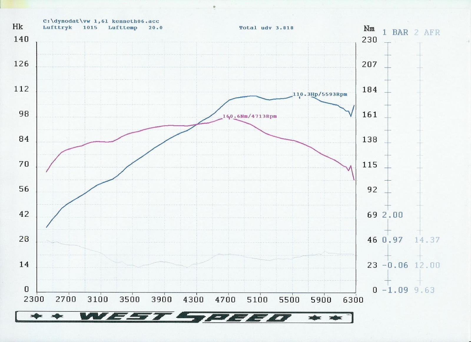

Here is a dyno sheet from a recent 1914 that I rebuilt for a customer:
New Mag case
Counterweighted 69 mm crank (Old bugpack)
CB Unitech rods, balanced +/- 0,5 gram. "356" oil groves
Engle W110 cam (delivered by customer)
CB lightweight lifters.
Manton pushrods.
94 mm Mahle pistons in AA cylinders. Pistons balanced +/- 0,5 gr. 1,1 mm deck height.
044 heads ported to something close to a CNC round port size. (156 cfm @ 0,600 at 25", with Misab manifolds. 9-1 CR.
Stock rockers.
26 mm shadek oil pump, blueprinted. Full flow. Stock late model oil cooler + another type 1 cooler (thermostatic controlled) located just behind the torsion bar housing, with an air lead plate.
Lumenition electronic ignition in a rebuilt SVDA distr. set at 8/30/38 degrees.
Dual 40 Dells w. 32 mm venturies. (Had 34 in it, but it did´nt do squat, so returned to 32) (Also tried with 2" stacks and was able to pull 180 Nm torque with them, but there was not enough room for taller filters, so I used regular 1 5/8" stacks)
1½" TurboThomas sidewinder header, 2 2" Simons mufflers in line, one on each side of the engine. Nice and subtle sound.
Measured on a Dynomet Chassis Dyno. Numbers are at the flywheel.

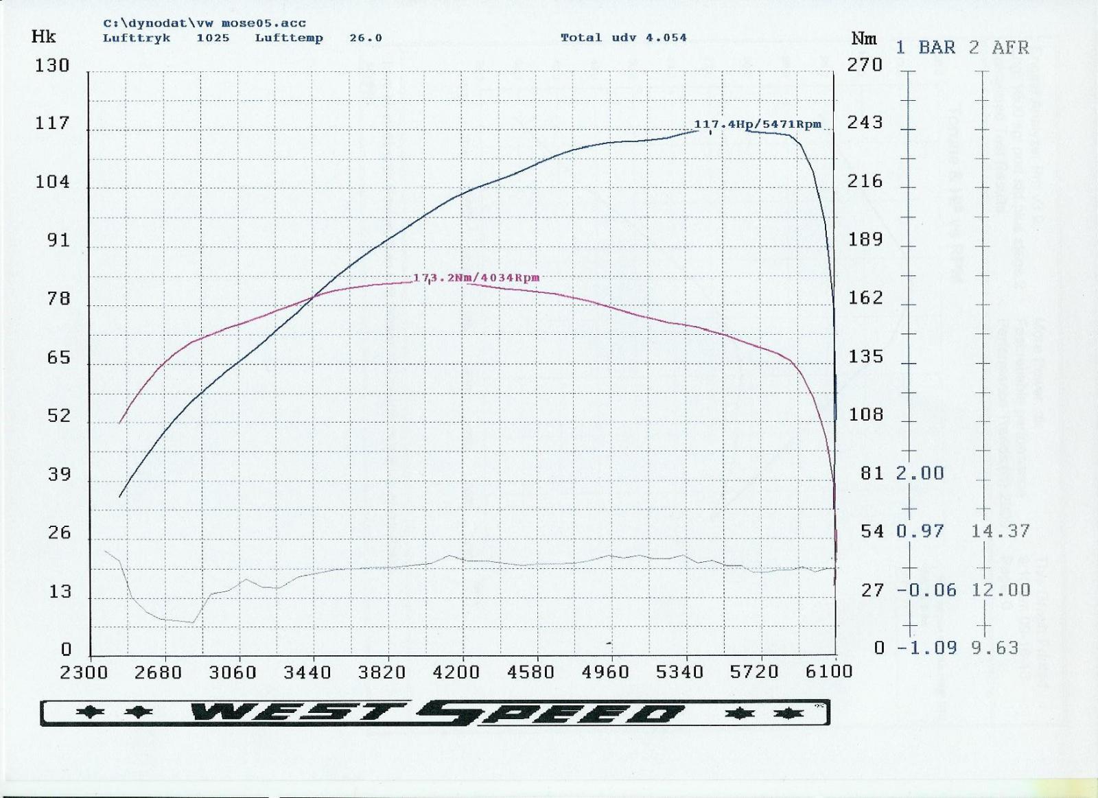

2180 cc type 3 engine
New Mag case.
CB 82 mm crankshaft.
5,4” Race rods H beam. 356 style oil squirters.
92 mm thick wall AA cylinderset. 1,2 mm deck.
Web 109/110 camshaft. CB lightweight lifters
Manton pushrods.
26 mm Shadek O ringed oil pump, blueprinted. Full flow.
043 heads, 42 x 37,5 mm valves, D port. 182CFM @ 0,600” and 25”. 9,5 – 1 CR.
Stock rockers on bolted shafts, Porsche style adjusters.
German 009 distributor w. Ignitor module. Pertronix 3 ohm coil.
42 mm DCNF carburettors on Berg type 3 manifolds. K&N airfilters.
CSP Python exhaust system. 1 5/8”
Power is a little stiffled due to only 10" of intake length. But still pulls quite nice.
146 hp @ 5200 rpm.
225 Nm @ 3750 rpm peak.

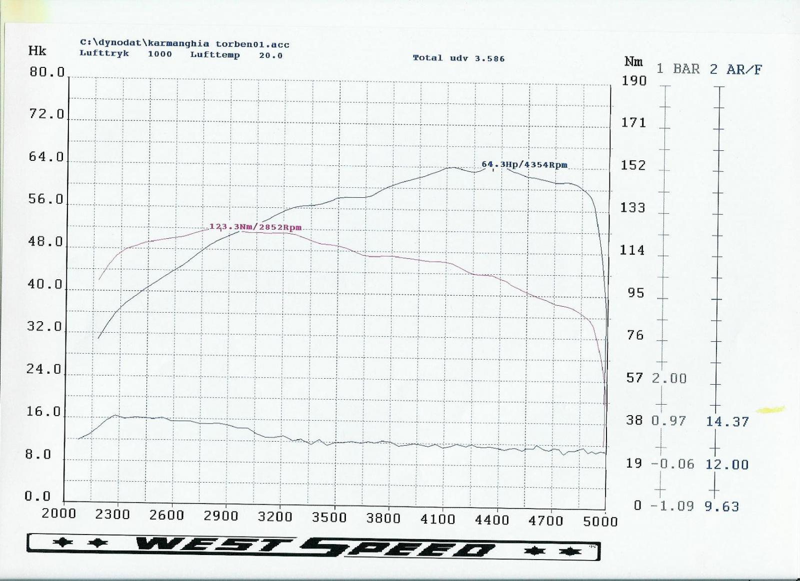

VW 1600 single port stage 2.
Completely stock appearance.
69 x 85,5 mm. Fully balanced.
Stock 200 mm flywheel.
Stock clutch.
Rebuilt stock rods balanced +/- 0,5 gr.
CB 2280 camshaft, stock german lifters, stock pushrods cut to length.
26 mm shadek oil pump.
Sgl port cylinderheads, 35,5 x 32 mm. Ported to 30 mm inlet, guides shortened 6 mm. cut back on intake valves, 8,5-1 CR.
Rebuilt Bosch 205 SVDA distributor w. Ignitor module. Blue Bosch coil
34 mm PDSIT carburettor on CB center section. Empi sgl port end pieces.
Stock heater boxes, stock Ernst muffler. Stock ´68 Ghia 1500 air filter.

PostPosted: Fri Oct 11, 2013 12:43 pm    Post subject: Reply with quote
1914 std plus 95 hp.
Engine case linebored.
Stock german crankshaft 69 mm.
200 mm flywheel lightened 1 kg.
Stage 1 pressure plate, stock disc. All balanced together.
26 mm Shadek oil pump, Full flow. Stock late model oil cooling plus another thermostatic controlled stock oil cooler mounted behind the left torsion housing.
Unitech rods, balanced +/- 0,5 gr.
Raptor 07 camshaft. (240 deg. @ 0,050"/433" on intake. 0,393" on exhaust.
94 mm SS pistons
040 cylinderheads ported & polished, stock valves (35,5 x 32 mm) cut back on intake. 10,5 - 1 CR.
ACN Aluminum push rods.
009 distributor w. Ignitor module. Custom advance curve.
CB center section intake manifold modified for 38 mm throttle.
38 mm Solex PDSIT w. 30 mm venturi.
Stock late model air filter (the plastic one) with K&N air filter. Cone shortened 1½"
Custom made end pieces with 32 mm I.D. and 1" longer than stock for better idle quality.
1½" heater boxes. CSP Street sport exhaust system.
95 hp @ 4300 rpm.
158 Nm torque @ 4000 rpm.
Runs very cool and is rather efficient. with a 3,88 R/P and 0,89 4rth. It easily makes 34 mpg on a 75 mph cruise.
Dynoéd on a Bosch Optima 2000 dyno.
