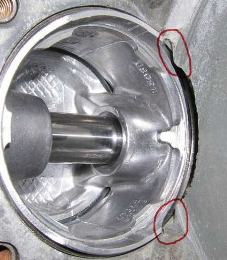

I had the same problem but all of my pistons hit.
I just worked the case because I was uncomfortable cutting and weighing my new pistons equally.
I did make a cool template though.
Here is how I intended to cut the pistons:
I marked the areas to be removed in black.
All said, if I was consistent with my marking and cutting, the pistons would have probably been close to 'as balanced' as they were at first.
