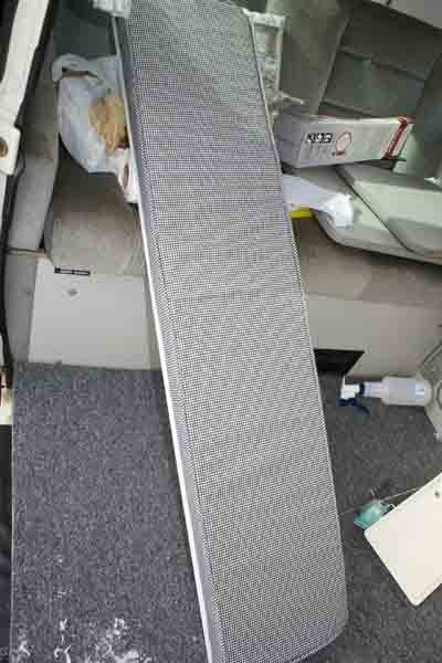

Dogpilot
Joined: October 03, 2005
Posts: 4205
Location: Flagstaff, AZ
Dogpilot is offline
PostPosted: Sun May 31, 2009 9:52 pm    Post subject: Reply with quote
I made mine like this from some ply bits I had around. I offset the brace to clear the vent tunnel:
