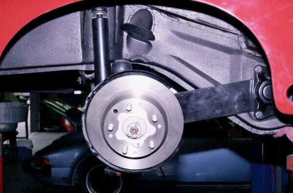

My project car is a '56. PO's were building a race car and installed a '61 transmission with what looks like Porsche 356 C disc brakes all around. The bottom rear shock support goes out to the rear of the axle instead of the front and I can't visualize how to get a shock on there. Anyone here have any ideas or seen this setup ?

Swap axle tubes from one side to the other . The 356 either has a different upper shock location , or they are installed backwards . If you haven't bent the metal brake lines you might switch the brakes to the other side as well (put the caliper to the rear of wheel , not front as it is now) TROY

you are correct that those are 356C rear brakes and axle tubes, YES the porsche parts are a direct "bolt on" to a swing axle beetle! since 356's have the shock mounted to the rear of the axle you cannot "bolt"
shocks directly in a beetle when using this setup...BUT you can fabricate brackets to replicate the stock type beetle shock mounts then sandwich/bolt them in place using the 3 12mm springplate bolts ! .. you can cut off the un-needed porsche hangers ..or just leave them in place as they wont really be in the way. just remember, IF you decide to cut the no longer needed 356 shock hangers off of your axle tubes you will be making them useless to any potential 356 owner ..IF you ever decide to sell them! 356C brakes are pretty desireable and valuble(porsche guys often use them to "upgrade" earlier drum brake 356 cars)

Looking at the pics again and reading everones posts , the holes won't line up swaping sides or twisting the tubes (sorry brain fart). If the brake brackets will bolt to beetle tubes fine , you could go that route or build some upper shock mounts like Cameron said . TROY

Hi Teeroy....... I agree that swapping and twisting won't work, but what I got from reading Camerod's post is the fabbed bracket would be the Bottom mount, not the top Question ....... ie: Use the top stock VW mount that's there and Fab a new bottom mount that goes out towards the front like stock, to replicate what's missing. This would allow you to cut off the 356 bottom mount going to the rear if you had a mind ( or no mind ) to do so. ( NOT recommended )
..you got it!
troy, the caliper brackets are cast into the bearing housing so you unfortunatelly cannot bolt them to the beetle tubes..

For those interested, from another site, here's what a stock 356 C set up looks like.
