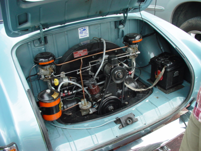

Hello,
I have opportunity to buy a complete 1200cc VW engine with a 1400cc
Okrasa kit. I make the deal but I have a big problem ! This engine was
on a Beetle and my car is a 63’ Karmann-Ghia Type 14 convertible or
you know it’s impossible to closed the engine lids !
In fact, I want to find the two angled aircleaner tube. I want to buy it or to rebuild them. Do you know someone who accept to send me pictures or measurements about this ? or may be do you know someone who rebuild this ?
Thank you in advance for your help !
Regards, Cyril

PostPosted: Sat Sep 17, 2005 3:33 pm    Post subject: okrasa carb intakes Reply with quote
Here are some pictures i have been collecting of the bent intakes.
There are a number of variations.
you can also use mushroom aircleaners, though they are not "correct"
