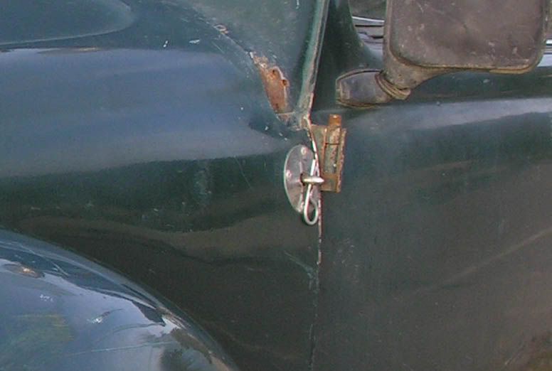

what has everyone done to hold down their one peice fiberglass front end's? I wanted to go with draw latches instead of what I have now. I would like to see what other people have done, even if its the same thing I've got. If anyone does have a draw latch set-up could you share where you bought them please!

Thats what most people have actually (like in your pic) But some have the rubber pulls... I don't have a technical name for them, but its the came thing on most Bug-Eye kits on baja's.

I use Dzus fasteners.

Dzus fasteners! i like it! and cheap!

Fastners... whatever you do .. if it has tension on it it needs to be reinforced. I've bout several pieces of fiberglass pulled apart because the fastening devices weakened the plastic.
Creative idea. I've always wondered about a latching system that would pull from the inside and snap.. would take some cable engineering... would be nice not to have it exposed to the outside.... Just wish I had the McGyver in me to figure it out.
Pins or Dsus...

Not that it is terribly relavent with Baja bugs but something to consider with other projects.. NHRA and other racing orginizations are considering either banning or limiting use of Dzus fasteners on race cars. There have been many fires that went out of control due to either too many dzus fasteners or the fact that they are difficult to remove in a hurry. Basically what was a small fire progressed to full engulfment in the time it took to get the hood open.
I prefer the hood pin set up and would go that route if my 1 pc wasnt already drilled out for dzus fastners. Also, make sure when you buy dzus fasteners..you specify fiberglass mount fasteners. They are much different from their metal counterparts.

Anyone ever tried to adapt Jeep latches? They'er so much better made than the rubber junk sold to VW folks...
Notch the fiberglass around the latch base and screw it to the metal underneath?
