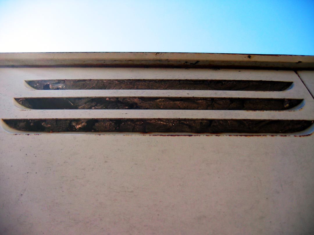

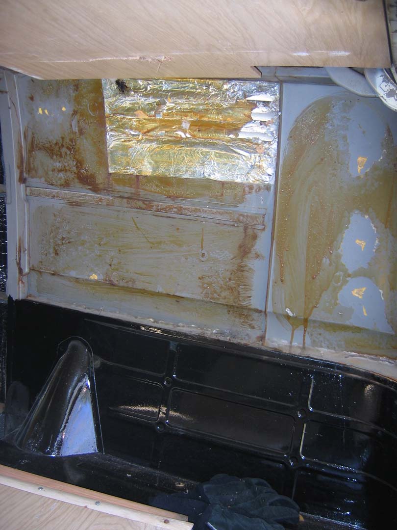

I am questioning the significance of the upper rear vent Confused. Mine were covered with foil and insulation. How should they be presented? What is their function? Should I recover them as they were or leave free to ventilate?

are you converting it back into a panel? If you are keeping it as a camper, its best to leave the foil in place.

their function is to let air from the outside come in and let air from the inside go out!

I'm keeping it a camper, of course (to my knowledge it never was a panel). Rizzag - If they are supposed to ventilate, why are they covered with foil & insulation?

because it was converted to a camper. you dont want bugs and stuff gettin in while you are in there.

or water leaking on your camper interior.

Go to the post office and pick up one of the large priority envelopes.... not the cardboard ones. They're made of tyvek.
Tyvek is great , it will let moisture out but not it. It's used in most houses built as a moisture barier.
I know it sounds cheap to use what you can get for free from the post office. If your against "stealing" from the post office you can just go buy a roll. Last time I checked it's about $340 a roll... and you'll have a little left over. Probably enough to do 300 to 400 busses.
You'll never see it because it's under the paneling, and I guarantee it'll work better than whatevers in there now.
You want you camper to be able to breathe! Unless you prefer waking up wet.
