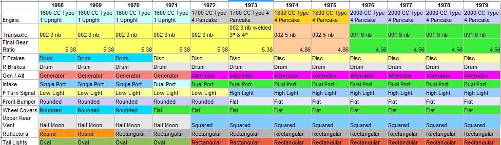

Link to the timeline:
Bay window timeline
Why I only looked at a '73 or later bus:
73 Beetle, Ghia front brakes, Type 3 rear brakes, 1776, Solex 34 Pict-3, Bosch SVDA, '97 Mustang seats

PostPosted: Wed Jul 14, 2010 10:51 pm    Post subject: Reply with quote
ummmmm.... that timeline is wrong....
i know that-
1972 had an alternator
1971 had oval tail lights
and
1973 had the turn signals up high, not down low
thats all that i noticed... there may be more, i don't know...
