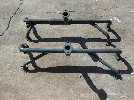

Wiggy
Joined: April 17, 2003
Posts: 6606
Location: Downingtown, PA
Wiggy is offline
PostPosted: Sat Jan 07, 2006 12:50 pm    Post subject: Reply with quote
wolfsburgvw wrote:
so what is a k manifold,as to the untrained eye they do look the same,steve.
Its the one on the bottom.
Then there is the jacketed k manfold which is actually for 51-52, MUCH rarer.
This one is mine.

johnshenry
Joined: September 21, 2001
Posts: 9417
Location: Northwood, NH USA
johnshenry is offline
PostPosted: Sat Jan 07, 2006 1:48 pm    Post subject: Reply with quote
The pics above show the K, the jacketed and unjacketed. The jacketed K manifold has no VW part number on the jacket.
I can replace the heat riser legs on the jacketed Ks. Pics of that operation at zarwerks.com

johnshenry
Posts: 9417
PostPosted: Sat Jan 07, 2006 5:27 pm    Post subject: Reply with quote
wolfsburgvw: Does that manifold have a part number on it ending with "701E"? Probably does.
Jacketed Ks have symmetrical aluminum jackets.
JH
