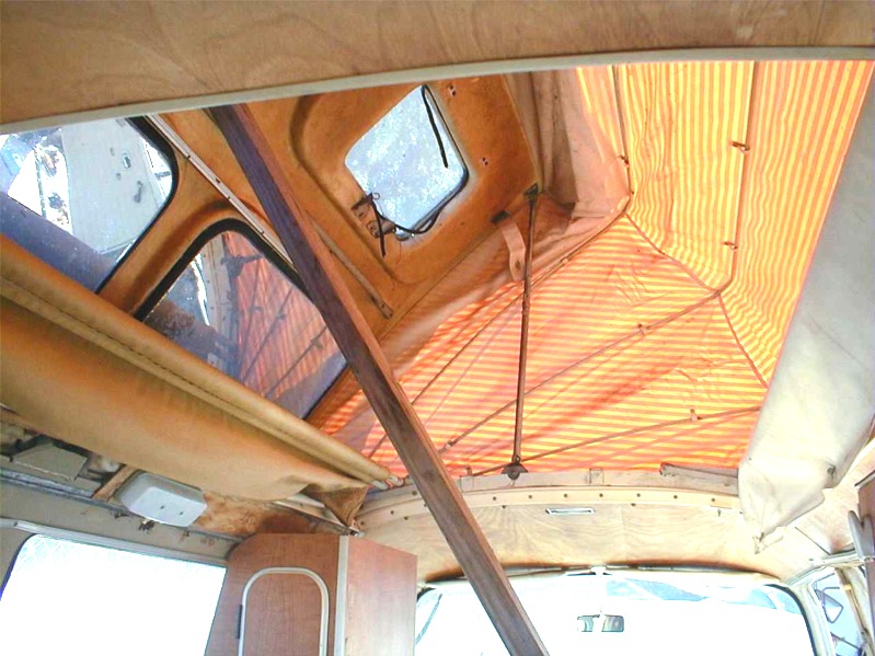

Do a search for my pictures. Some there will give you good clues. Also, please post some pictures of what YOU have. Then we could help you out a little better. Wink

Looks like at least it has the spring loaded support for the top. Open the top and take some pictures. From that we can determine pretty much what you have and what you are missing. Does it have the "ribs" that hold the vinyl( it isn't "canvas") open? Confused

If the Dormobile top came installed on that bus, and you were "missing" the rib mechanism which you now just acquired, then it should be a pretty straight forward install. Otherwise you'll need to make really sure you are installing the ribs in the proper spot in order for them to operate correctly. You know what I mean, right? Confused

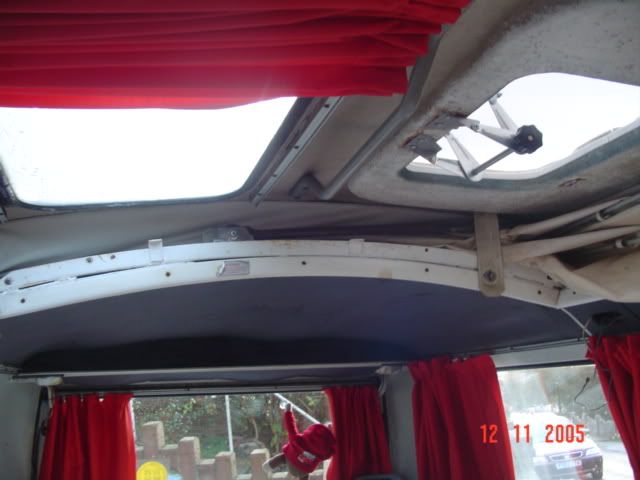

BTW, that picture is of my Dormy top as it was, where it was(a '69 fatchick) when I first got it. I then installed it myself on the '65. Major project, not for the faint of heart, but if I did it, anybody can! Laughing

Pics of the roof on my 71 Dormy.
And here is my bus...

paulandemz71bay - thank you so much for those pics! exactly what I was after, and now I'm worried that I might have a lot more to do than I first thought! haven't got the metal framework things yet so I don't know if it comes with the brackets to attach it to the roof or if I'll have to get metalworking! anyway, if I can get my heap looking half as nice as yours I'll be more than happy, thanks again! If you ever go touring in Northern Ireland give me a shout and you may find a few decent runs that would be worth going to!

Hey no problem, I took these pics originally for a guy I met locally who saw my van, he'd bought a dormy roof with the same idea as you. If you need any more specific pics give us a shout. Very Happy
