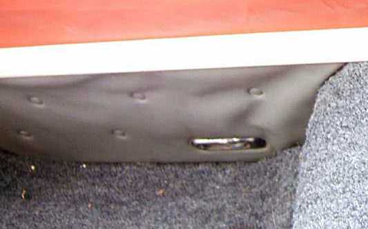

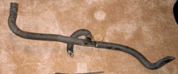

I talked about this in a thread recently after 62Shawn asked. I'll quote:
It was 1962 that had just the passenger side having a heater outlet, which was a hole in the heater duct, where a small pipe attached to it. On this, a mult-ply paper hose, that was about 28mm or 30mm in diameter pushed on to it, went past to the battery, then to splittler then down to a heater outlet on either side of the "hump" towards the center of the car.
The hoses were clipped, by the way, to the "bar" under the back seat and the center tunnel, with some bendable sheet metal tabs.
Here's a pic from the factory owner's manual:
Here is pic of those hoses, outside of the car, from a pic of parts I had gathered when I first restored my 62 in the early 90s:
and here is a couple of pictures from inside the car. I have these hosed siliconed into the vent outlets to keep them in place. and the hoses are getting to be in pretty sad shape, note the duct tape.
The oval vent outlet tubes are welded to the floorpan.
-Andy
