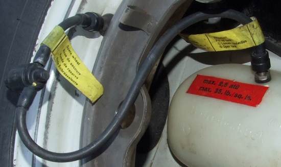

Posted: Fri Feb 24, 2006 3:18 pm Post subject: |
Here's the bottle in my '67. It is identical to the one in my '65 except the label is yellow. You can see the air valve just to the left of the filler cap. That's where you would pressurize the container to about 35 psi with an air hose or the connector to the spare. If the regulator for the spare tire connector is working properly, it will cut off the supply from the spare at 18psi so the spare didnt go flat.

A page from a 1963 owner's manual describes the stock system:
http://www.thesamba.com/vw/archives/manuals/63bugowners/page20-21.jpg
and yep, the hose that connects it to the spare tire was only an accessory. Some had a provision that had another tire filler valve on it that allowed you to add air to the tire without unhooking the hoses, others did not. The one shown in the old Bentley workshop manual has the extra fitting on it, I've not seen one of these in person:
The accessory hose that I have in my 62 is the other style.
