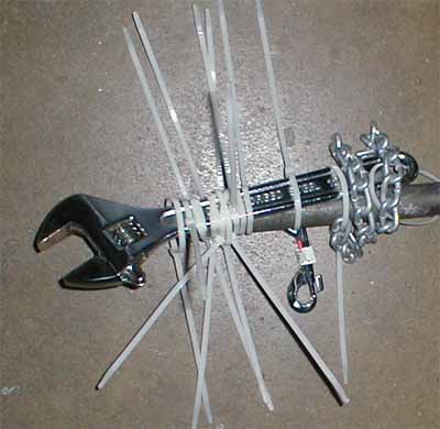

NOT mine but I found this in the gallery ... Appears to be set at 36mm for removing those early castle nuts
Beauty is in the eye of the key holder ...

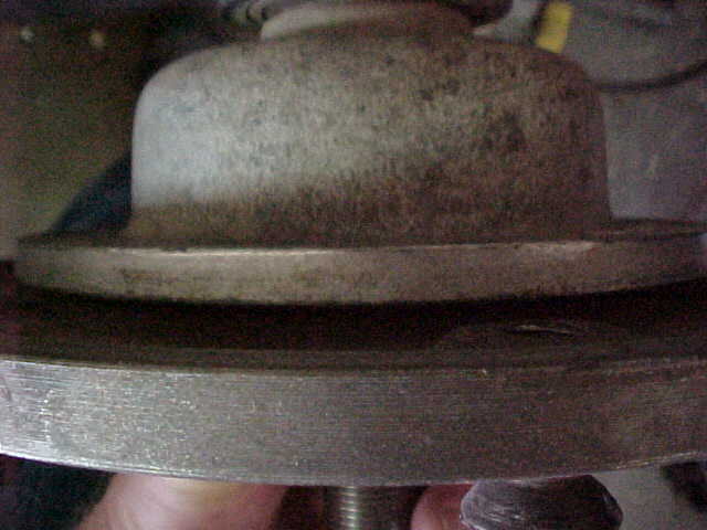

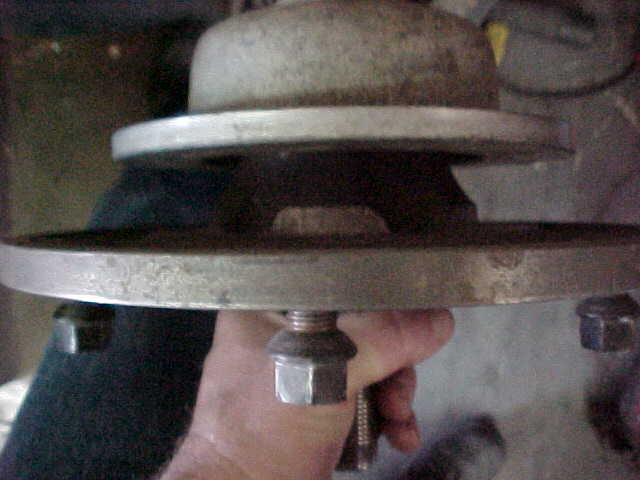

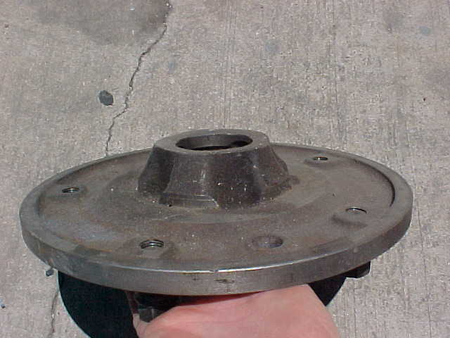

Made a wide five wheel balancer adapter out of an old 69 bus front drum.
that looks like something i would do.. Laughing
wow! that's rigged! Those zip ties are pretty strong though, when you gotta get it done, that's how you do it!

Rusty but trusty! 36mm socket welded to a length of solid steel.
No zapstraps were harmed in the making of this tool Wink

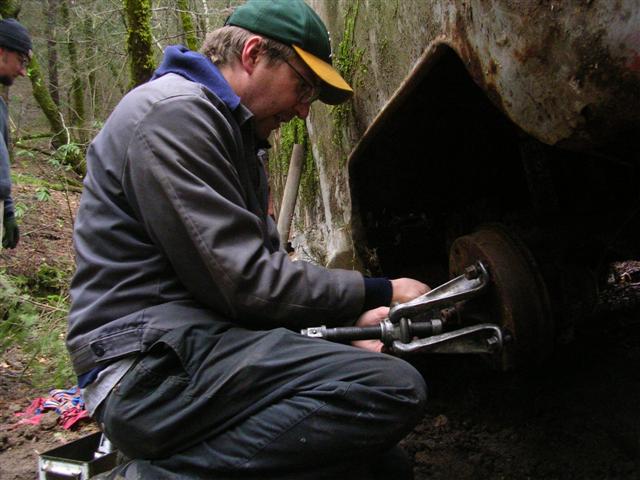

Here are a few
Brake drum puller.
Torsion beam bearing puller.
Bearing cap puller for reduction gear boxes.
Steering wheel puller.

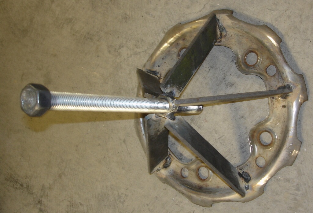

I was in a hurry, so I made a hubcap clip riveting tool rather than wait for one to arrive.
