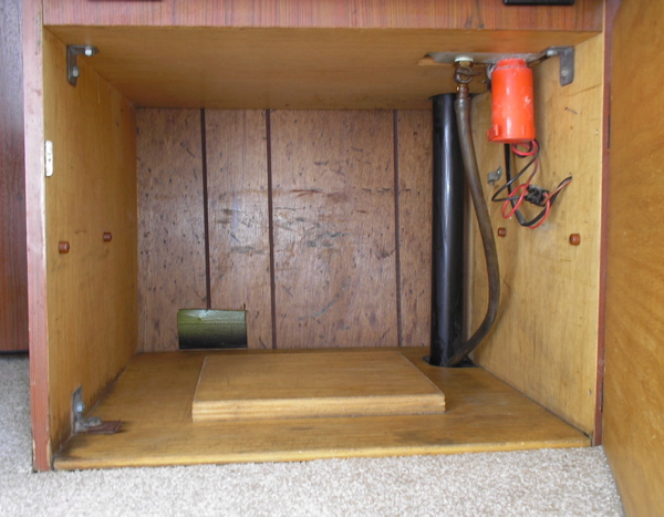

Posted: Thu May 18, 2006 2:22 pm Post subject: |
Here ya go. Hope these help. There may be some small details that aren't completely original, but it's very close, eg. collapsable tire is gone, support strap is replaced, the PO did something funny with the siding. The camera has a way of finding dirt and stains I haven't noticed before. Gotta reach in a little further with the furniture oil-on-a-rag.
1974 Westfalia sink watertank faucet upper cabinet
1974 Westfalia pump, sink drain, tank drain with brass valve (dirty clear plastic hose), lower cabinet
1974 Westfalia drain and vent pipes, fresh water hose (black), wiring from faucet to pump
1974 Westfalia underside of sink and faucet, water hose, wiring, top of tank visible lower left
1974 Westfalia underside of watertank, pump with black freshwater hose, brass valve with tank drain (clear plastic hose), wiring

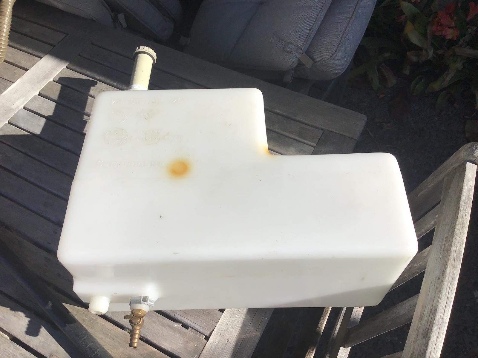

I have a water tank I pulled out of a older van quite awhile back. I am cleaning my shed out and listing parts I don’t need. But I noticed that the tank I have has the water pump and drain located under the tall part of the tank instead of under the narrow part like seen in this post. So now I am wondering why and how to list it. Is this not a standard 70’s westfalia tank? Why would it be reversed? I can’t find many photos online or much info on these. Any help would be appreciated.

Mispeld Samba Member
Joined: April 29, 2018 Posts: 366 Location: Jacksonville - Coastal NC
Posted: Thu Mar 12, 2020 1:50 pm Post subject: Re: 1974 westy water tank |
My 77 westy has the fittings like yours in the back under the long side. It slides into the cabinet with the long part in the rear, and the shorter part facing you. _________________ Tom

Midreal Samba Member
Joined: April 28, 2017 Posts: 24 Location: California
Posted: Thu Mar 12, 2020 11:56 pm Post subject: Re: 1974 westy water tank |
| Mispeld wrote: |
| My 77 westy has the fittings like yours in the back under the long side. It slides into the cabinet with the long part in the rear, and the shorter part facing you. |
Awesome thanks so much for the explanation. Really appreciate the post 👍 |
