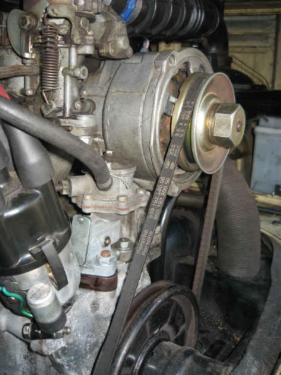

As you can see ,i drive with an original Porsche belt size 9,5 *888.
I ordered mine at a Porsche dealer ship and the belt was in combo with the pulley.

I have been using the same 9.5x888 belt for 7 years now.
